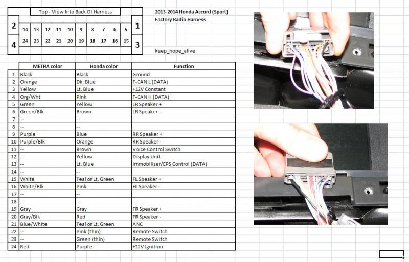

Old Aug 2, 2015 | 08:16 PM
keep_hope_alive's Avatar
Joined: Dec 2009
Posts: 3,279
From: Quad Cities, IL
you'll also note that the radio harness was missing wires. this table identifies each wire and what the Metra harness lacks.
