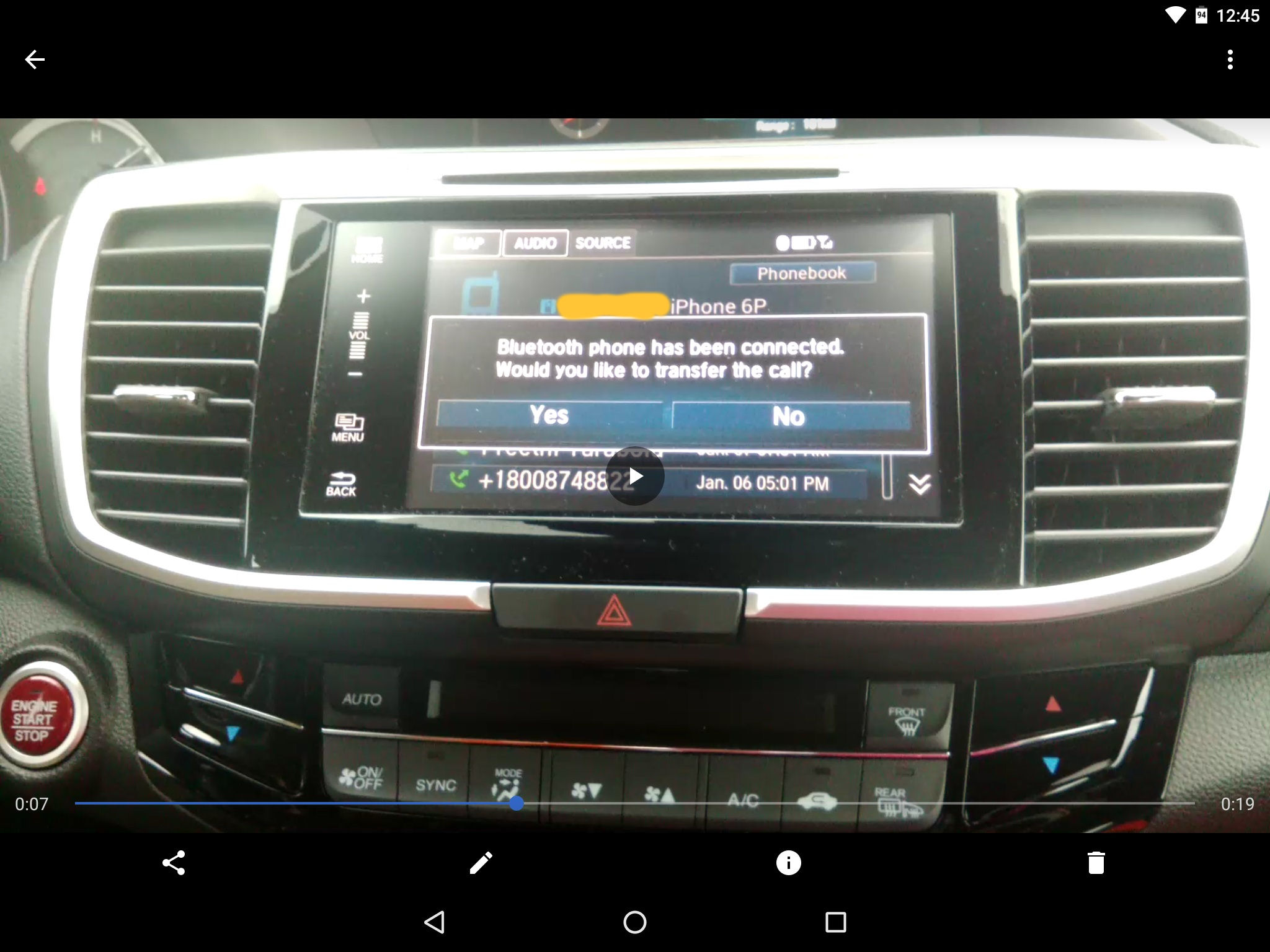

I have purchased 2016 Accord EXL recently. I am having issue transferring Hangout calls from IPhone 6 Plus to Car. After placing call from Hangout and try to transfer call to Car, system prompting a message "Bluetooth phone has been connected. Would you like to transfer the call?" with Yes/No option, but message disappearing quickly before making the choice (I have to recorded the video to see the message).

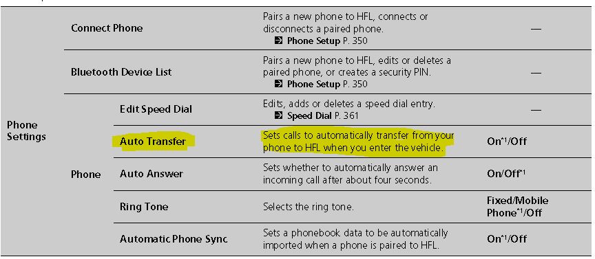

I went to dealer and tried the same on the 2016 Accord LX and noticed the there is an option in phone setting to Auto Transfer option selected to Yes.
When I turned that off it is behaving similar to EXL model.

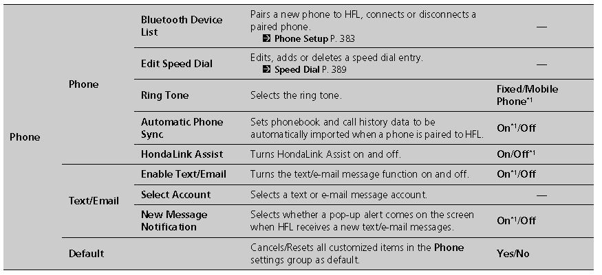

I have compared the Owners Manual for LX (Page 312) and EXL (Page 336) under Phone Settings, Auto Transfer option is not available in EXL model.
I will appreciate if you any one have any thoughts on setting the Auto Transfer option to Yes in EXL.

the touch screen is made by Alpine and the non-touch screen is made by Pioneer. They are totally different radios which is why you will see differences between them.

There is no difference in behavior, whether I start car during the call or initiate the call while car already running. For regular phone calls system prompts with Yes/No and I can choose and transfer the call. But for Hangouts it is prompting but not letting me to choose the option Yes.
