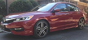

Hello HAF! I'm new to the site as well as the new owner of a 2017 Honda Accord Sport SE. See picture below. I'll go ahead and say it has the 4 speaker system which is pretty bad considering what I'm used to. Hopefully this thread will allow me to answer all of my questions.
