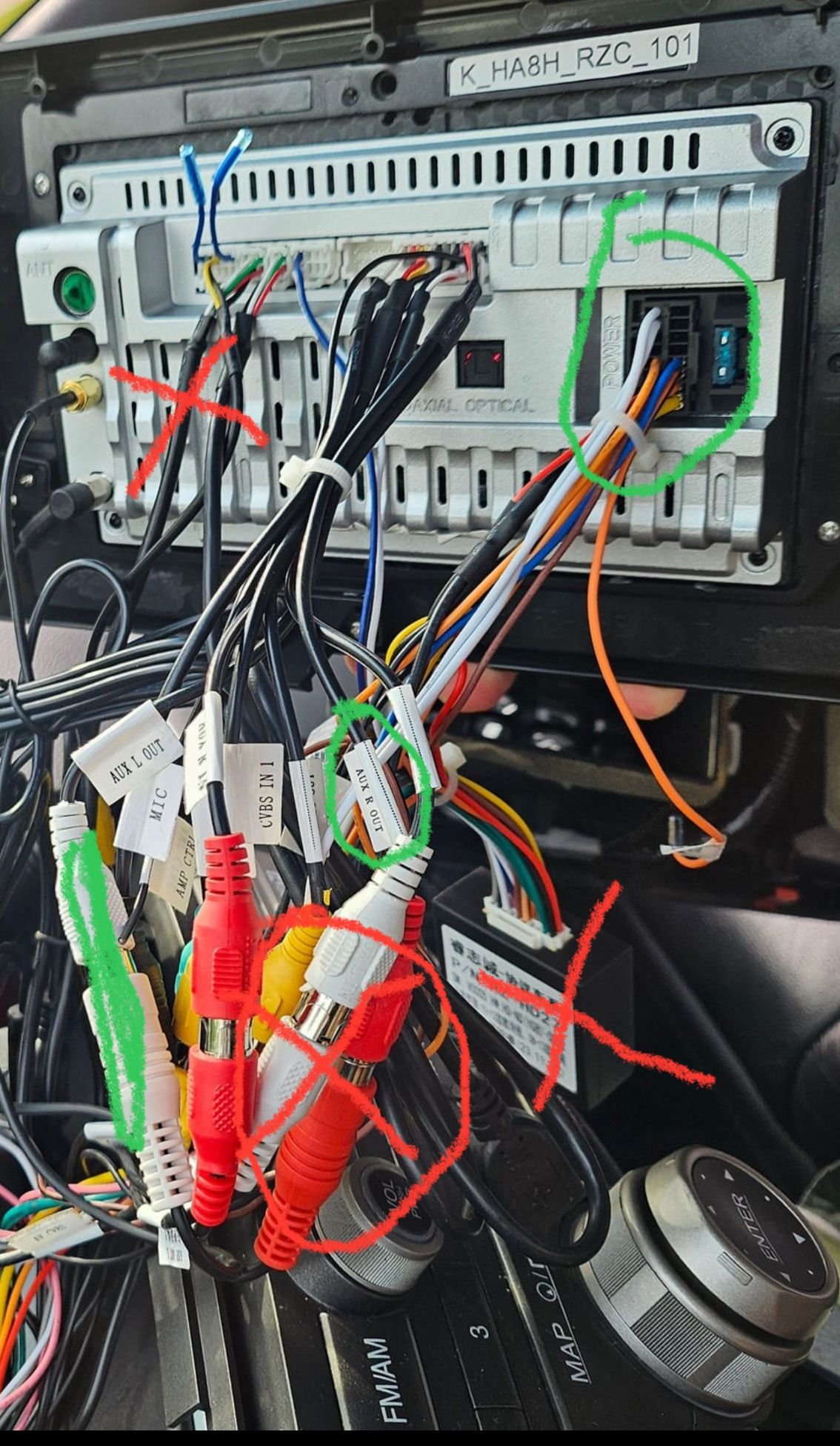

for the sake of testing only connect the connectors shown below to your old and new head units + Aux cable between your new headunit and middle console, do not connect other connectors to the old head or new head units.
completely disconnect your can bus adapter and leave it outside the car.
if it doesn’t work then send me a closer photo of your connector, that looks like mine.
I was able to zoom into photos and I have marked the required connectors in green. Don’t plug anything else.
in the picture below, I see lots of RCA connectors, you only need “Aux L Out” and “Aux R Out” for your RCA to 3.5mm audio cable. Please ensure that you don’t connect anything to the remaining RCA cables.
I have also put a Red Cross on CAN bus box. Please completely disconnect the can bus box and leave it outside your car.
