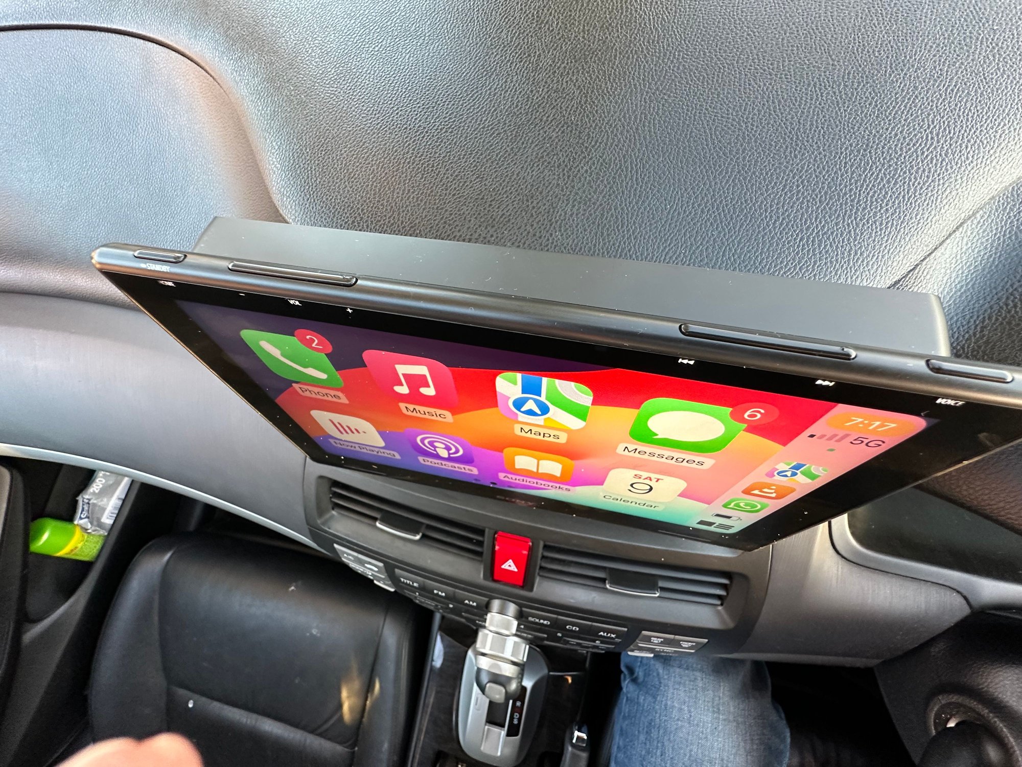

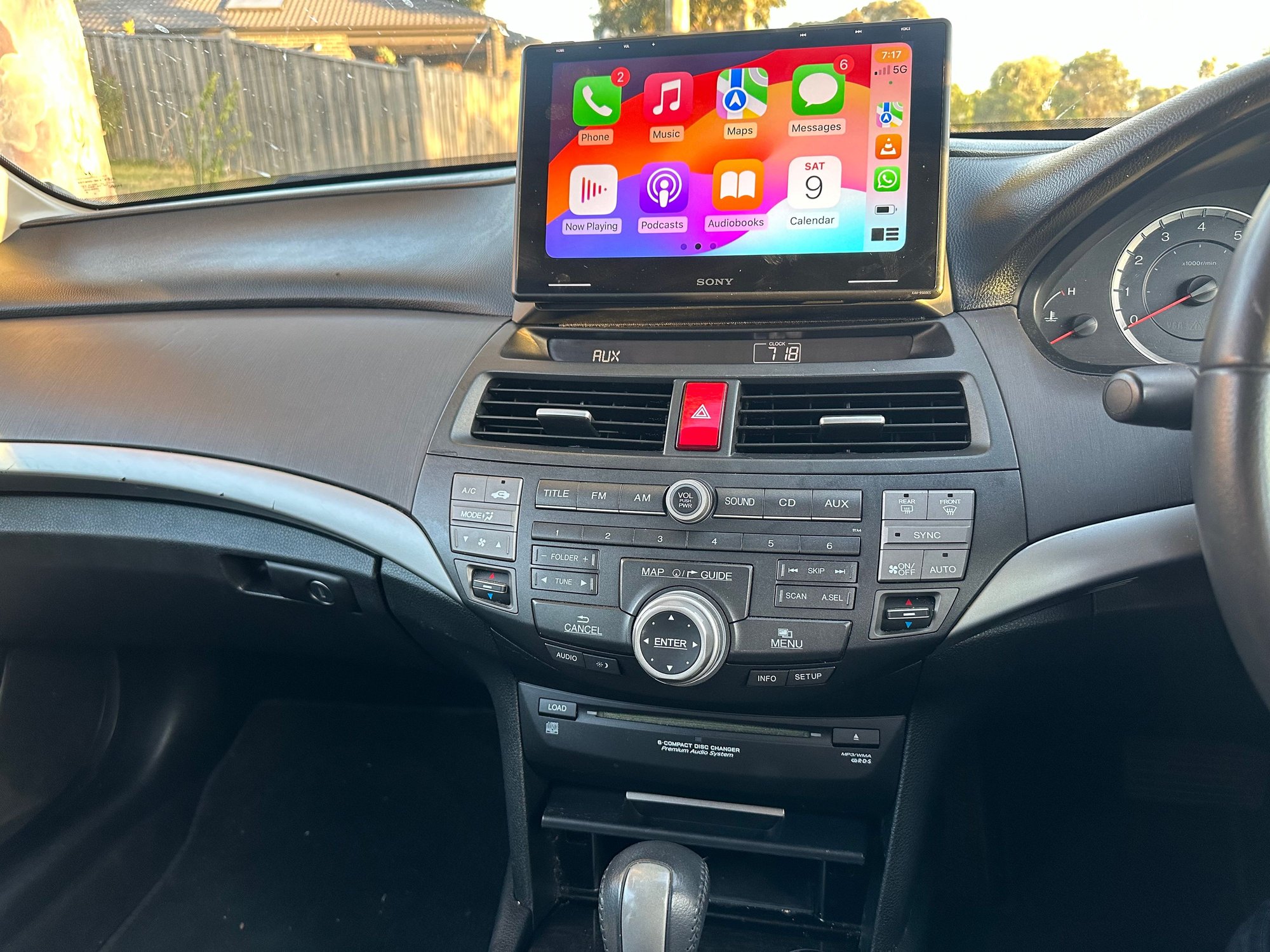

Default Finally got the headunit installed and got factory camera working with Sony headunit.
Originally Posted by Ash
Guys, can you please advise that after replacing the factory radio, does the small display above vents show climate control settings?
I think that it will loose clock and volume. I am not certain about climate control displays like temp, vents settings, etc.

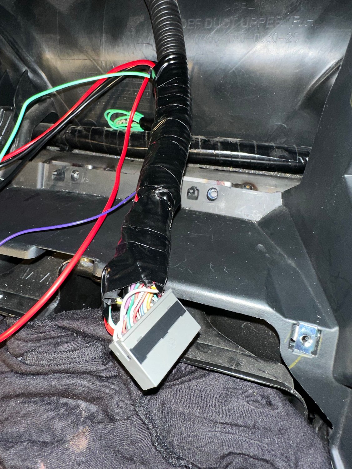

Got the headunit installed, took me almost a week(part time) to get it all going,
Connected the headunit to auxiliary input of factory amp, in the middle glovebox. I was lazy as I didn’t want to remove the factory radio
There is a small gap between the LCD and facial. I had to make custom mounting brackets to hold the headunit as the facial clips were too weak.
Factory connector for GPS display. Disconnected the display and used the signals (power, ignition, light and factory backup camera from the connector)
Wiring ready for headunit connection
Backup camera wiring is on the connector that connects to factory display on the top middle part of the dashboard.
Disconnect the connector from display and leave it disconnected l, if you plan to use factory camera with your headunit.
Camera works on 8VDC, here are the pins that require power connections,
27(Red) = 0 V, 26 (green) = 8V, 11 (Gray) = 0V.
For Camera video signal a RCA connector has to be soldered to following ,
13 (white) = + ve video signal
12 (black) = -ve video signal.
Verify video signal on a cheap display, as wrong wiring can damage your headunit.
This is how I got mine working. Your’s might be bit different to mine.

You need to buy a 3.5mm to RCA cable. Connect one side to front Audio Left and Front Audio right RCA on your head unit. Connect other side of the cable to Aux input pin, see picture below,
Then select Aux from your factory radio. It should fix your issue.
