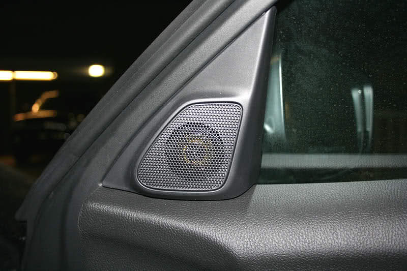

-most threads talk about replacing their sail panels with the EX or higher trims in order to mount the tweeters, however the 8th gen seems to have a different design
-does anyone have any experience with mounting these or similar sized tweeters within the existing tweeter speaker plate?

1. I dont know much about those speakers. Polk are a decent brand. Generally adding tweeters to stock locations is fairly easy, but it almost always requires minor cutting and some glue.
