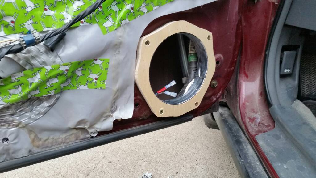

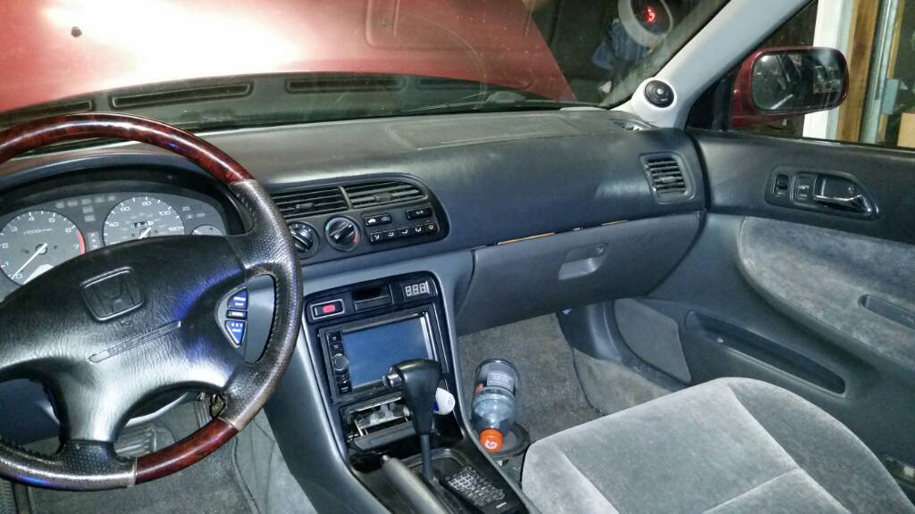

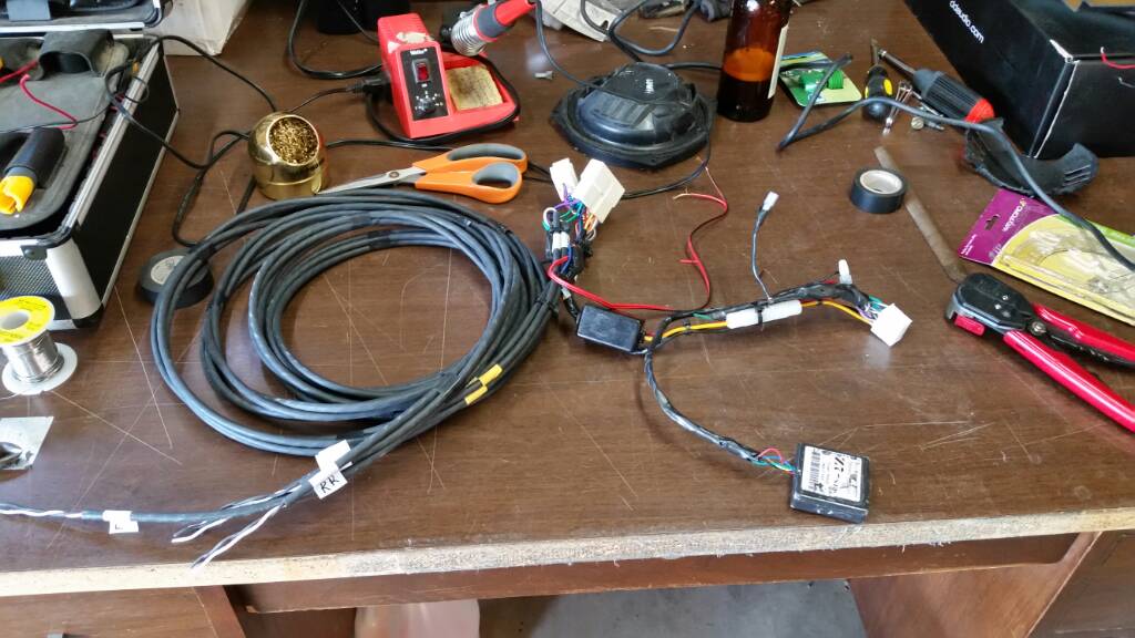

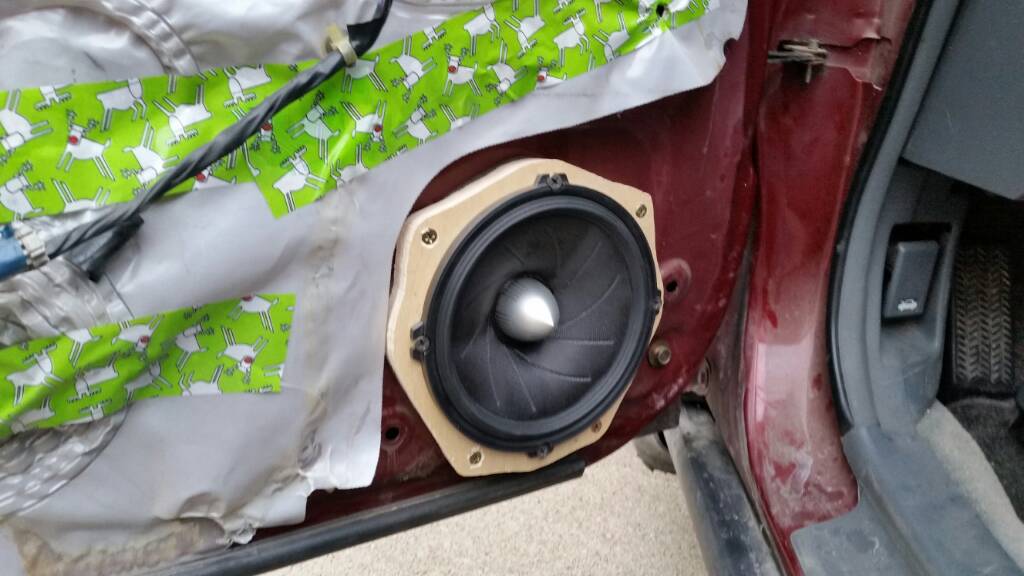

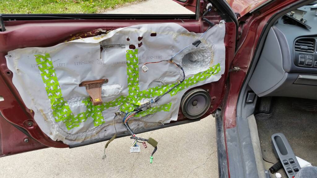

Some work i did last month on a 1997 Accord Wagon. 6.5" speakers all around.

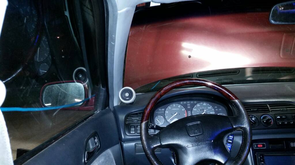

These are Alpine SWX-17Pro. You can use the stock tweeter location if the tweeters are small enough and you want to fabricate a mounting method.
