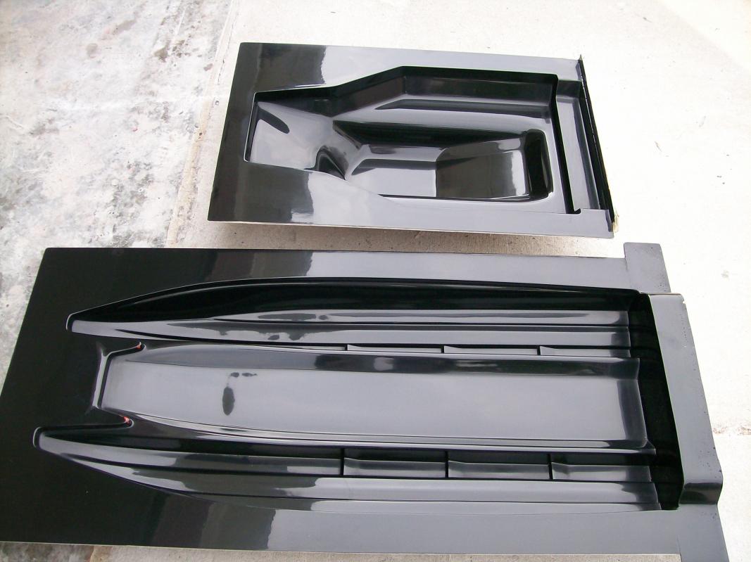

Here are the new molds for the cat all polished and ready to go. They are made from vinyl ester resin. Vinyl ester is a premium fiberglass resin with a lot of the properties of epoxy and almost as expensive. It makes a good strong mold that stays straight over the years.

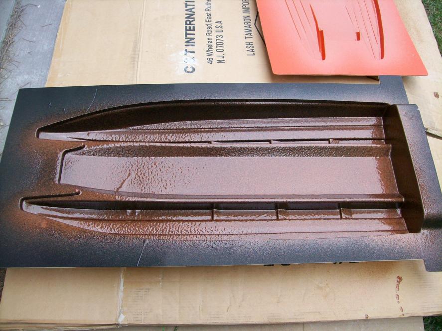

Here I am spraying in the gelcoat. This is a orange metal flake. The first step is to spray in a coat of clear gelcoat,then let it harden up. Secong step is to mix up more clear and add the metal flake,then let that harden. The last step is to spray in a back up color because you dont get a total hide from the mETAL FLAKES.

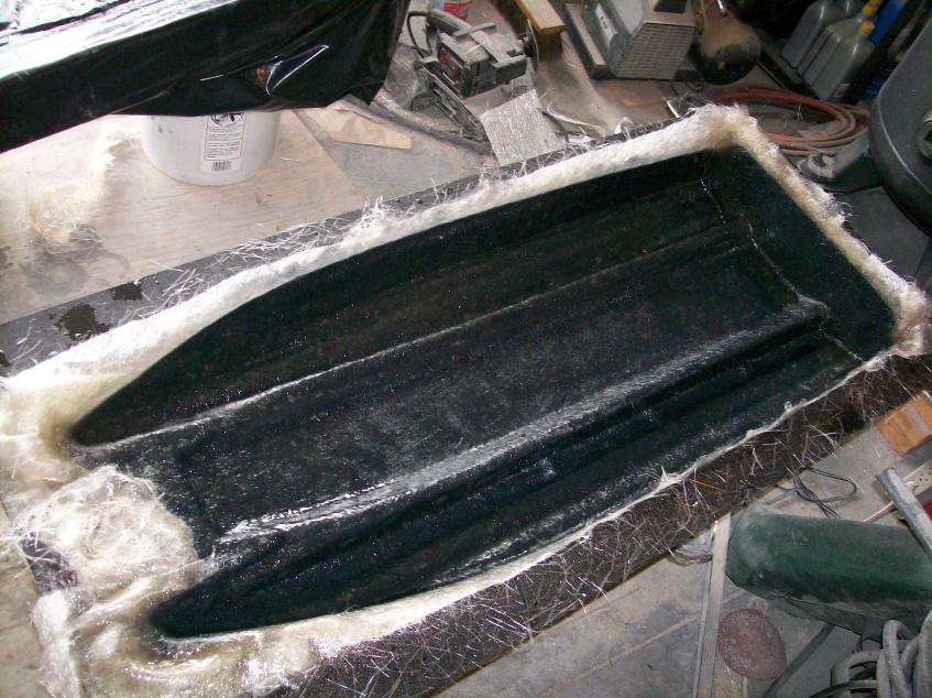

After the multiple coats of gelcoat I am finally laying up the molds. Here is the hull with the first coat of 3/4 ounce mat. This is called a skin coat and I let it harden overnight before adding more layers. This first coat is the most inportant and getting rid of ALL air bubbles it critical.

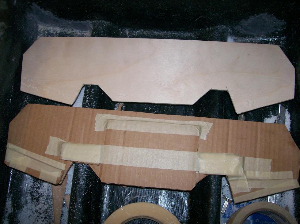

Here I am making a template for the transom brace. I bought some aircraft quality multi ply 1/4 plywood. I am finally happy with the fit. The stringers are simple. They will be 2.5 inches tall by 24 inches long tapering at the end. The lower corners cut back to allow water to pass.

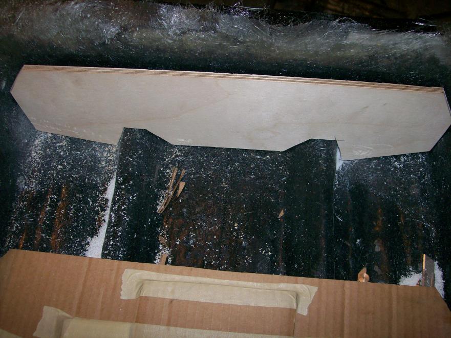

Here is how the wood fits. It will be glassed in later. Im more concerned with the fitment of the canopy and deck to the hull before I glass in the wood. Im not sure I like the deck and may have to make a new one. I like the canopy because its huge and aerodynamic. It allows great access to the inside of the hull for repairs.

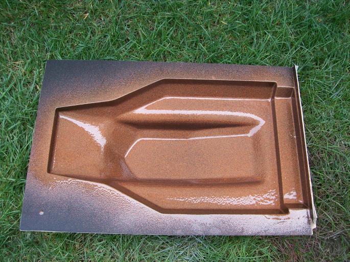

Canopy looks like a race car. In this picture it still needs the black gelcoat back up coat. Im also not sure how this canopy mounts. I didnt build these plugs so Im figuring it out as I go. I got the plugs already done but in need of extensive repair. I then made the black molds from the plugs. I am thinking a new better aerodynamic deck is needed. I dont like the fitment of the deck to hull or I would use it as is. Major overhang,not well planned at all. The hull and canopy however are beautiful. I just would have to sculpt a new deck and mine would fit perfect like my other 2 piece molds. I am looking at other cats for ideas and if I make one it will look like its going 80MPH sitting still. Also getting ideas as to how to route the exhaust etc etc. I have a stainless tuned pipe on the way.
