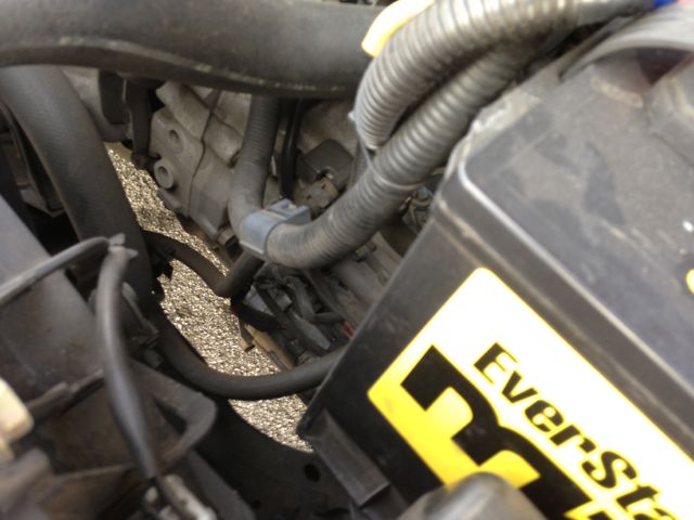

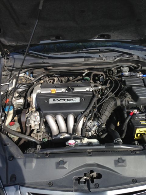

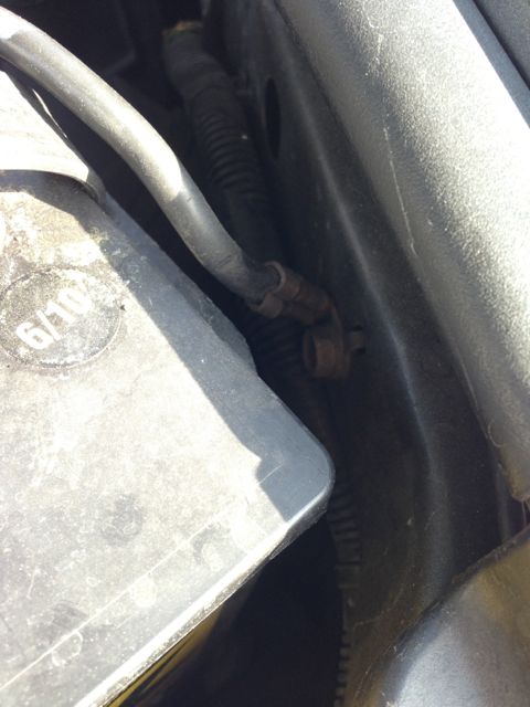

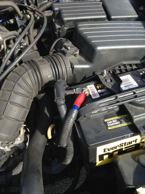

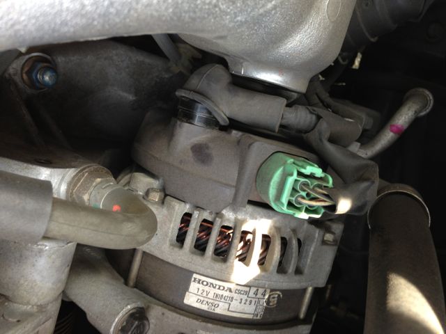

When I was checking out the wiring for the big 3, I noticed a small problem. The wire from the alternator to the pos terminal goes under the manifold rather than around. I attached a picture. Is it possible for me to attach the wire and make it go around the manifold, in front of the radiator. and is the stock negative ground fine? (in attached pictures). Also where would I go from the block to the ground?

https://www.hondaaccordforum.com/for...g-32622/page6/
this thread includes pics of the big 3 and how to route the wire separately. yes, i route above the fan shroud.
elec tape is an old school trick that has always worked.
