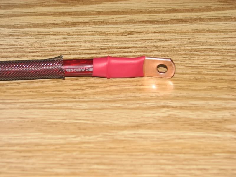

Hey there, new to the auto world and trying to fix up my car. I drive a 98' honda accord LX 2.3 automatic. I was having "alternator" problems and went to figure out the problem and had to replace the terminal end(it was so corroded that it actually snapped in two and the only reason the car was running was because it had the protective boot over it still,holding it together) , i saw that you used the same thing I did and reassured the connection with shrink wrap. what is the gauge for the original wire to buy the correct size shrink wrap? also, ive been having constant +battery terminal corrosion. the battery is about 2 1/2 years old, could it be the wire? battery? both? i've had the battery tested and they say its good,havent had car troubles due to the battery but i'm going on a long road trip and want it to be all set. any help would be great!! also, looking into doing some new stuff on my car,any suggestions? almost everything else is currently stock.

the stock cable is about 6awg. size depends on if you will remove the stock ring terminal or not. i like it as close as possible. 3/8" should work.
battery terminal corrosion could be a small leak at the terminal. i assume you mean a build-up of white stuff? otherwise, copper will oxidize unless a battery terminal protectant is used.

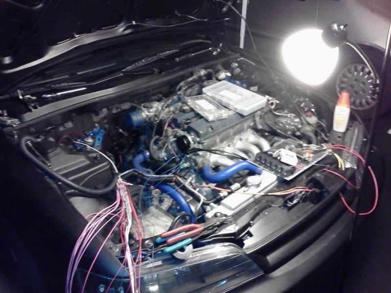

it is not uncommon for my car to draw over 100amps at idle. what experience has taught me is that for most applications simply bolting a slightly smaller pulley on the alternator will bring its output potential up enough to compensate. or it will force it to spend more time at its max potential, anyways. for my Honda, i bought an alternator, took it to cliff out at startech here in south florida, and had him build it the best he could. he got it up to 170 or 180amps and put a smaller pulley on it so it could handle the insane load it sees regularly. it now uses a Toyota plug.
a good way to see if just a smaller pulley is all you need is to probe battery with dvom with all loads on and bring rpm up to 2000 or 2500k and see if charging voltage is good. and if so then the fix is simple and cheap. and can in some cases be done on the car. another good way is with a snap-on vantage pro with low amp probe clamped around the charge cable with the battery disconnected, or the battery cable with all loads on and the engine off. and if that number is smaller than the peak output of the oem alternator then a smaller pulley is all it needs. the car is wired from the factory to handle what the alternator can put out
and i don't think the eld is anything that needs to be played with. when you connect jumper cables the engine still bogs a little from the alternator full fielding trying to maintain voltage. the alternator will still work if you connect amp at battery. or, you could eliminate it altogether with some light wiring, like i did...
