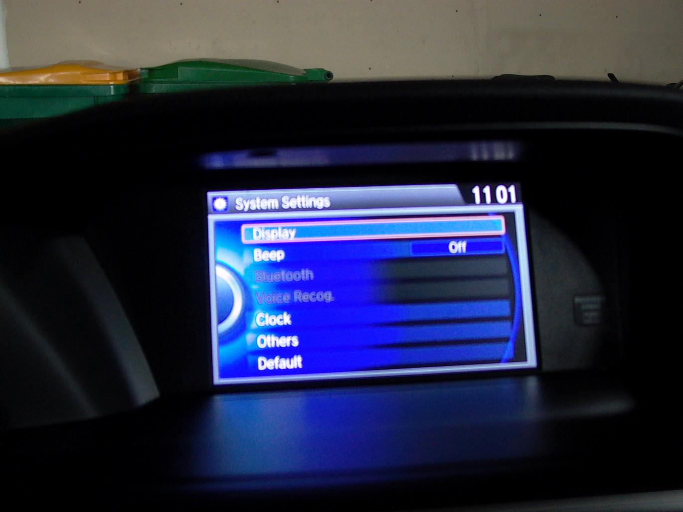

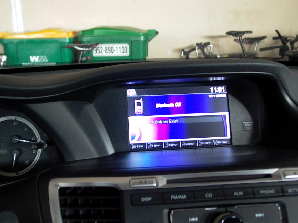

I have a 2013 Honda Accord LX with 57,000 miles, which was purchased new in November 2012. The car has been very good without any electrical or mechanical issue until a few weeks ago. I was trying to use the Bluetooth feature but the car says its Bluetooth is "OFF". I went to the "Settings" but the Bluetooth ON/OFF feature has been grayed out. The built-in Bluetooth feature was functional a few weeks ago prior to this observation.
I got the radio head unit into a diagnostic mode and it shows "B1775" but the "OK" string is missing. It should have displayed "B1775 OK". I ordered a used 2013 Bluetooth module (Honda part# 39770-T2A-A81) from eBay and just waiting for it to arrive. I will post once I get the replacement unit installed and whether the issue is related to a non-functional Bluetooth module. I thought the Bluetooth modules are fairly robust. Hopefully the Bluetooth module is plug-n-play with the head unit and no additional programming is required.

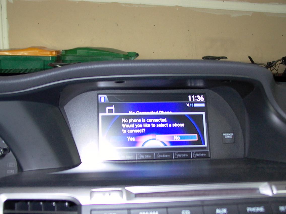

I got a replacement Bluetooth module this morning. It was a simple plug-n-play and no programming required. The Bluetooth is now fully functional and can be turned ON/OFF via "Settings". The Bluetooth from the eBay was only $55 compared to $214 from the Honda dealer.
