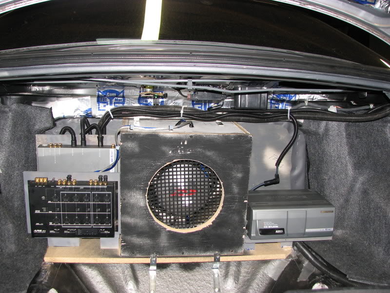

you could fit it behind the rear seat - sealed off in the opening with the enclosure under the rear deck. you'll have to make the enclosure clear the torsion bars, but it could be inserted from inside the car - just remove the rear seat and the rear support bars (replace support bars when finished). just line it up with the rear seat opening and face the sub forward. make sure to seal it off on the sides to concentrate the pressure in the cabin. note: this will also eliminate trunk rattle.
if this 12 can fit, a 15 can fit:

even some decent speakers in factory locations are a huge improvement over factory. trust me on that - it's worth the effort.

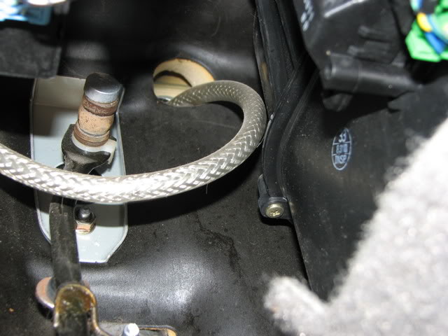

there is a grommet here, the power wire was loomed and secured after this pic was taken. don't leave your wire loose like this and drive it.

Ok, that's definitely a lot more help, haha. Could you give me a couple reference points though? Like what the thing on the right side of the picture is and/or which side is driver's, etc.?

driver's side only - the passenger size has the blower motor and HVAC and you don't have access. the driver's side has a huge cavity up under the dash. enough to fit a 10" sub in a fiberglass enclosure.
in the pic, you can see the gas pedal linkage just left and low of the penetration.
