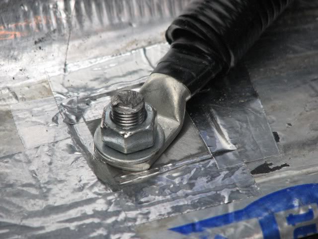

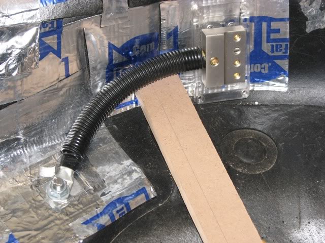

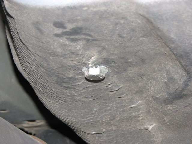

my 1/0 ground
I removed a section of sound deadening (using a Goo remover and masking with aluminum tape)
this was the step by step
1. identify a location with access on both sides, at the thickest steel of the trunk floor. make sure to stay away from suspension, fuel tank, wiring, etc.
2. mask off a small rectangle where the ground ring terminal will go.
3. sand down all paint until shiny metal is exposed. use a sand wheel on an electric drill to speed the process. sanding by hand takes a while.
4. choose a bolt that is of appropriate length, and size for the ring terminal. make sure it is either zinc or stainless steel so it won't rust.
5. drill a hole just larger than the bolt size.
6. insert and tighten the bolt and the ring terminal. keep the nut and exposed threads on the inside.
7. use silicone to seal around the exposed bolt head.
