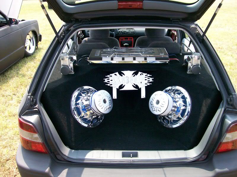

I'm not much help, I got rid of my cargo area
course, this is all changing to something simple soon anyway. lol

LOL Those are audiobahn subs aren't they? No comment...

yup, they rocked when I had em. sold them to buy rims

Yes I'm sure they made a whole lot of noise...

Well that is one use of the space!
But yes, might be a bit over the top for what I want.
Could you do a similar set up with less chrome?

Don't let that setup fool you, audiobahn subs are sub par to say the least. Mounting the subs inverted is all about show, and the only subs crappy enough to embellish their baskets like that are audibahns. Inverted subs decrease output slightly, you risk getting debris and dust into the voice coil, the sub is designed to seal on the back edge so you have to make a way for the sub to seal properly, and not all subs function properly inverted. If your trying to save space the last thing you would want to do is mount them inverted. When you start trying to show off with audio equipment, your only going to degrade your sound. This guy doesn't sound too young, how a set up like that even interests him is above me. Audiobahn subs are about the muddiest, sloppiest, and worse built subs you can buy, and that's not an opinion.

Yup, you're exactly correct. I sure don't know alot about audio, hell I didn't even hook all that stuff up. And you're also correct, I'm an old dude by todays import modding standards. I could give two ****s if they were so loud my windows cracked. If you'd take two seconds to stop criticising something and look at my ride, you'd KNOW it is being built as a SHOW car. Hence the reason the subs are mounted inverted to show off the chrome and flames. They hit hard, sounded great, and did the job. I also got the entire setup for cheap, which since I am also a family man, helps out alot. I KNOW it's not what he is looking for, I was just posting to keep the thread interesting. Oh, and lastly, I'm building this car for me, so if I want to mount them inverted on the hood, I will.
