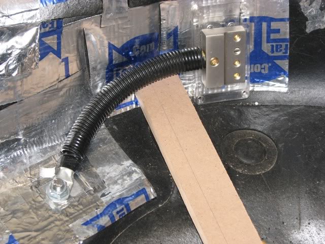

the issue with the factory ground points are they are on vertical metal pieces that are tack welded in place. you want the floor because it has better welds from front to back.

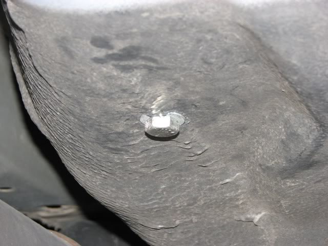

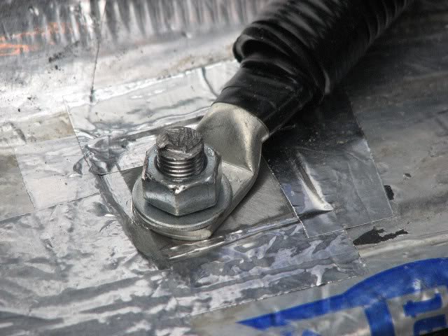

simply mask off a small square the size of the ring terminal(s). sand away all paint to expose shiny metal. then remove the tape and drill a hole in the middle (check underneath for access first). then use a 1/4-20 or similar bolt and nut (nut and threads inside the car). lastly , silicone over the exposed bolt head under the car.

Attached Thumbnails Gound Points-accordtrunk0809011.jpg   Gound Points-accordtrunk0809013.jpg   Gound Points-accordtrunk0809010.jpg
