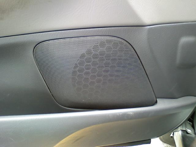

kk couple questions. if i get these http://www.crutchfield.com/p_1086022...i.html?o=p&c=3 speakers, how would i install them. is it easy to install it, if no if i take it to a pro, how much will it be to get it professionally install it. and since Honda's front speakers look like this (picture below) that rhombus shape cover would stay there or what? because the speakers have their own covers and i really dont care if it does stay like that, i just care about the quality.

don't get those speakers, or any coaxial speakers. get component speakers. your factory system has tweeters in the dash - that is where you'll locate the new component tweeters. like these:
http://www.crutchfield.com/p_1086030...eference&ssi=0
the factory grill stays put. you just make or buy a mounting adapter and use weatherstripping foam (closed cell) around the new speaker to seal against the factory grill.
