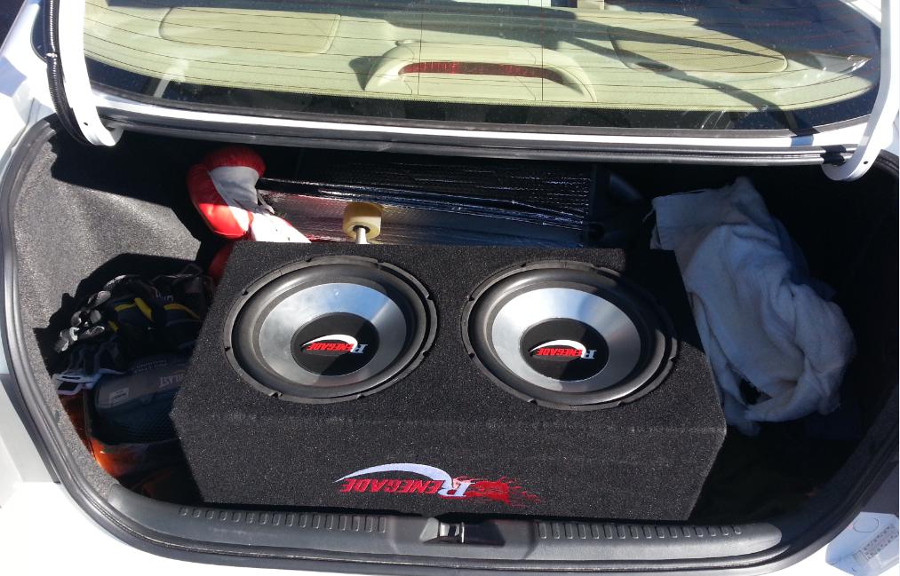

I got dual Renegade 12s 800w rms 1200w peak (ported) for $40 used from a guy, in great condition practically brand new, except the positive terminal snapped, which I can easily replace.

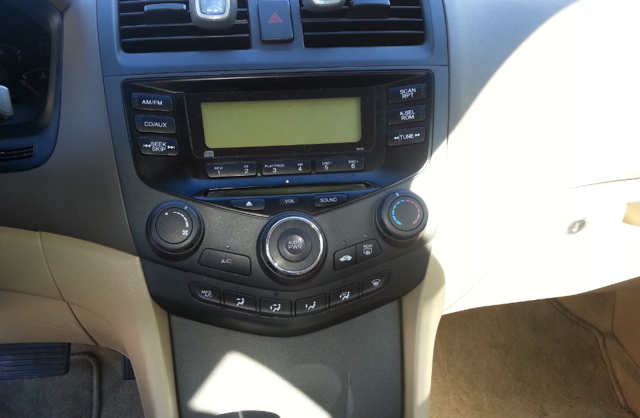

Anyway, I don't think my stock Head Unit has RCA outputs in the back, which means I'd either need a converter or an aftermarket Unit/faceplate. I'm heading towards the faceplate and head unit, but I'm unsure which I should get. Could anybody link me to some good choices?

Pic of my head unit

Pic of my subs

This dash kit will let you slap a single DIN CD player in the lower storage cubby area. This will be a better option as the kits that replace your AC controls is cheap and doesnt last long. Which CD player is a matter of personal preference. Shop around and get the one that you can afford with the features you like. As long as you buy a name brand like Alpine, Pioneer or Kenwood, youll be fine.

I agree a new head unit is your best bet. If you decide to get a LOC, I recommend this one:
N-RHL2 - BEST LOC IN THE WORLD!! - $24.95 : Zen Cart!, The Art of E-commerce
Old Jan 14, 2013 | 10:09 PM
keep_hope_alive's Avatar
Joined: Dec 2009
Posts: 3,279
From: Quad Cities, IL
here are some instructions for a replacement dash kit:
http://www.metraonline.com/files/pro...9-7864_web.pdf
and instructions for the lower pocket kit:
http://www.metraonline.com/files/pro...NST99-7862.pdf
you can't just remove the rear panel cover, below that is sheet metal. you can remove the rear speakers to let more bass through - it works well. the rear woofers are just for lows anyway (no tweeters). any speaker upgrades should be to the front 6.5" components.

And for your audio hookup, if you havent, remove the factory stereo and peek at the back for rear out RCAs. It looks like a nicer stereo but may have security so watch out if you replace it and look for how to remove the security crap on it
