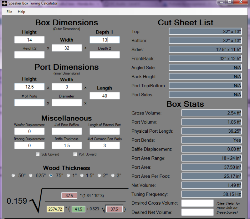

I know this is not what jl specs call for, but if you arent happy try this.
