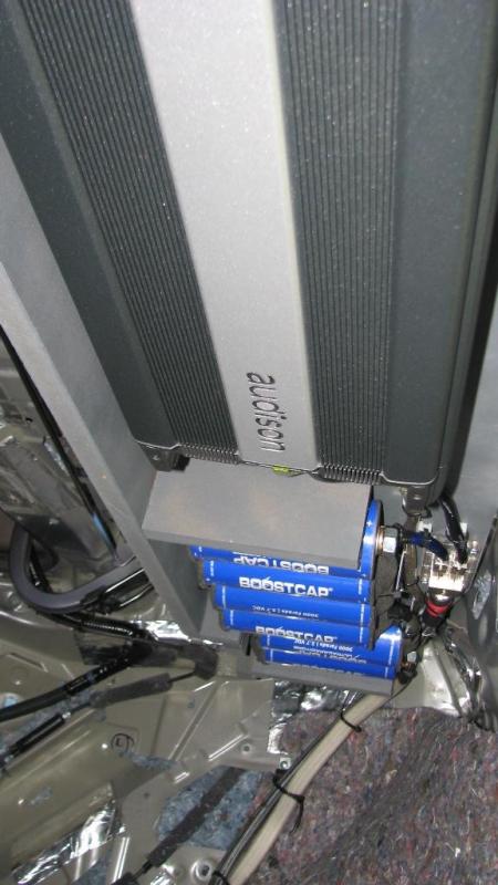

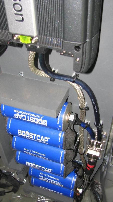

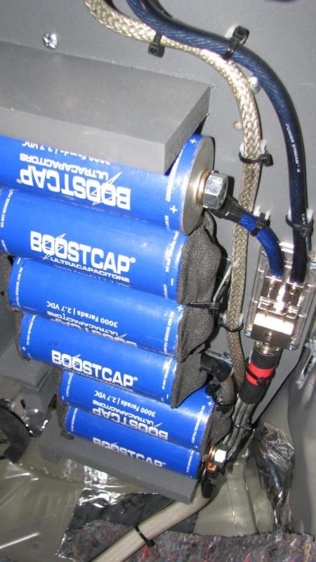

got a wide 1/0 cable that needed 3/0 copper terminals that i flattened/crimped in a vice then dented with a ballpeen hammer then covered in heat shrink.
sanded the floor and used a Grade 8 bolt and nut.
terminated the ground at the ultracap then continued to the amp.
power and ground is 4awg on the amp rack and will be fused at 100A. a 100A fuse will be on the ultracap feed also and using a MAXI holder allows for a quick disconnect.
i did some measuring last night to look for a good ground. used 2 awg to get from the battery negative back to the trunk and included test lead resistance. my fluke measured 0.2-0.3 ohms. testing various grounding locations, including where i chose, i did not get a measurable difference of more than 0.1 ohms. given the tolerance of the meter, that's pretty good.
i've located the factory grounds and engine bonding jumpers. they will be upgraded soon.

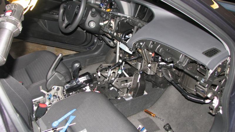

the head unit testing has convinced me to put the 9887 in.
so i removed the pocket, cut it up, and am now prepping it
cover removed
mockup
cutting
putting the sleeve in
starting the fill process
empty dash

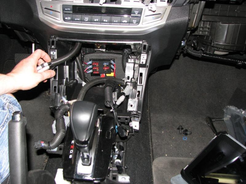

spent the weekend working on adding the CDA-9887.
more work on the mount - some bondo fill
not sure i like this color and there are still some imperfections that i need to sand out
but i had to button the car up for a trip on Monday so this is where it is right now
these head units need some sort of trim ring but i suspect only three sides of the trim ring will actually fit. there is more work to be done but removing the deck isn't that difficult.

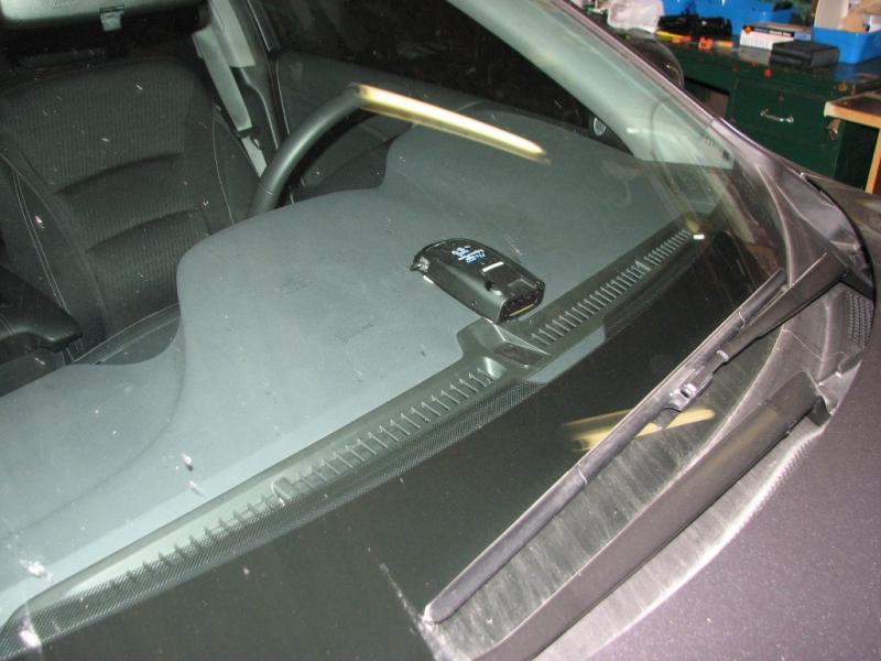

a lot of time was spent wiring new power distribution. i use a relay powered by the head unit 12V ignition feed to generate a new switched ignition source. i added a fuse block with separate outputs for the radar detector, GPS, PAC SWI-JACK, Navone LOC, and the 9887

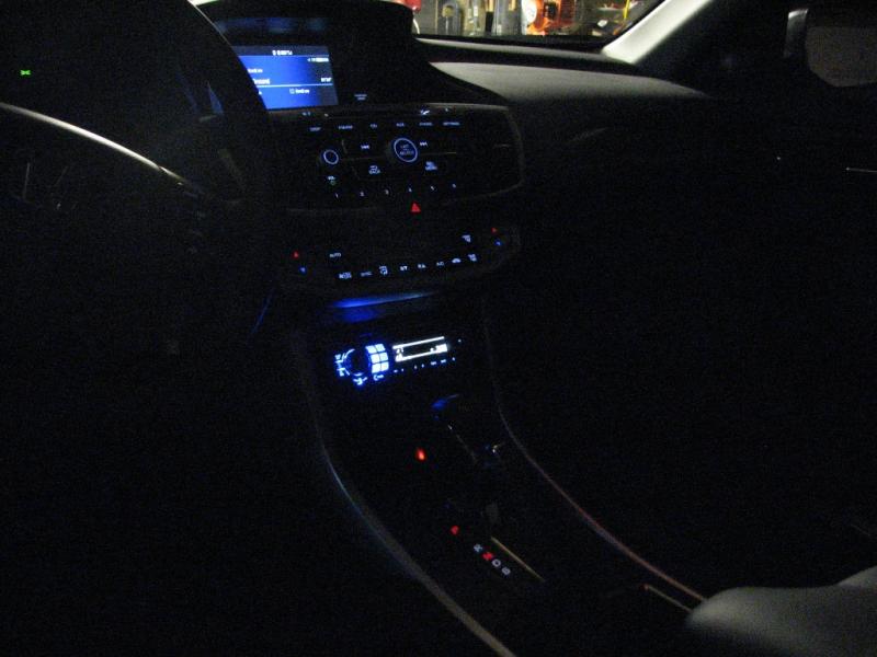

well boys and girls, we have power.
i'm still not happy with the HU mount. despite more sanding and fill there are still some imperfections. and i went with a satin black that is still too glossy for the dash. so i got a can of flat black for the next time i pull it out.
i modified the cover for the factory pocket to make a removable cover for the HU to make it look like stock when parked. the cover has a CCF backing and neo magnets glued to it behind foam. two more magnets inside the mount provide plenty of holding power.
amp is wired and powered.
the crossovers are left over from when the comps were powered from the deck. they can be removed and repackaged now.
did some scope testing with each output and also the AUX in from the factory output and LOC. no clipping at full volume on the Alpine (typical). HU output clips the Alpine AUX in at volume 21 out of 40 - overdrives the input. The stock deck clips at volume 33 of 40.

GPS and radar detector wires hidden

illumination looks pretty good

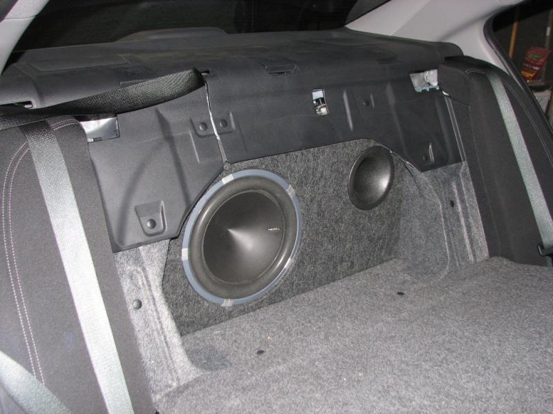

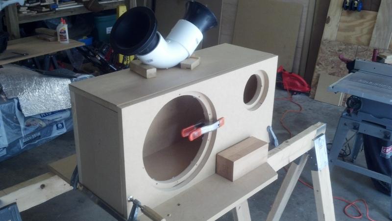

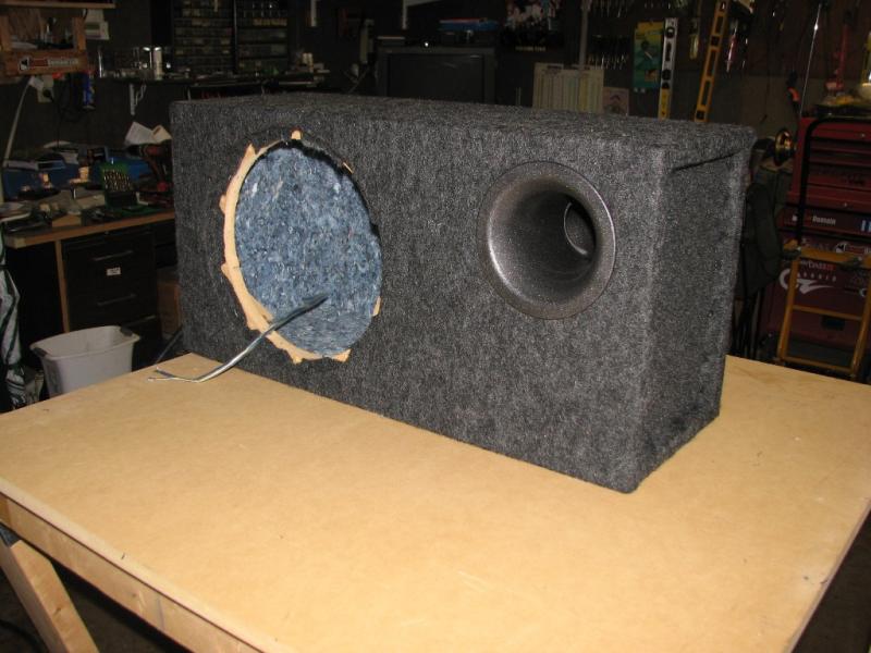

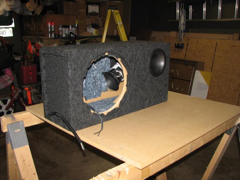

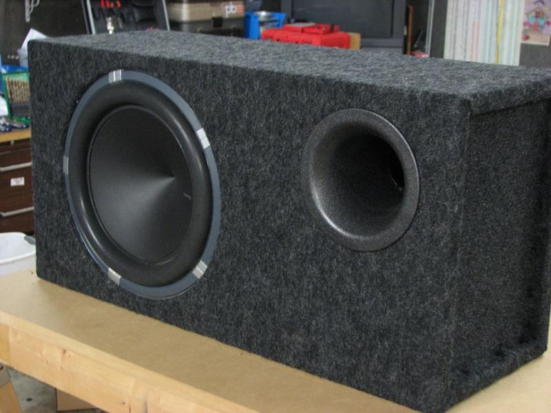

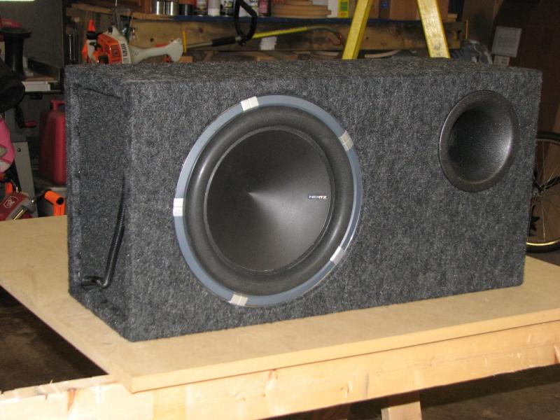

got a sub box built for the Hertz ML3000. intent is for this to be a temporary box for a few months.
