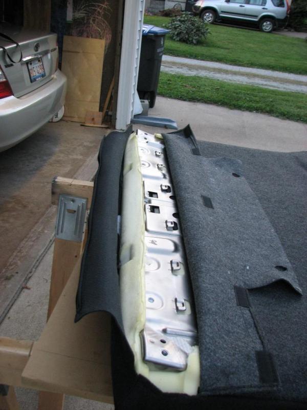

the factory rear seat has a hard plastic cover behind the armrest and a solid metal backing. i've noticed SUBSTANTIAL bass reduction with the seat up vs. down. in all of my cars, i make the rear arm rest a pass through for bass. this car is no exception.
luckily, Honda built this car to be re-upholstered with minimal effort. fabric just clips in place. pretty nice.
two 12mm bolts hold the rear seat in place
fabric has hard plastic lips that clip over metal tabs
the sides have interlocking plastic guides separating black from charcoal fabric, they separate easily
the plastic piece just sits in place. i lifted the bottom out then rotated to remove the top
rear metal exposed
rear metal cut with a dremel and cutting wheel
BXT II deadener to lower resonance and a layer around all sides of the opening so it's smooth and safe.
you can't see it but in the bare picture above there are some tack welds on either side of the new hole. there is a metal bar running vertically there. the rear seat metal has the ability to rattle against that bar. so i crammed some fabric between the two in three places along each (Between welds). it was audible while knocking on the metal. it is silent now.
reassembled with ease.

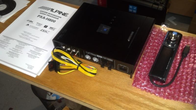

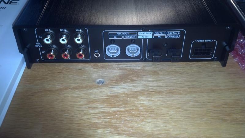

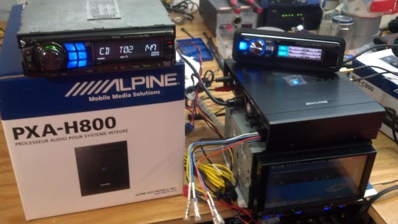

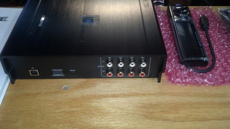

i spent some time playing with the H800. Programming required the unit not only have power but you had to "cycle ACC" or turn ignition on and off to move past various stages of programming. on my test bench, i had a way to do that thanks to consistency with how all of the devices were wired. I programmed with the laptop after upgrading the software version to match the head unit i will be using.
my first test was how to use AUX inputs. I have the Alpine DVA-9861 wired with Ai-Net and fiber optic. that's the SQ source. But I also want to wire the factory head unit in (the double-din pictured is my factory stand-in). I'm going to play with that for a while on the test bench since it's -30 with wind chill today and generally cold for the next few weeks. The inputs are very flexible. There are 6 inputs and they are paired. any of the three pairs can be high level or low level inputs. and you can set up the system for 4ch + 2ch or three different 2ch inputs. The head unit only sends two channels through Ai-Net or fiber optic.
I did get a configuration to work, one that allowed the 9861 to select AUX on the H800 so i could change between the two sources. That's pretty much what I want but there may be another idea.
