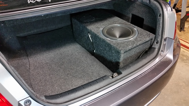

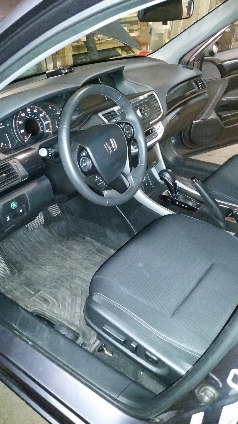

i'm still experimenting with locations

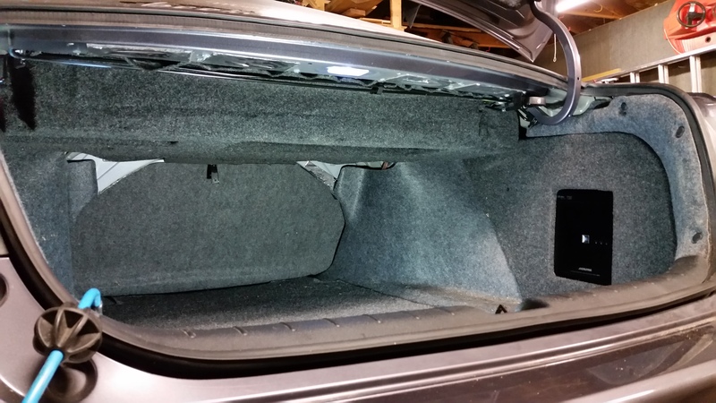

car sounds pretty good. i'm enjoying the PXA-H800 flexibility.
A sealed enclosure that is 'glassed to the driver's corner of the trunk is the next plan.

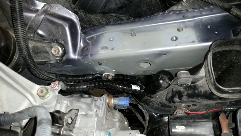

58k miles in 2 years

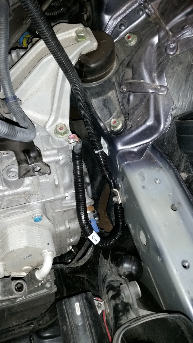

upgraded engine block and battery grounds finally
Attached Thumbnails KHA 2014 Accord Sport SQ Build-fb_img_1462407506705.jpg   KHA 2014 Accord Sport SQ Build-20160430_113857.jpg   KHA 2014 Accord Sport SQ Build-20160430_114351.jpg

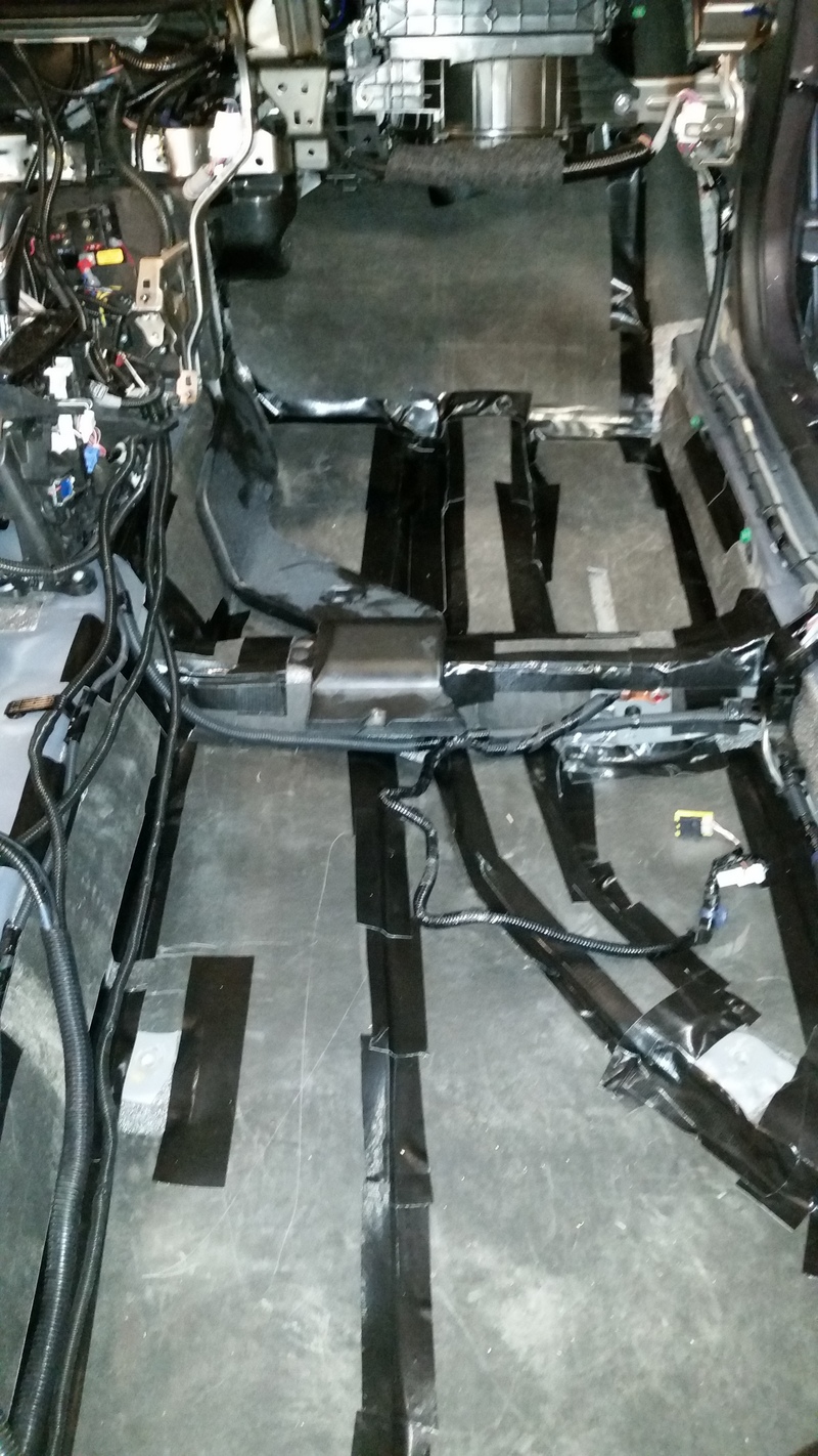

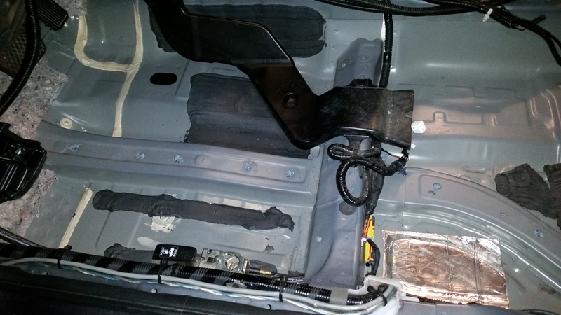

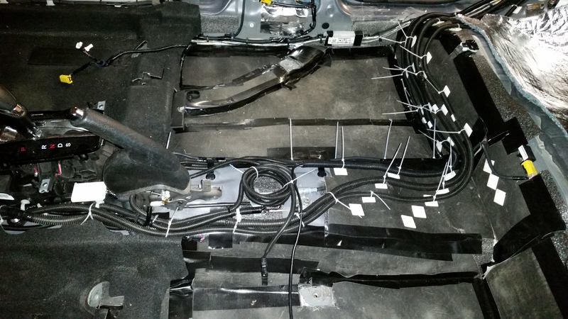

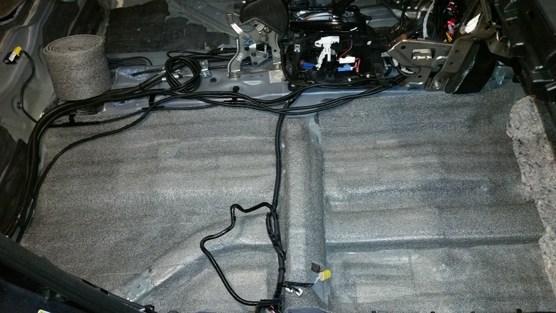

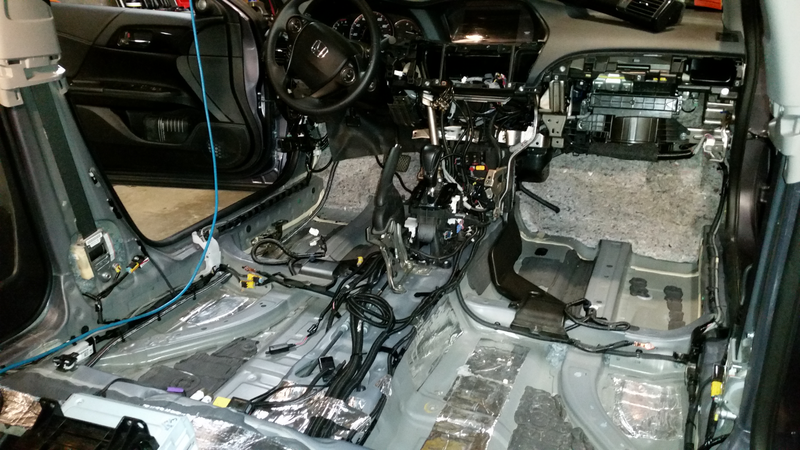

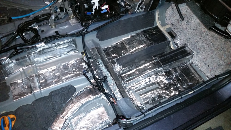

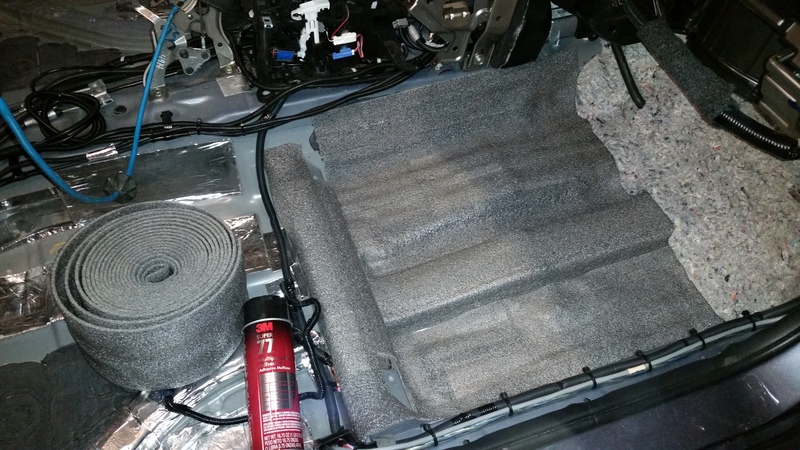

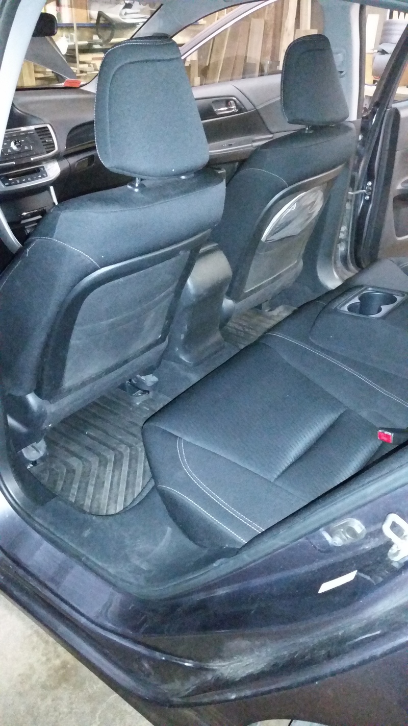

I added deadener, foam, and MLV to the flooring - huge improvement in road noise
starting
cavities stuffed with cotton sound insulation
Raammat BXT II added on the floor
CCF glued to the floor (decoupler for MLV)
MLV applied with gorilla tape on seams
wires secured with tie mounts (glued on)
reassembled
Attached Thumbnails KHA 2014 Accord Sport SQ Build-screenshot_2016-05-04-17-23-47.png   KHA 2014 Accord Sport SQ Build-20160501_104921.jpg   KHA 2014 Accord Sport SQ Build-20160501_104843.jpg   KHA 2014 Accord Sport SQ Build-20160501_112309.jpg   KHA 2014 Accord Sport SQ Build-20160501_113751.jpg
KHA 2014 Accord Sport SQ Build-20160501_202631.jpg   KHA 2014 Accord Sport SQ Build-20160504_225408.jpg   KHA 2014 Accord Sport SQ Build-20160505_022831.jpg   KHA 2014 Accord Sport SQ Build-20160505_022841.jpg

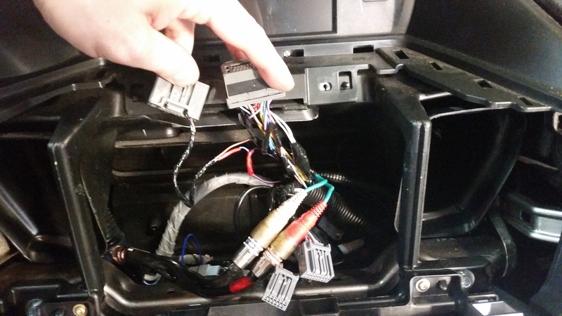

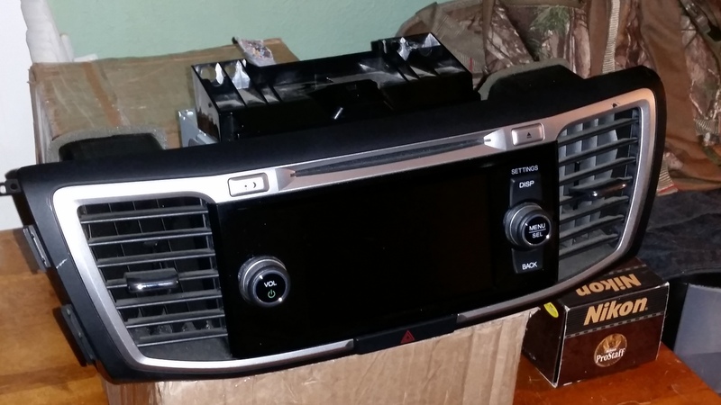

i'm super stoked about the next upgrade: swapping the stock with the premium touch screen. this will give me a clean, flat output without the internal DSP of the current stock unit... all while keeping full stock functionality with cameras and info screen.
Attached Thumbnails KHA 2014 Accord Sport SQ Build-20160526_180914.jpg   KHA 2014 Accord Sport SQ Build-20160526_180932.jpg   KHA 2014 Accord Sport SQ Build-20160526_180939.jpg

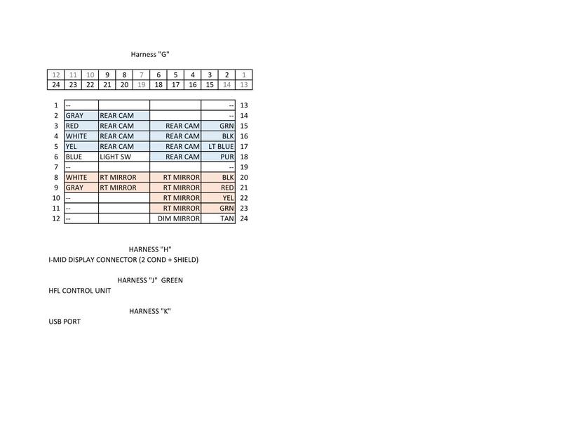

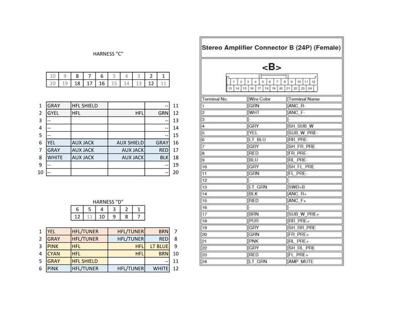

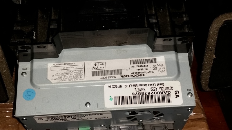

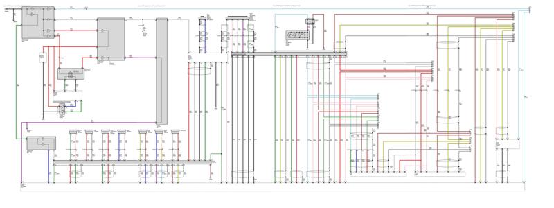

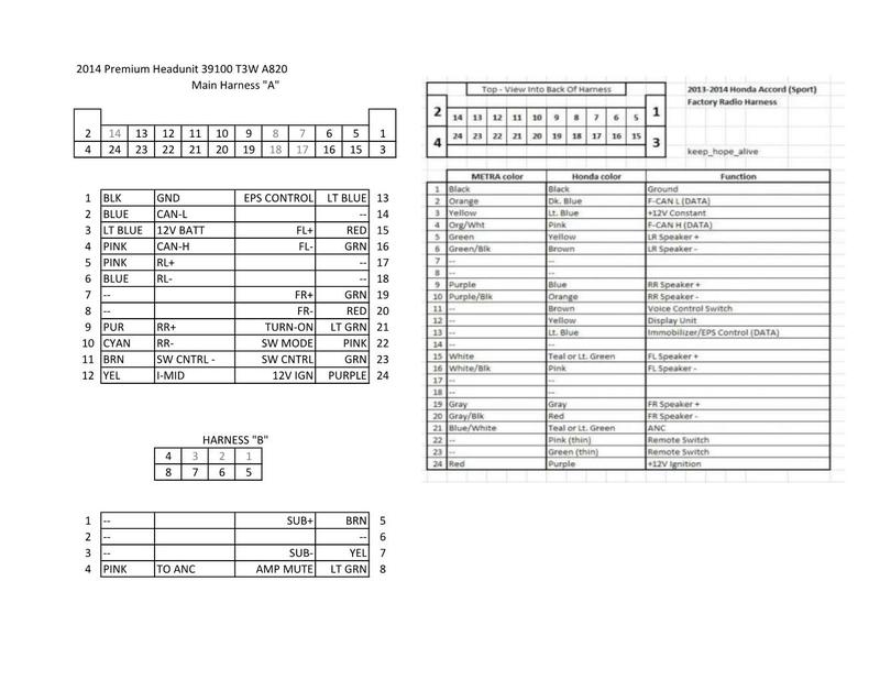

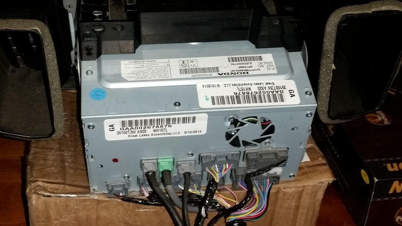

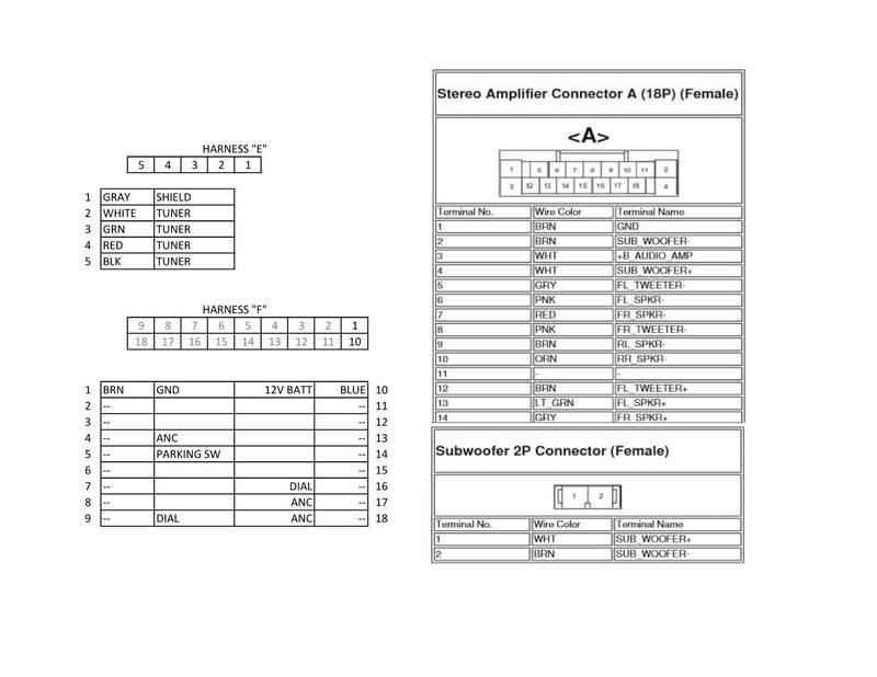

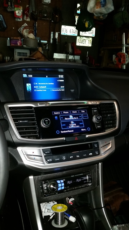

I did get the touchscreen installed recently. Sounds great - no more DSP issues. But the touchscreen units have a lot of external components (FM Tuner, HFL, XM Tuner, Amplifier, ANC, etc.).
The premium HU is from a 2015 Accord Hybrid, this is the pinout I was able to discern based on the harnesses it came with
click on link for enlarged version: http://i38.photobucket.com/albums/e1...m%20203732.jpg
Attached Thumbnails KHA 2014 Accord Sport SQ Build-20160709_165935.jpg   KHA 2014 Accord Sport SQ Build-20160709_175332.jpg   KHA 2014 Accord Sport SQ Build-hu39100t3w%2520harness%2520pinout%2520page%2520001.jpg   KHA 2014 Accord Sport SQ Build-hu39100t3w%2520harness%2520pinout%2520page%2520002.jpg   KHA 2014 Accord Sport SQ Build-hu39100t3w%2520harness%2520pinout%2520page%2520003.jpg
KHA 2014 Accord Sport SQ Build-hu39100t3w%2520harness%2520pinout%2520page%2520004.jpg   KHA 2014 Accord Sport SQ Build-2015accordpremiumhudiagram%2520203732.jpg

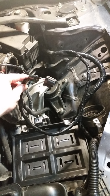

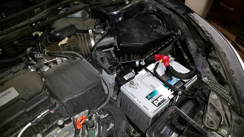

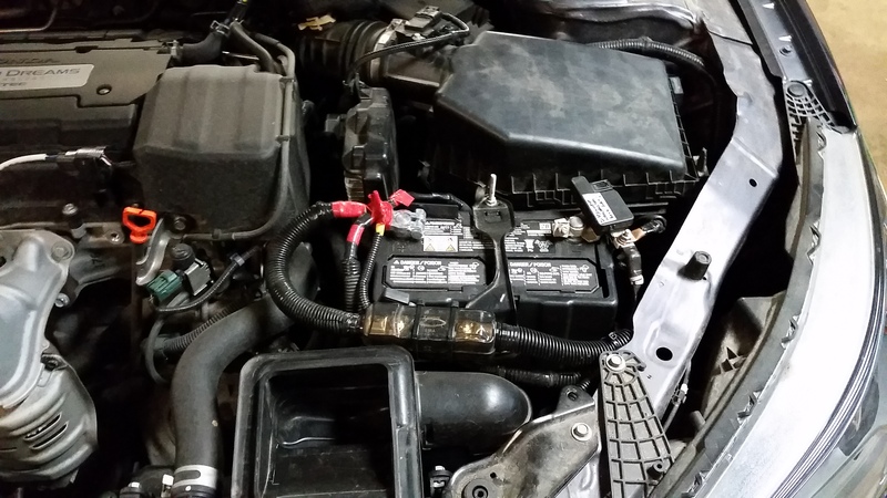

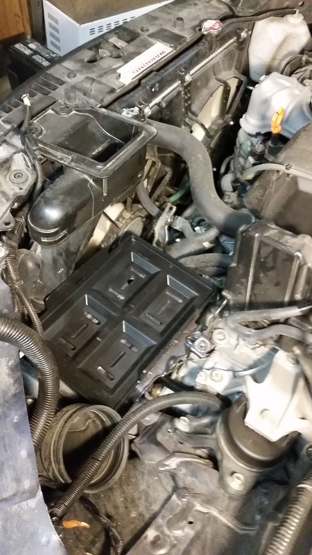

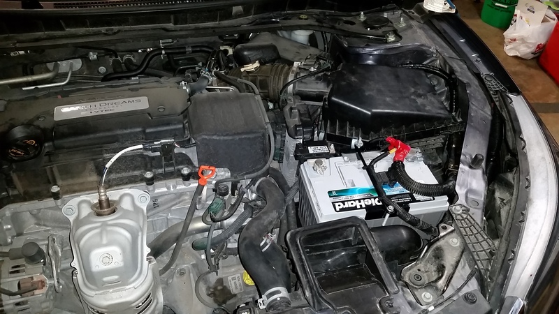

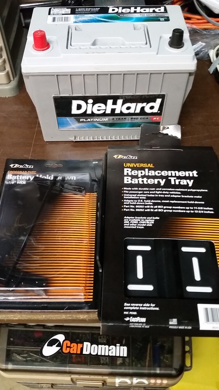

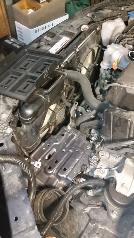

I've seen threads about buying the V6 brackets and trays to install a Group 24 battery in the 2.4L cars. I found that a Group 34 fits fine with generic trays and mounts.
Stock battery (with electrical load additions)
Replacement battery with generic mount and tray
Stock removed
Tray replaced (was eventually bolted down)
Because this battery isn't reversed, I had to get the battery monitor connector on the other side, which is easily done by pulling it back in the loom and routing separately. New loom was added.
Stock mounting bolts are used for the aftermarket hold-down.
I previously replaced the stock power and starting cable ends with terminals. I also insulate the aftermarket positive mount with self-fusing silicone tape rated 1000V per layer.
Attached Thumbnails KHA 2014 Accord Sport SQ Build-20160813_115134.jpg   KHA 2014 Accord Sport SQ Build-20160813_114016.jpg   KHA 2014 Accord Sport SQ Build-20160816_231321.jpg   KHA 2014 Accord Sport SQ Build-20160816_231337.jpg   KHA 2014 Accord Sport SQ Build-20160816_233701.jpg
KHA 2014 Accord Sport SQ Build-20160817_002043.jpg   KHA 2014 Accord Sport SQ Build-20160817_002048.jpg

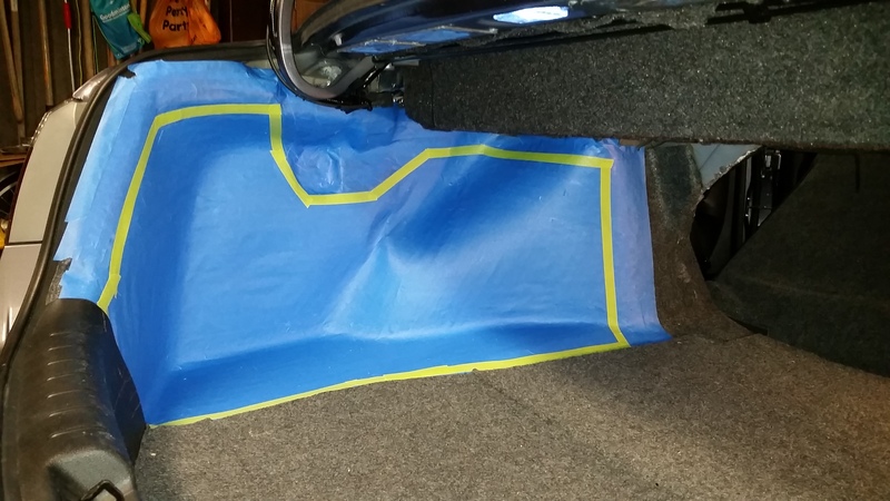

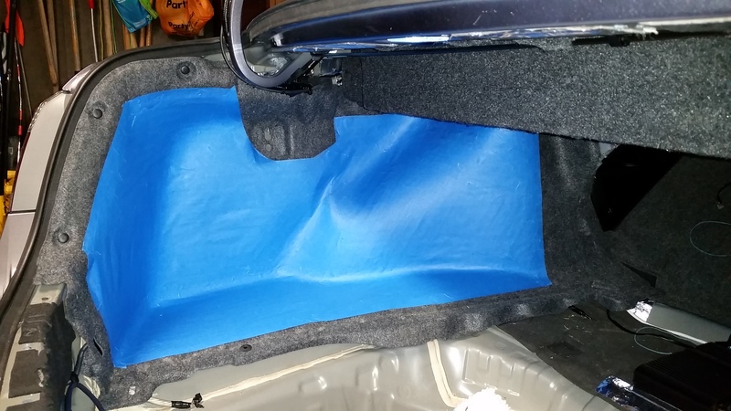

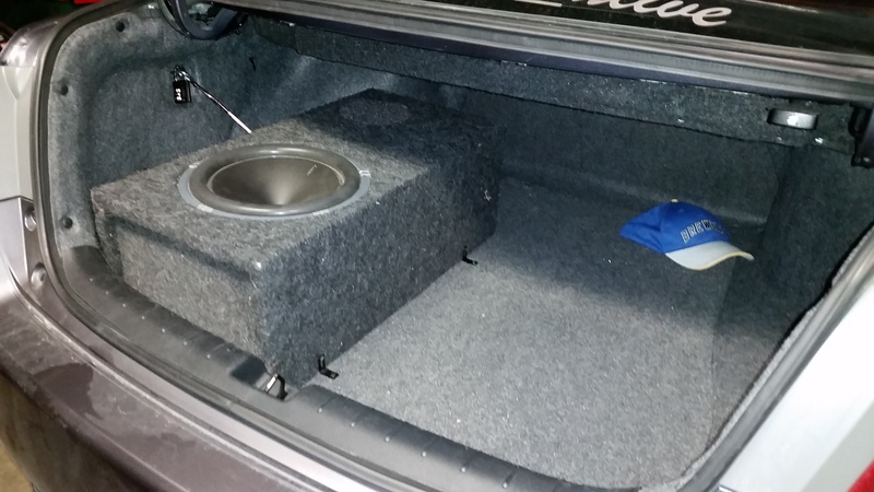

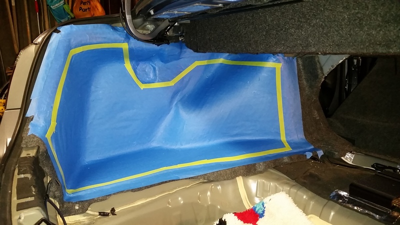

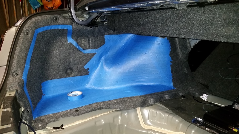

finally time to ditch the MDF box and build a molded fiberglass enclosure in the rear corner.
previously
adding layers of 3M painters tape
outline mostly complete
two layers plus the enclosure outline in green
with the false floor installed. enclosure will allow for removal of the floor for spare tire access.
