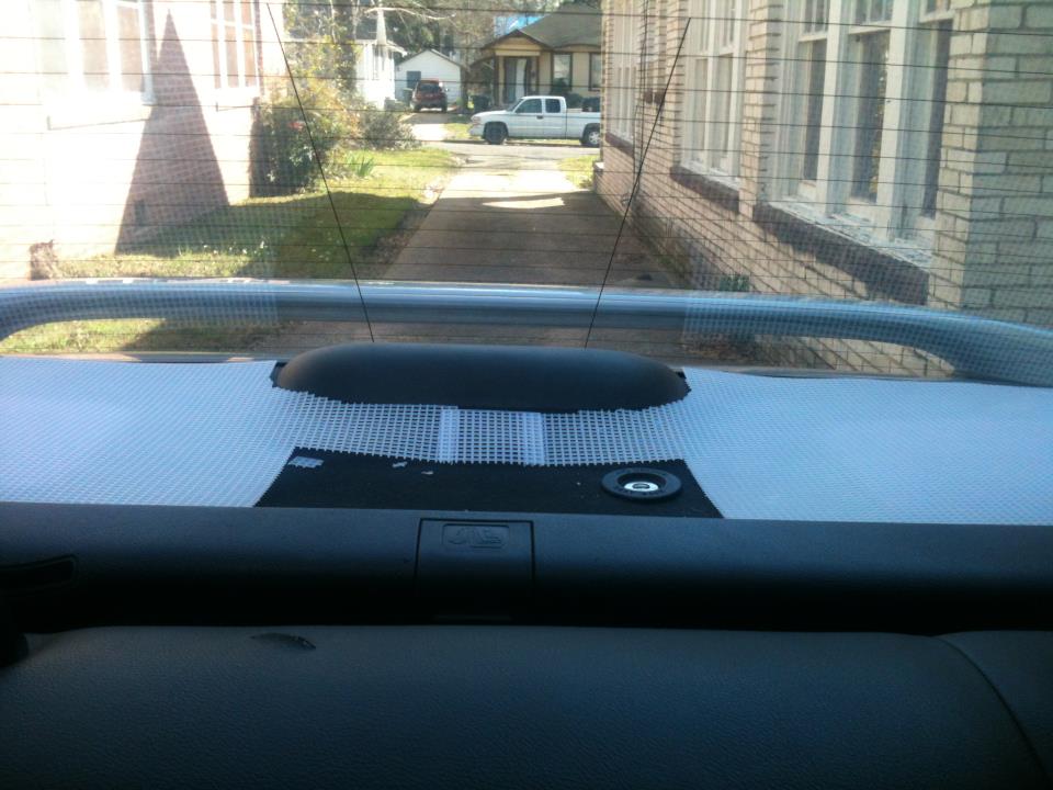

started working on my rear deck yesterday. I figured it would be cheaper than my doors and since I am broke right now, I am doing it first.

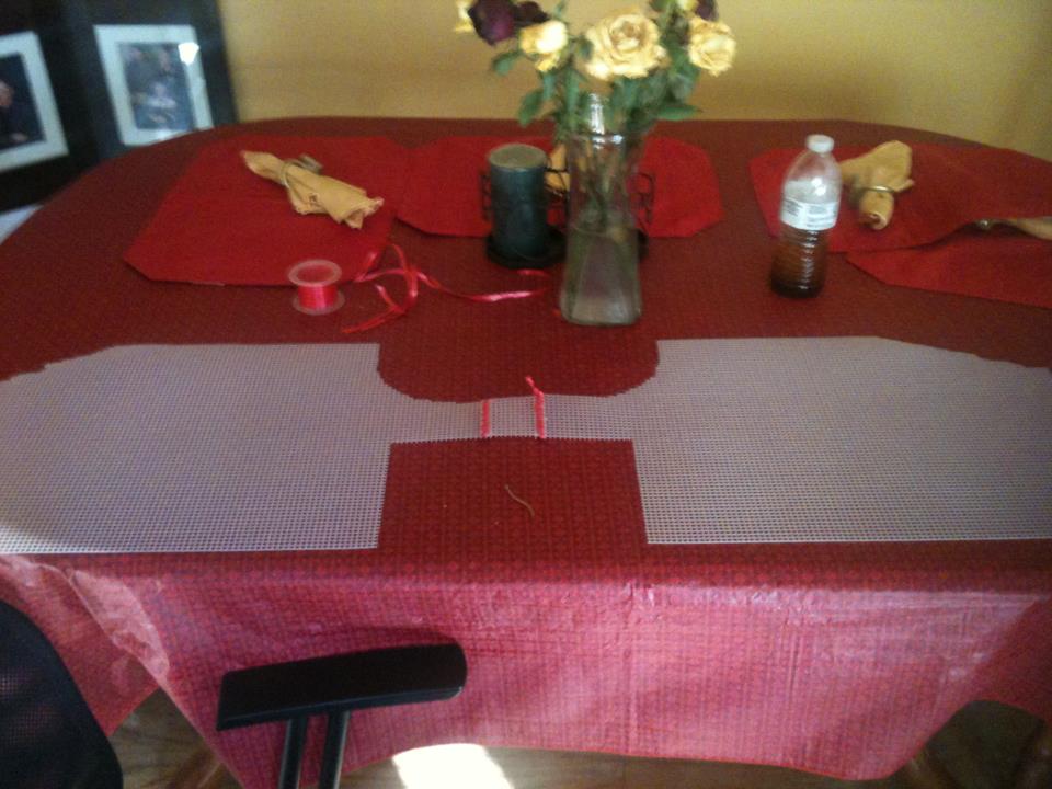

I bought this stuff called plastic canvas to make the stensil. It worked reall well. It was flexible enough that I could get accurate shaping around the stuff on my rear deck but solid enough that when I lay it out on the mdf to cut it should be the correct size and not stretch or distort shape.

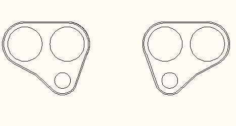

I also drew up some baffles in autocad. they have a 1/4 inch raised lip all the way around to mount the fabric too. hopefully giving in an inset look. I am going to put vynl on the inside. I think this should give a brighter color than painting the mdf.

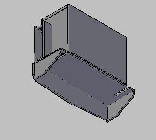

this is what my goal is. bass amps beside the box hidden behind the pannel. when I upgrade the highs amp it will go on the wall horrizontal facing out. this would give me a little bit of room to put stuff in the trunk.

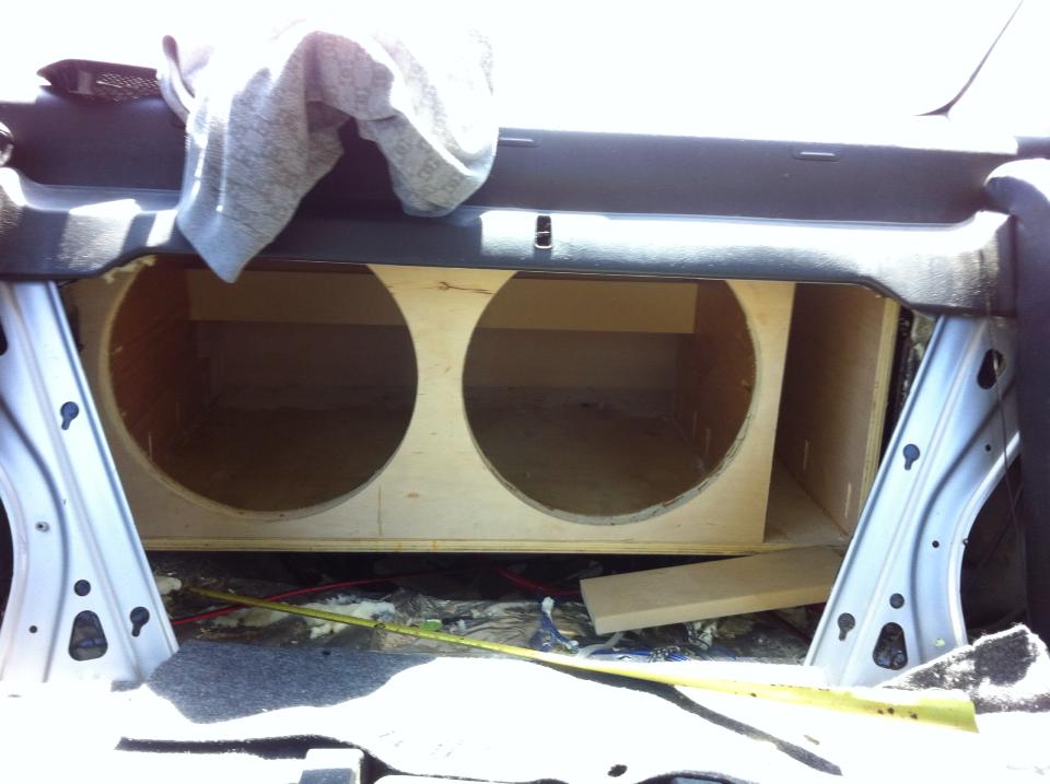

The new box.
Also because of the way this box sits in the trunk, I need to change the latch to lay down the back seat. I am thinking a push button solenoid.
does anyone know if this is the type of solenoid I would need?
