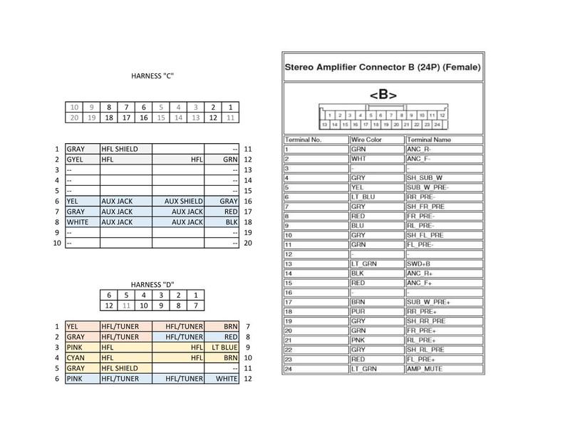

You can hold the Power + Display + Back buttons to enter the diagnostic mode. You can then hold the Select button to enter advanced mode. From there you can disable DSP and ANC.
But good news exists for those with the touchscreen. You can bypass the DSP and factory amp all together by simply adding an aftermarket 5 channel amp. You intercept the factory wires between the HU and amp and feed the amp. Note that these wires are balanced so it requires an amp capable of receiving balanced inputs.
Simply upgrading the amp and snagging the signals will be enough to make most happy. Adding DSP to allow tuning will take it one step further, all while using factory speakers.
The factory sub will rattle the rear deck by itself, so a standard sub upgrade is a nice step 2 after replacing the amp.

Attached Thumbnails New 2016 Accord Touring, but audio sucks!-hu39100t3w%2520harness%2520pinout%2520page%2520002.jpg
