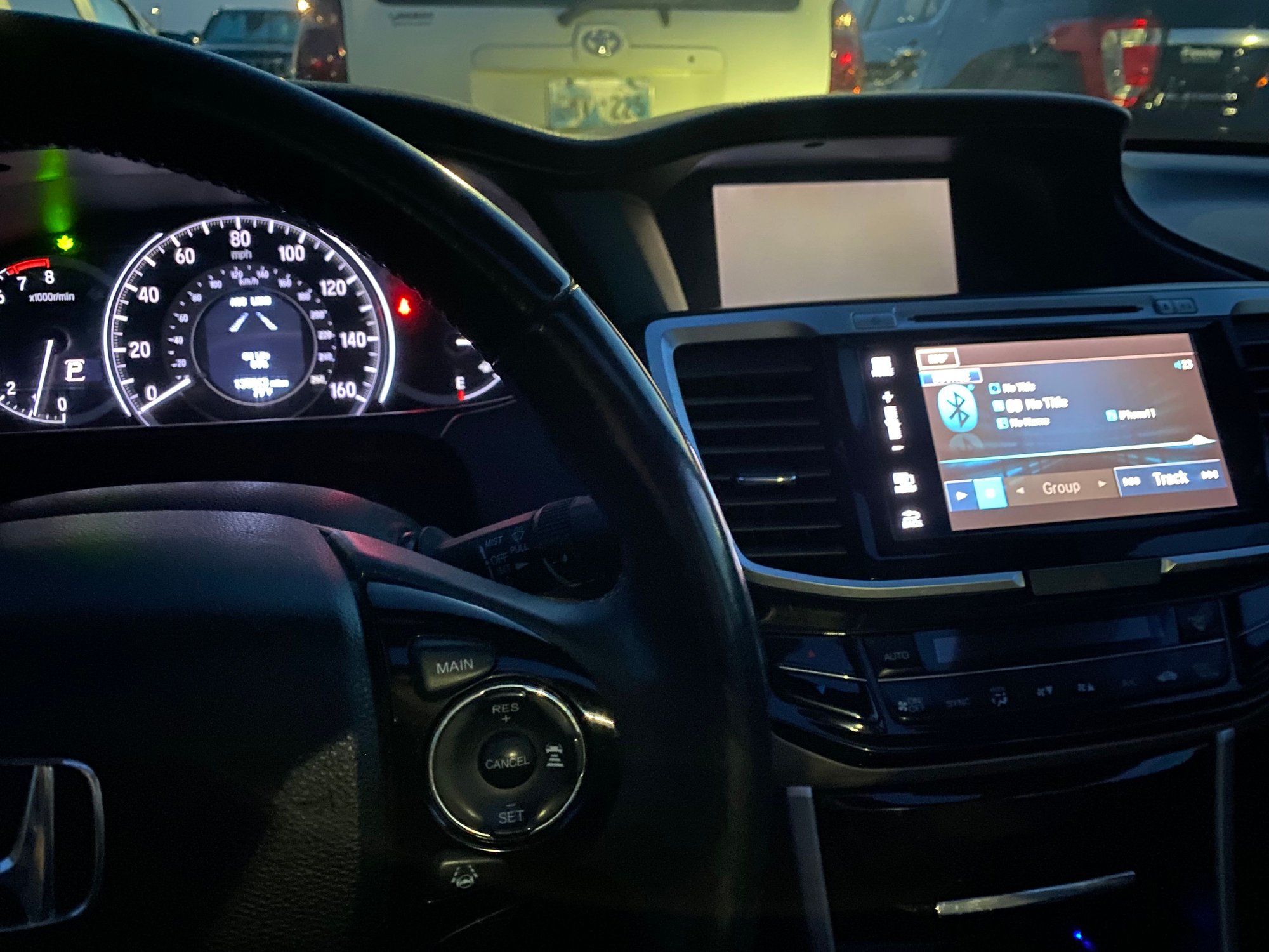

Upper ctr display is blank. No blown fuses

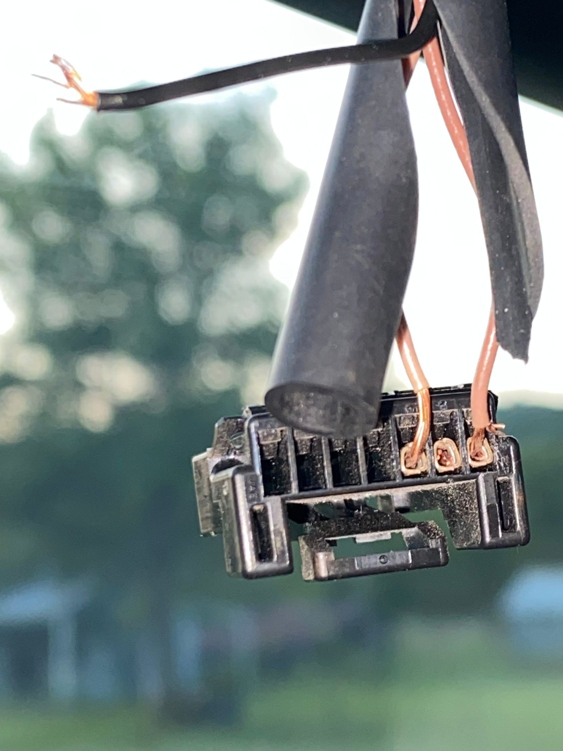

I’ve got two problems I need help with.
First, the wires to the plug on the windshield rear view mirror need to be re-pinned. How and/or what tools needed for that?
Second, the upper center display screen is backlit, so it has power, just no information on it. All fuses have been check, interior and exterior.

Problems solved!
Screen had a loose connector on backside. Reconnected and secured with tywrap, works great!
Found a new plug/with 12” pigtail, though ‘connectorexperts.com, and spliced it in. Everything works great now.
