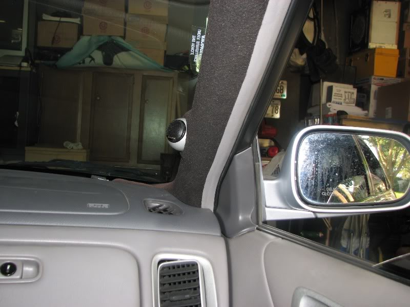

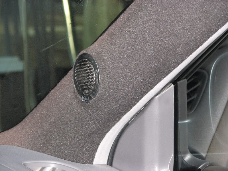

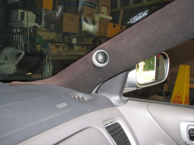

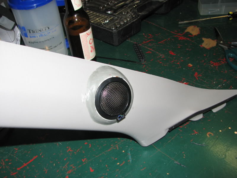

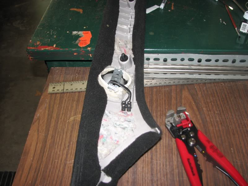

a-pillar mounting is a tried and true method. aiming is where you see differences. on-axis or off-axis. both can work, depending on the tweeter and crossover point.
i made mine by recessing some PVC in the apillar. then i used modeling clay to make the form, then fleece over top.

more recently, i've built tweeter spheres and incorporated them into the sockets, giving me more aiming options.

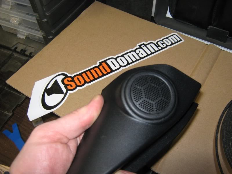

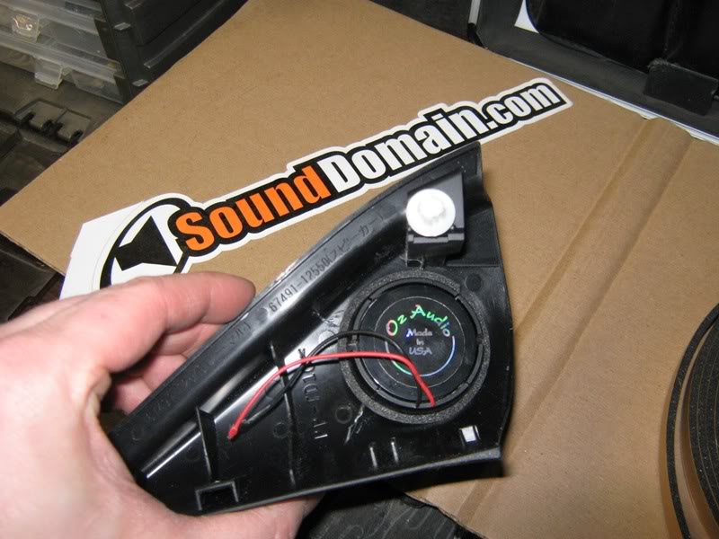

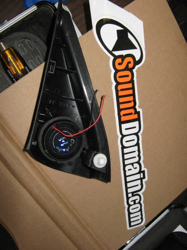

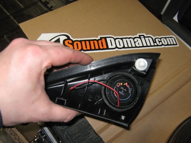

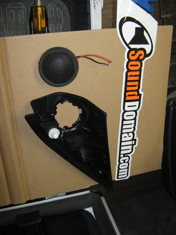

This is an example of how i've mounted new tweeters behind factory tweeter grills, this was a 2008 Scion xB. process is similar for dash mount. you can use plumbing strap to hold the tweeter in place if needed.
removed the tweeter mounting cup and put a ring of gasketing foam around the tweeter to seal up with the factory mount.

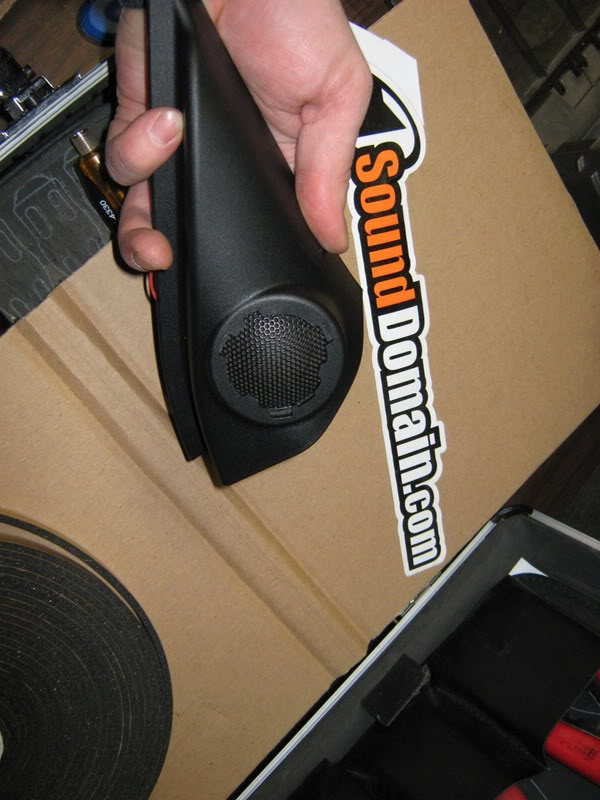

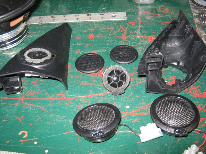

we trimmed down the factory tweeter clips for a smooth surface inside.

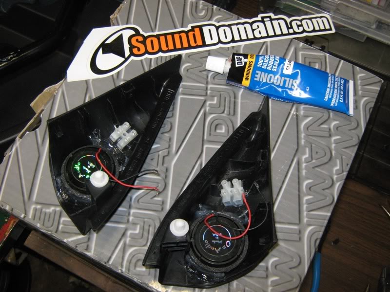

to hold them in place - silicone. not silicone on the tweeters, but silicone on the foam. the tweeter's will look like new if we want to remove them. a simple insulated terminal strip is a temporary connector until i order Molex plugs.
