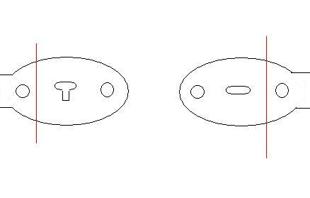

So this Saturday, I decided to put on my "automotive installer" cap on and see what I can do to get this in my car... actually not really, I just asked one of my boys to do it since he is an actual car audio installer.. lol. The honda kit that I purchased from here [http://www.hondaautomotiveparts.com/...TTACHMENT+(XM)] fit semi-perfectly. Once you remove the cubby, you notice that there are two metal brackets at the bottom with two holes and some sort of oval or "t" shaped holes. They are attached at the left and right. This is the bracket where the harness attaches to. I had to cut the brackets, leaving only one of the holes, in order for the harness to attach. (I attached a pic so that you guys know what I'm talkin about and where to cut). Anyway, after those two cuts it was just plug and play.
Anyway, sorry for the basic/quick explanation, but I'm at work. I would've put a pic of it, but I didn't have a camera during the install.
PS: I know, I suck at MSPaint lol
Hope it helps tho! =)
