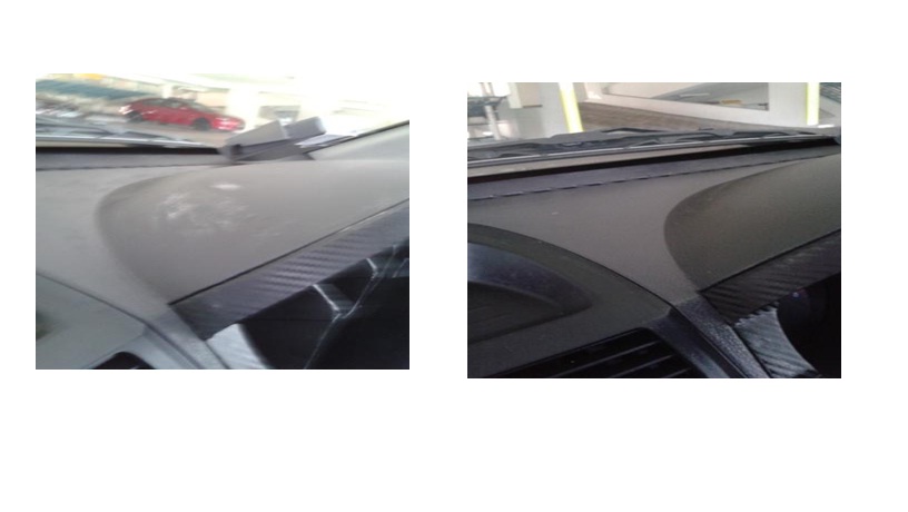

StickyNM's Avatar
Joined: Nov 2012
got the same problem as most car owners. The youtude on fixing sticky melting dashboard will be a faster way to resolve the problem. I had my done one year ago. It doesn't come back anymore.
