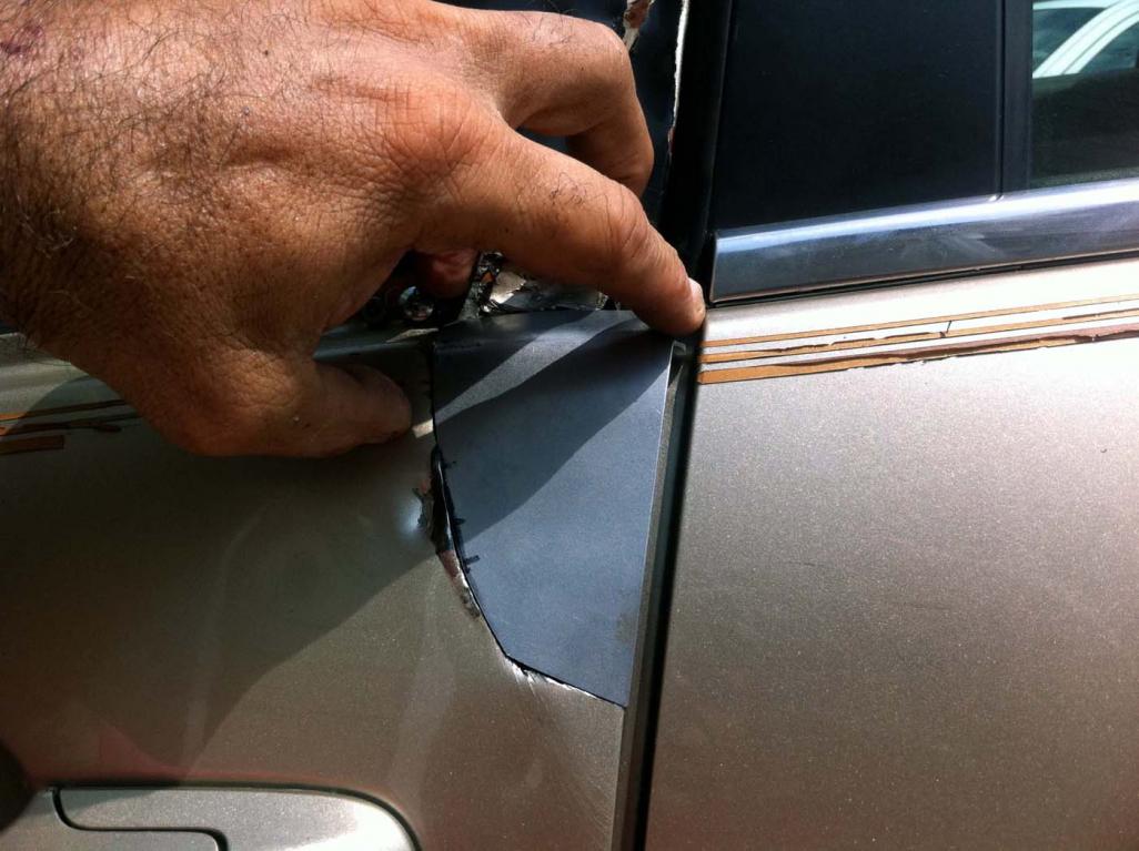

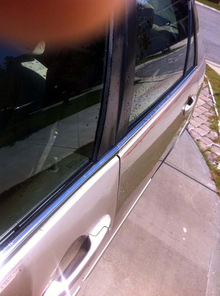

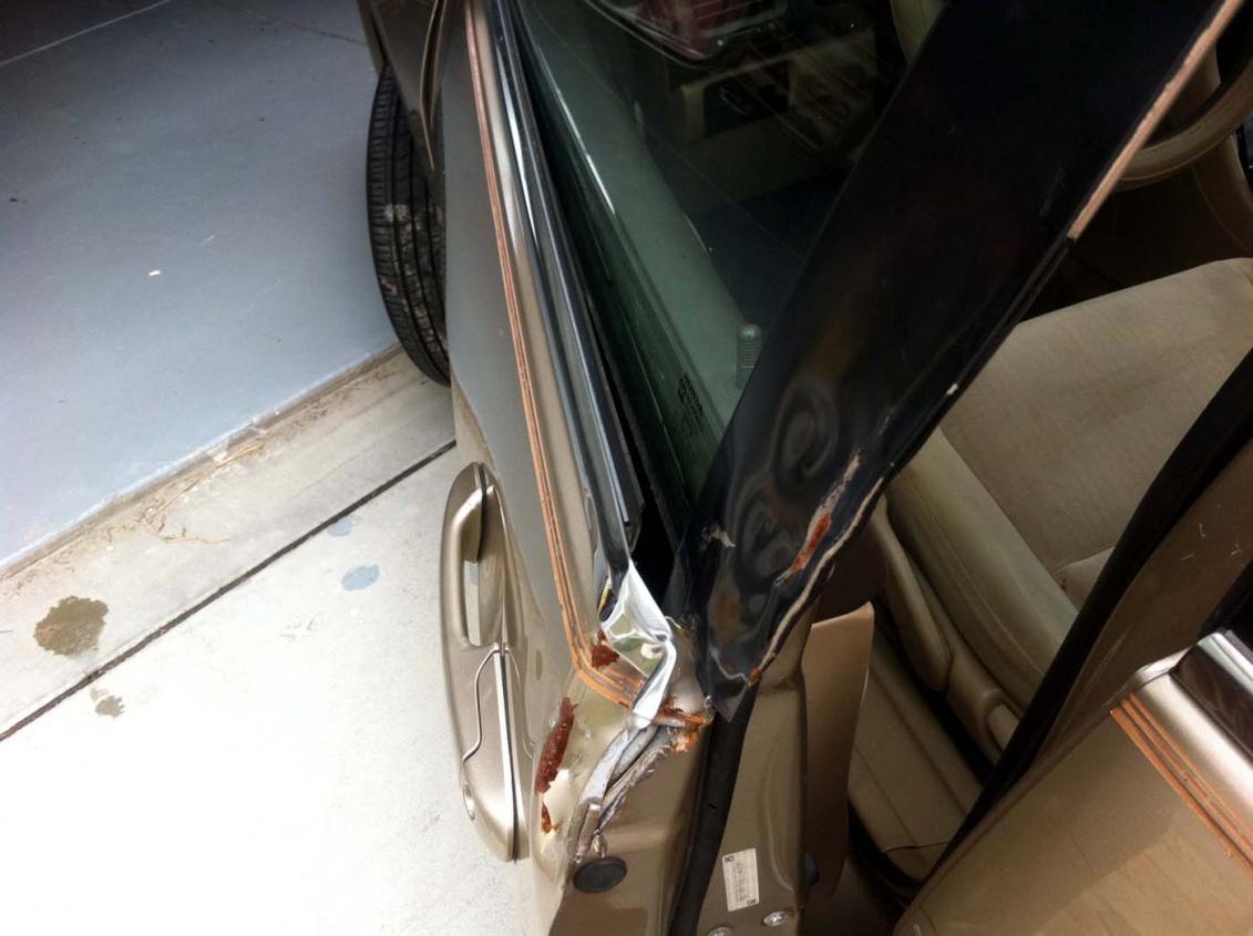

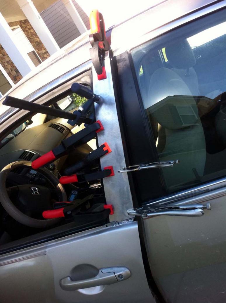

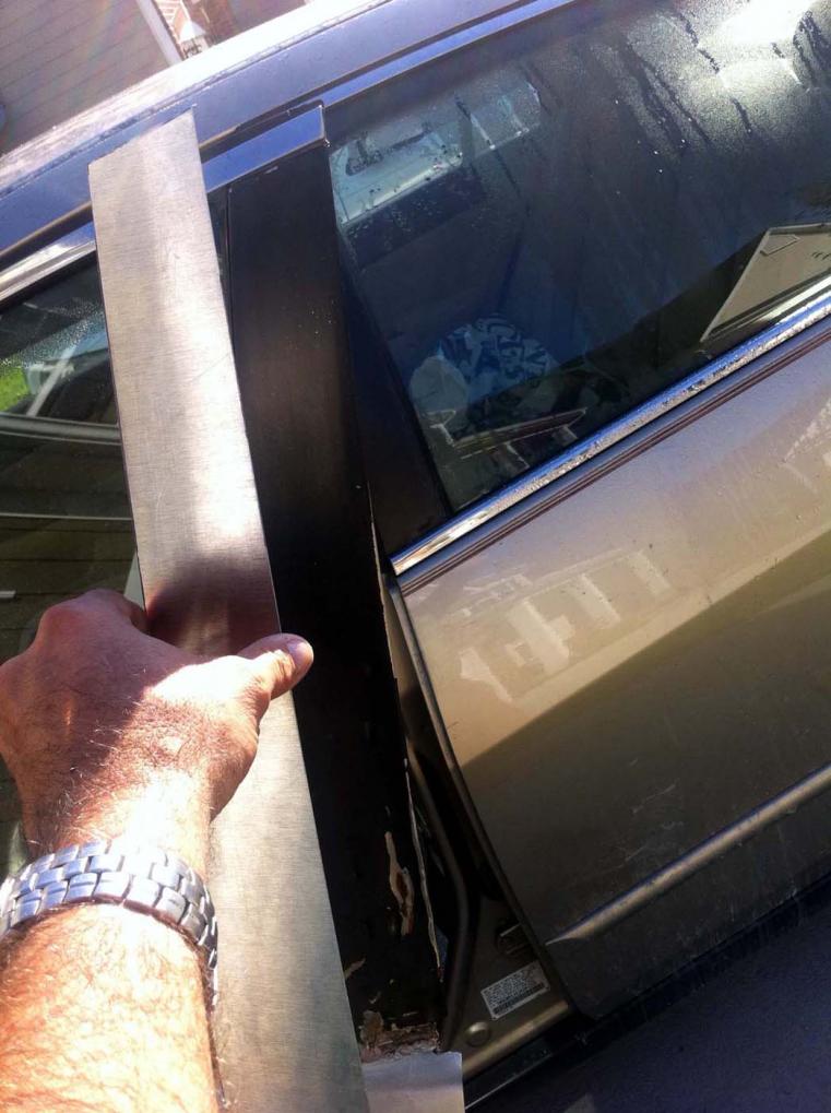

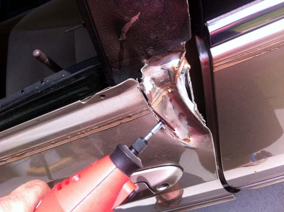

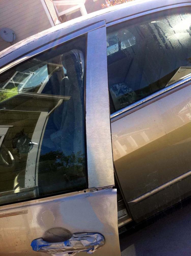

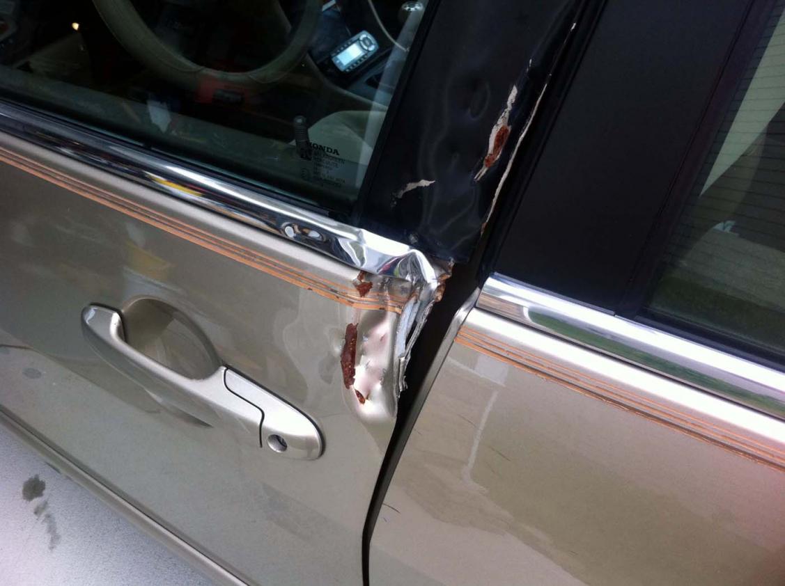

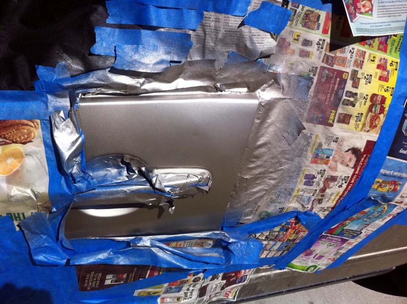

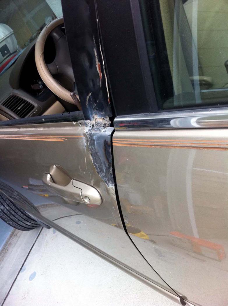

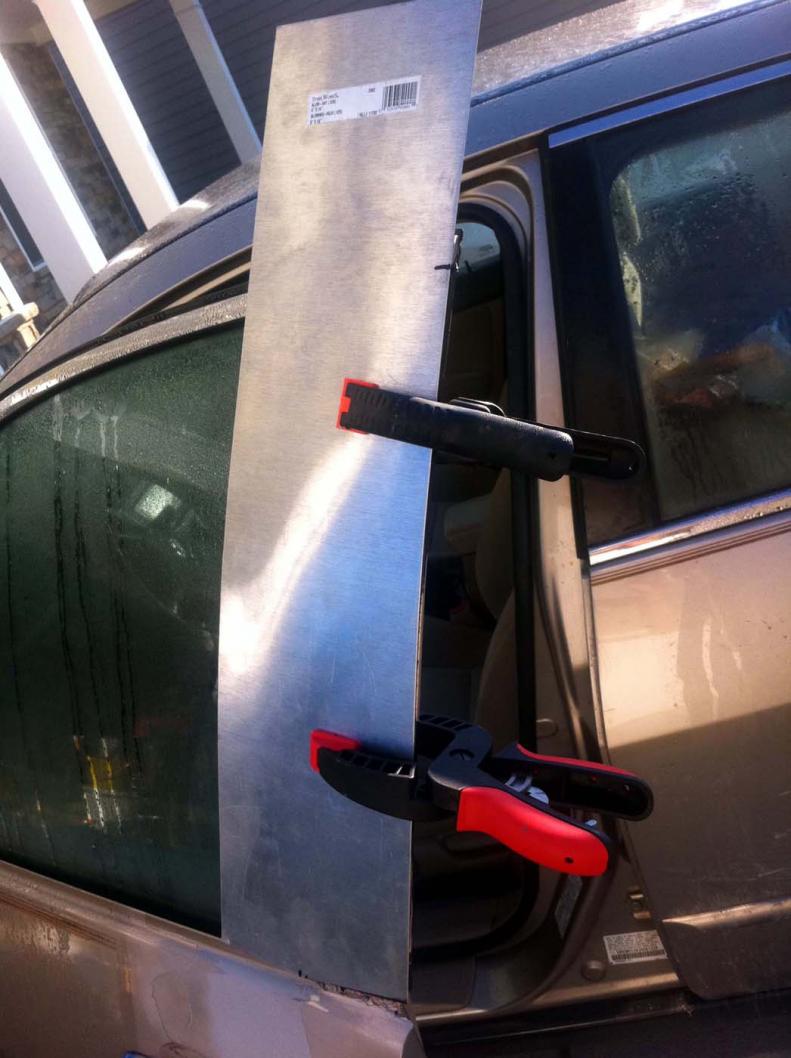

My daughter recently badly damaged the driver side door of her 2003 Accord while reversing with the door still opened and hit a post.
As usual dad was there to help. Here are the pics of the repair I did.
I had to cut out the part that was damaged and weld a new piece of metal instead and then paint it. I also had to replace part of the windows frame as you can see.
Attached Thumbnails Door rapair on my daughter's 2003 Accord-img_0976bb.jpg   Door rapair on my daughter's 2003 Accord-img_0978bb.jpg   Door rapair on my daughter's 2003 Accord-img_0979bb.jpg   Door rapair on my daughter's 2003 Accord-img_0983bb.jpg   Door rapair on my daughter's 2003 Accord-img_0987bb.jpg

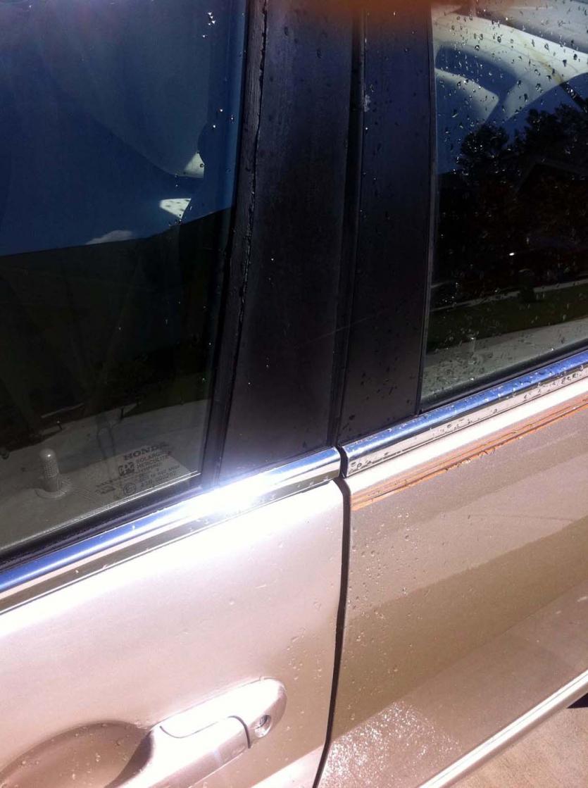

Next pics
Attached Thumbnails Door rapair on my daughter's 2003 Accord-img_0991bb.jpg   Door rapair on my daughter's 2003 Accord-img_0998bb.jpg   Door rapair on my daughter's 2003 Accord-img_1002bb.jpg   Door rapair on my daughter's 2003 Accord-img_1003bb.jpg   Door rapair on my daughter's 2003 Accord-img_1005bb.jpg
