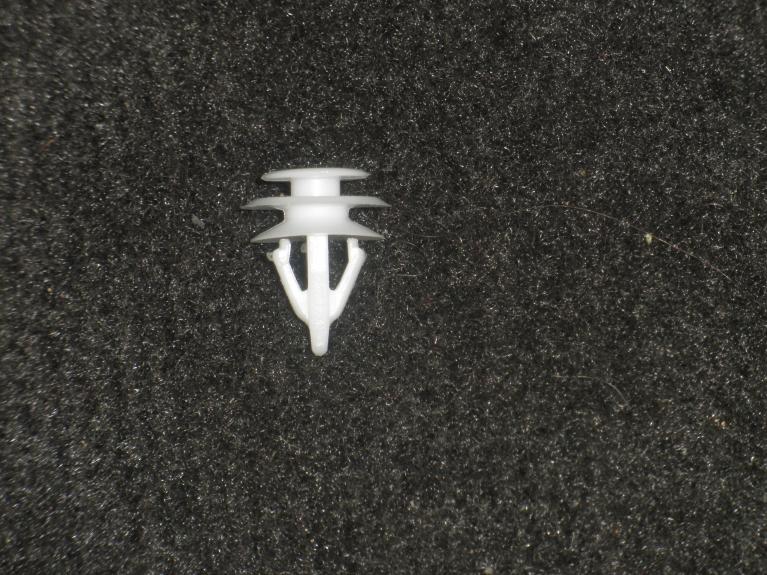

1. The first photo is a picture of one of the two clips so you can see what you are working to get free.. The two clips are located at the very bottom of the seat back cover in the bottom left and right corners. You will need to unhook the elastic strap that holds the bottom of the fabric in place at the bottom of the seat so you can see (feel where these are located. If you can feel them, you might be able to pinch them with a pointy nose pliers and work them out (pretty unlikely). The mechanic at HONDA said they just pull really hard on the bottom of the seat and break the clips. The new ones are about $3 a piece.

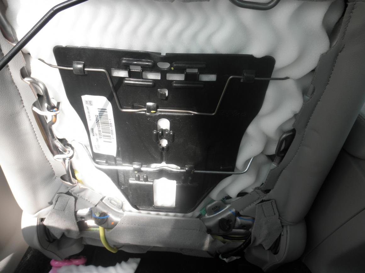

4. The fourth photo is where you can see I am pointing to the upper thin wire. In this photo you can see the black lumbar plate, the upper thin wire I am pointing to and the lower thick black wire.
5. Take a look at the upper wire and slide it out of its connections on each end. The wire then can just snap out with a little effort. Bend the wire so it looks like photo 5.

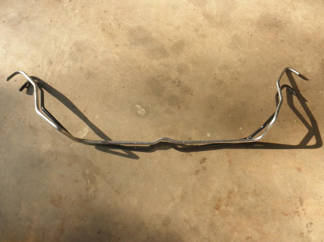

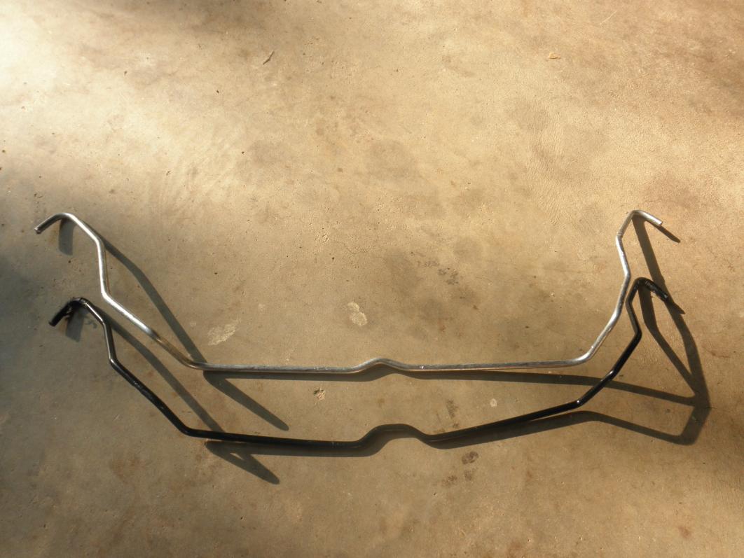

6. In the next step you will need to remove the lower wire. This is made easier by pushing forward in the head rest. When you push it forward, you can see that it becomes loose and then you can unhook it from the pivoting plates it hooks into on each end. You then need to get a wire that is the same diameter and type of metal so that you can bend it into a new modified replacement wire. I went down to Lowes and purchased a Heavy Duty tomato cage ($3.50) and removed one of the vertical wires because it is nearly the same size. Picture #6 shows the original lower wire and the new one I fabricated. The new silver one is slightly deeper than the original one.
7. The new re-fabricated lower wire is only different in that it is longer on each end by about 1/2" on each side. Take a look at photo #7 (the second one in this post). This step took a little time but all I used was a pilers and a channel lock type pliers to grab and bend the wire.

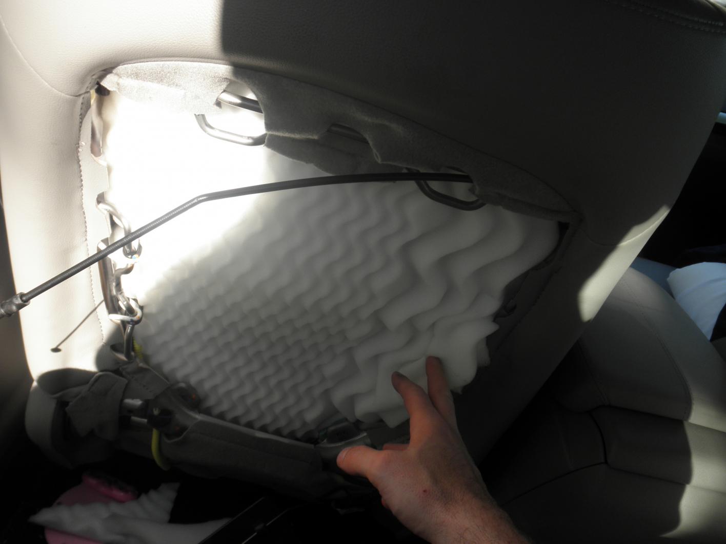

8. The next thing I did was put a layer of foam that I got from Walmart that you would put on top of your bed into the entire seat back. Also not shown here is some added foam that I put on the very top and some more on each vertical side of the seat back. Look at photo #8 (third in this post).

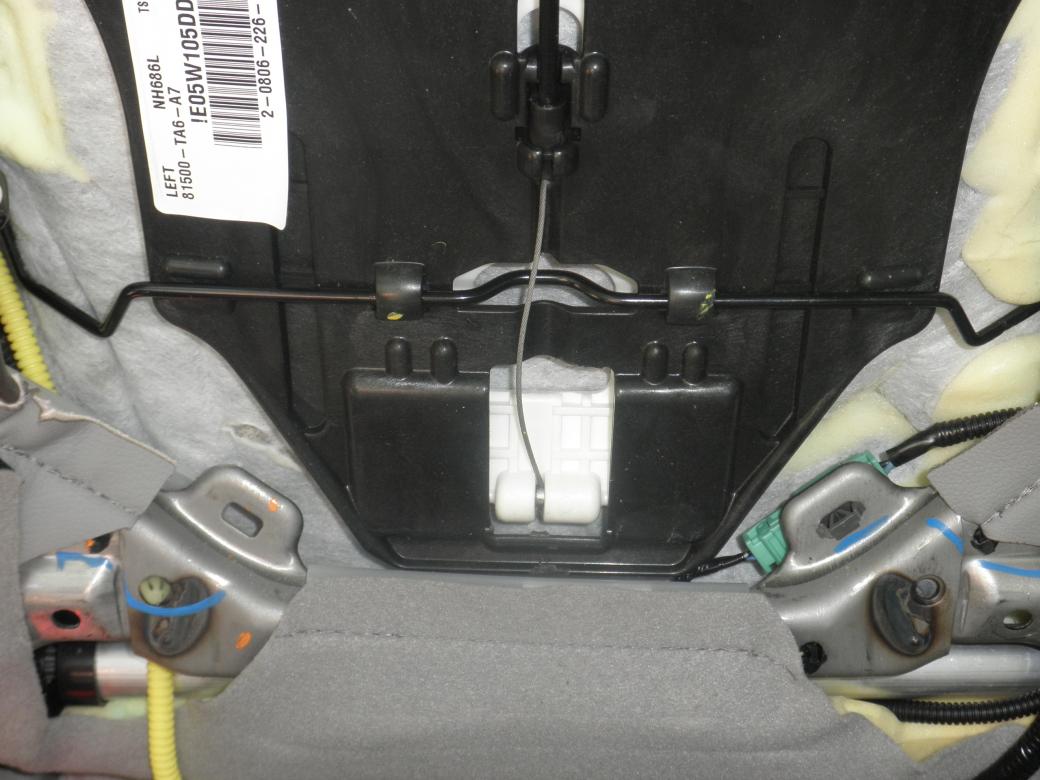

9. The next photo shows the black back plate re-installed WITHOUT the white adjustable lumbar support in place. If you remove the white adjustable lumbar support plate, this will stop a lot of the pain but obviously you won't have that function anymore in your seat. I personally am glad it is gone. Well worth removing it. Please note that the lower wire is installed upside down. Installing it this way will lower the entire back plate which will further relieve the pressure on your back.
Replace the adjustable lumbar cable even though it does not connect to anything so that it does not interfere with anything and put the seat back on. You can snap the back cover into place and feel the results of what you have done without putting the new bottom clips in. If you fabricated the new wire TOO deep, the seat back will not stay on. It is tempting to make the lower wire even deeper, but it won't allow you to get the seat back on...... No good. If you are not satisfied and want to put the seat back to it's original condition, you can do that from here. Also if you want to leave the adjustable lumbar in place you can do that also. I recommend taking it out.

To add to the original post: To remove the back cover, you need to work a couple more side clips off. These are not the clips mentioned in the post. After removing the trim clips that are shown in the post, there are two plastic clips "pinching" the squiggly grey looking tubes shown in the pictures. One on each side. They will pop with a little force. Just work your hand in there from the right side bottom to about the middle and you can tell from the tension that it is there. I don't think you would be able to break them by doing this.
