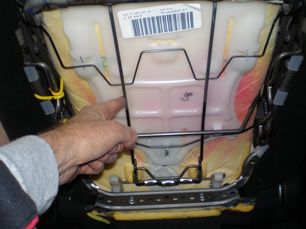

Do you take these bars out?
I'm pretty sure none of the solutions require that brace to come out. If it were me...I would just remove that lower crossbar , and try it out for comfort (it hooks in on the sides- and you have to kind of wrench it- if you cant see how it hooks in, but it does come out). Thats what I did, and it's perfect to me. This relieves the majority of the pressure that the plastic plate can apply to your back. If it's not satisfactory, the more elaborate fabrications in this post should get you there.

I took out lower bar. What a pain. Stuffed with layers of foam. Will drive for a few days and hope it fixes problem. I am also going to take a long piece and cut to fit seat and cover. Lower seatis a little hard.
