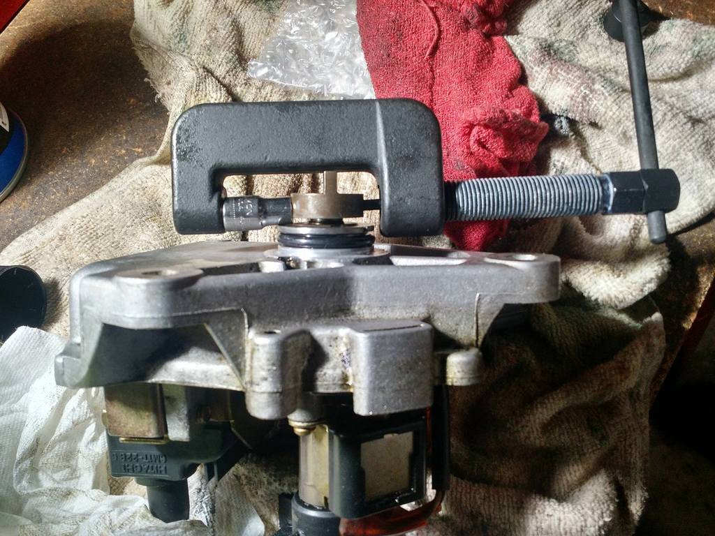

Attached Thumbnails Replacing internal seal on Hitachi D4T97-03 Distributor-12789885_545221788989416_236339572_o.jpg

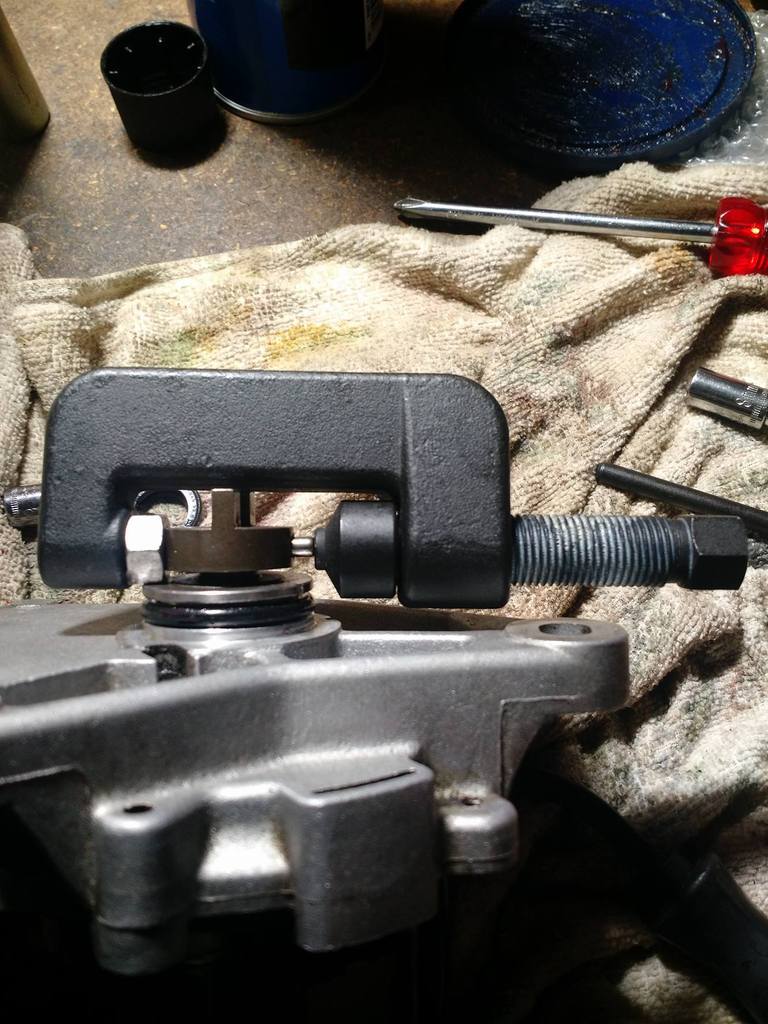

I replaced the inner seal today and used a motorcycle chain breaker/riveter for removal and install the pin. I couldn't imagine having to punch it with a hammer and punch, it was tight!
Attached Thumbnails Replacing internal seal on Hitachi D4T97-03 Distributor-12787396_545221862322742_1035702062_o.jpg

Great idea using the clamp ... yes that pin is a lot tighter than it probably needs to be ...
