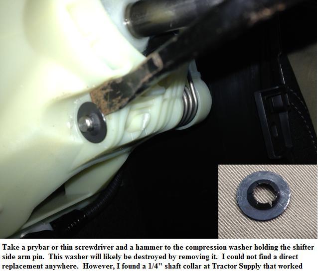

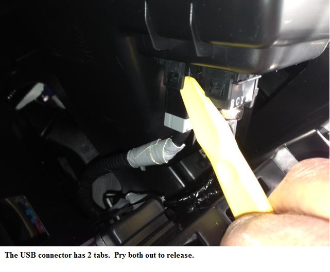

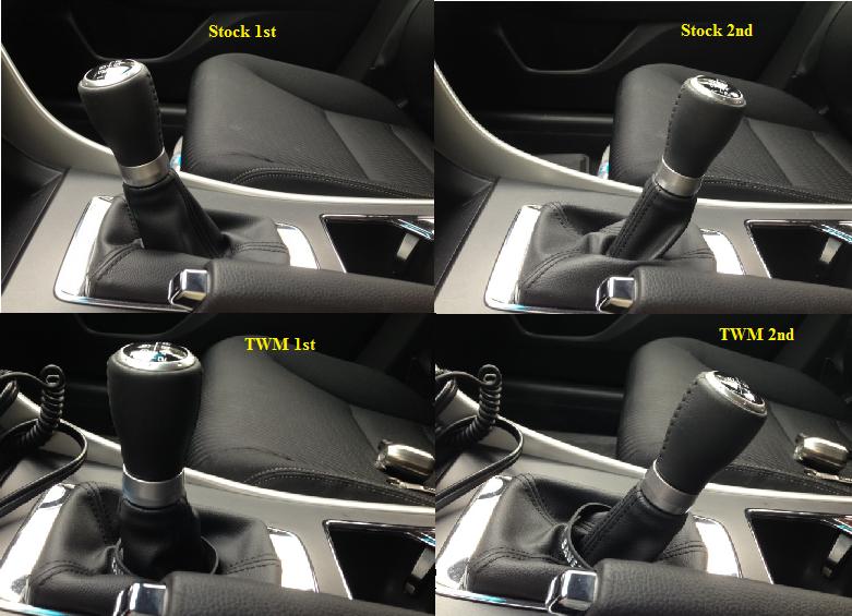

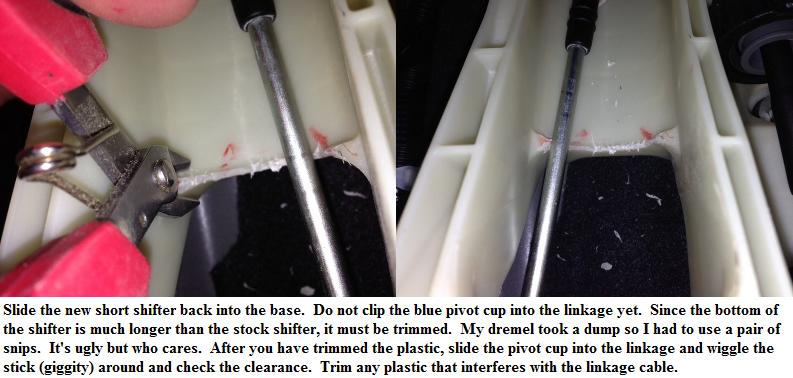

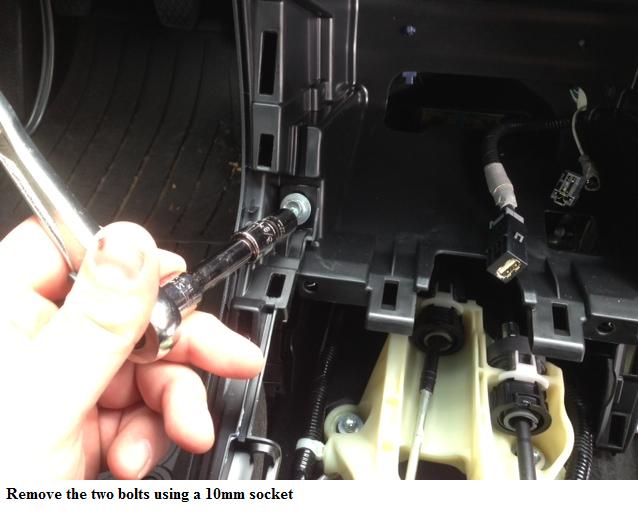

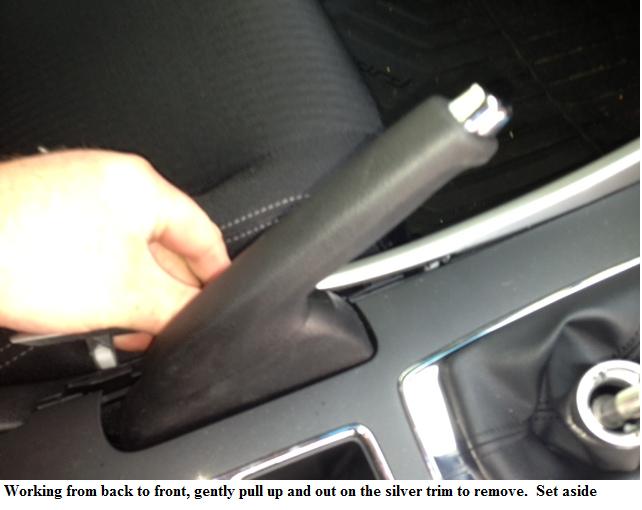

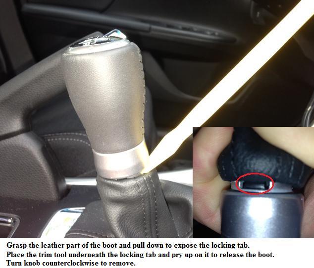

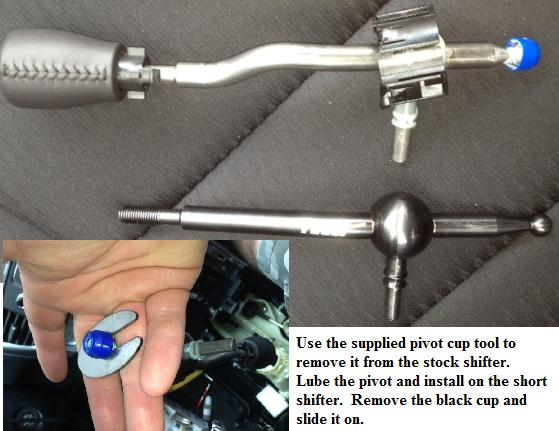

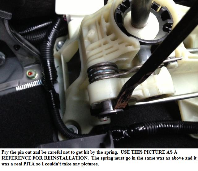

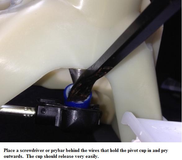

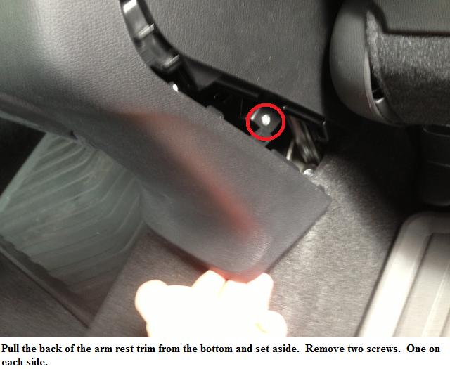

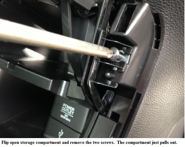

Hello everyone! I was talking with TWM Performance about a STS for the 9th gen Accords. They seemed to think that their shifter for the 08+ Accord would work. And it did!

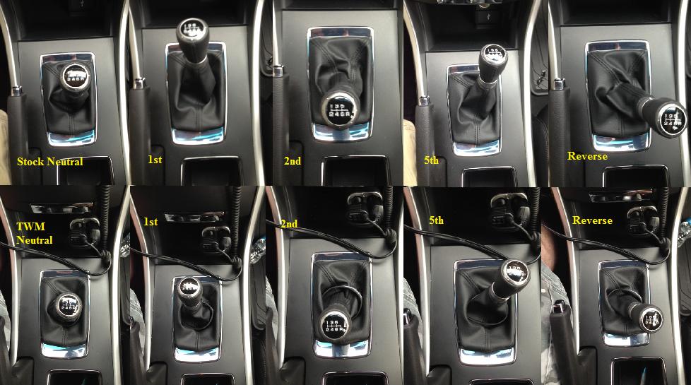

As you can see the stock shifter is WAAAAAY out to the right. The TWM STS is angled slightly more towards the driver. Taller people, like myself, won't have to reach so far for 1st, 3rd, and 5th. It is so much more comfortable.

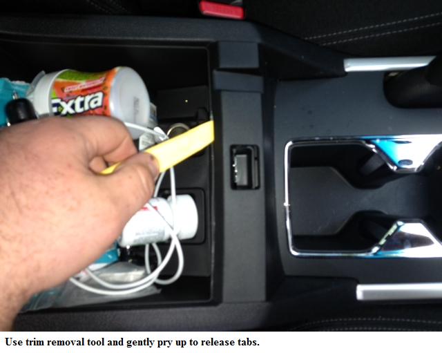

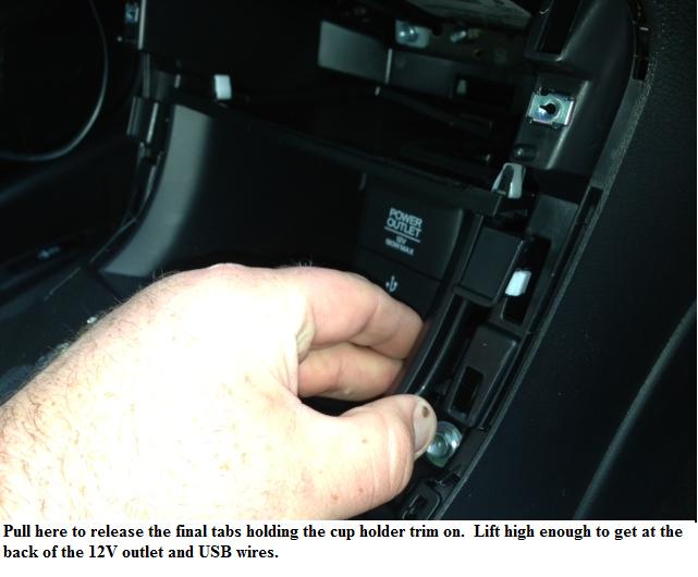

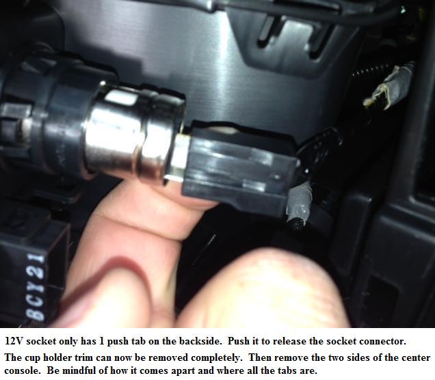

You will need:
Phillips and Flathead screwdriver (and or small prybar)
Trim removal tool
Mechanics pick or very small flathead screwdriver
10mm socket

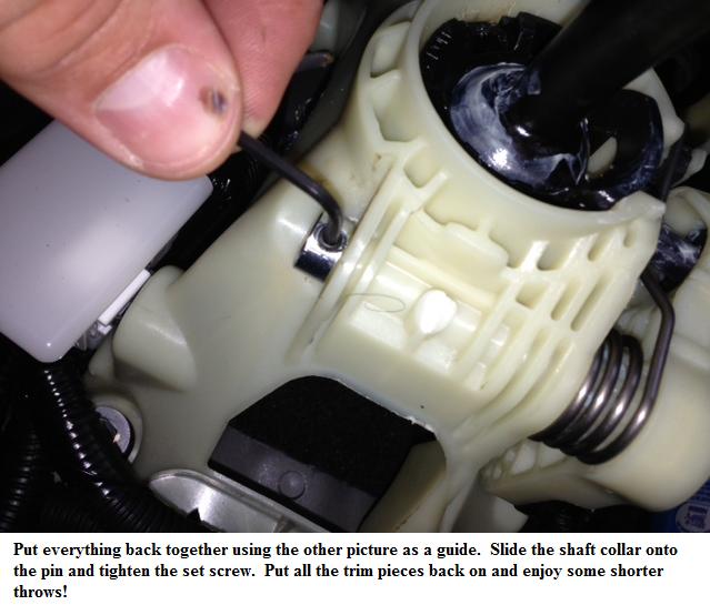

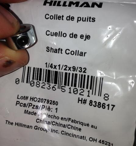

Maybe a 1/4" Shaft collar.
Ok here we go.
Sorry for the crappy MS Paint pics. Feel free to ask any questions!
