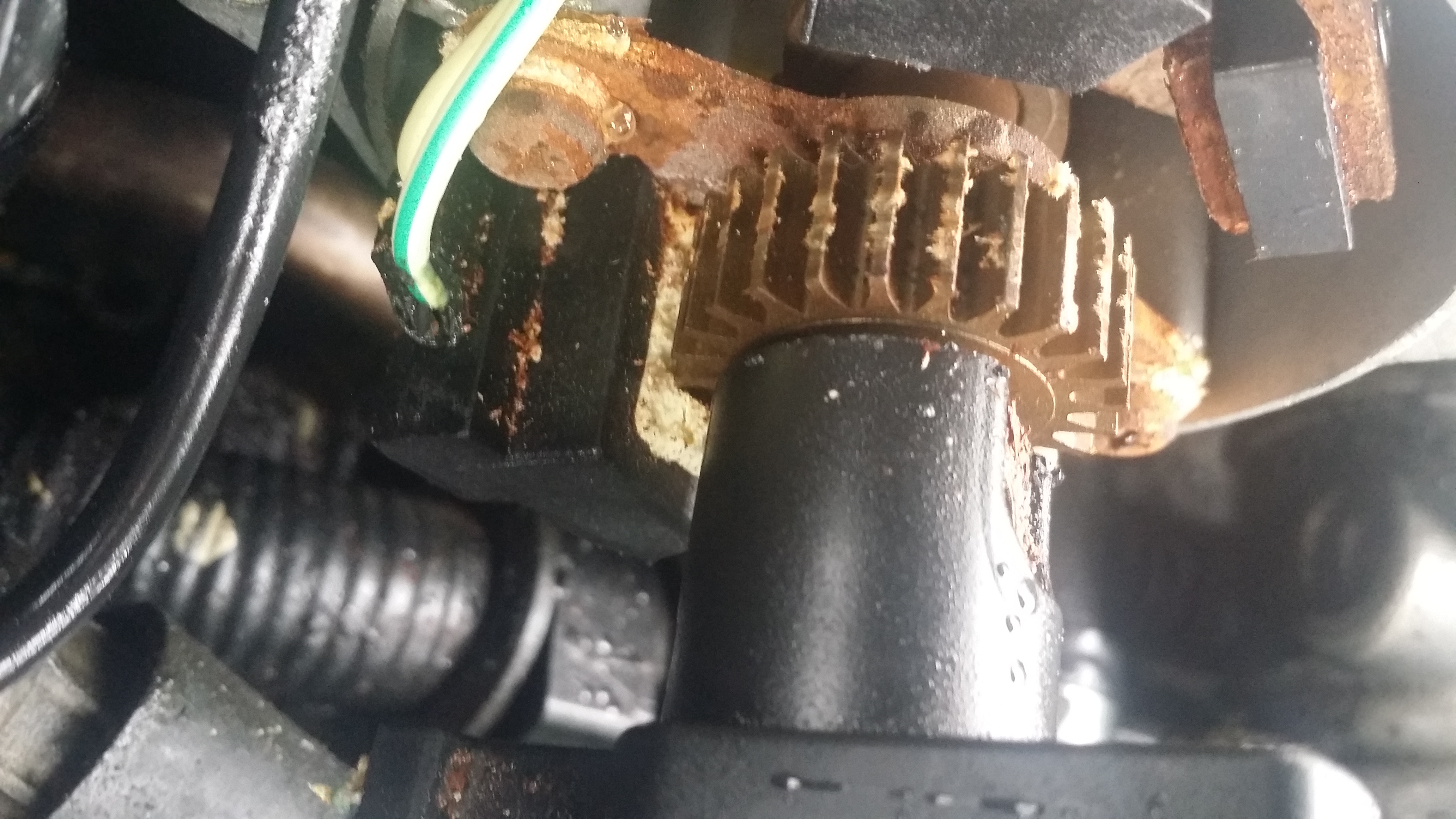

I have a 91 Prelude Si that i bought from a friend he had a problem with the distributor getting totally gacked inside ,he had everything replaced ,now .I have the same problem. Its full of fuzzy white crap that is comming off the Pick Up/
anyone know what this is?

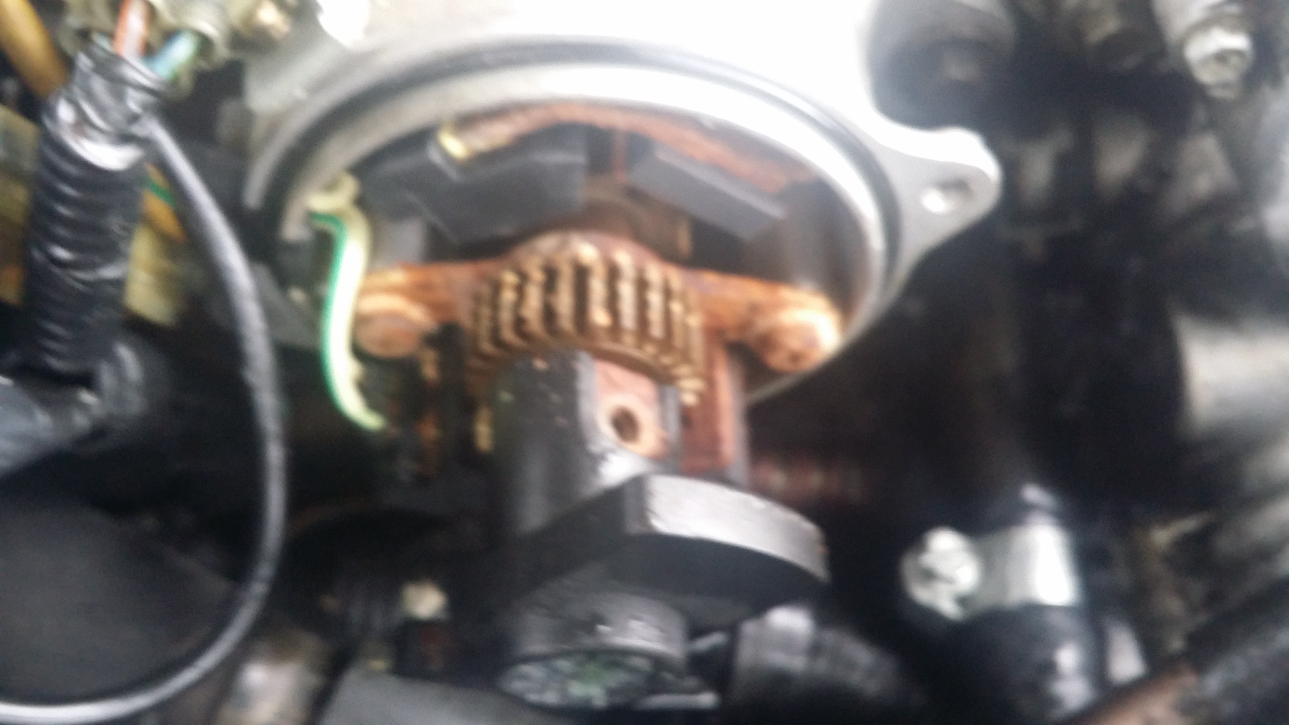

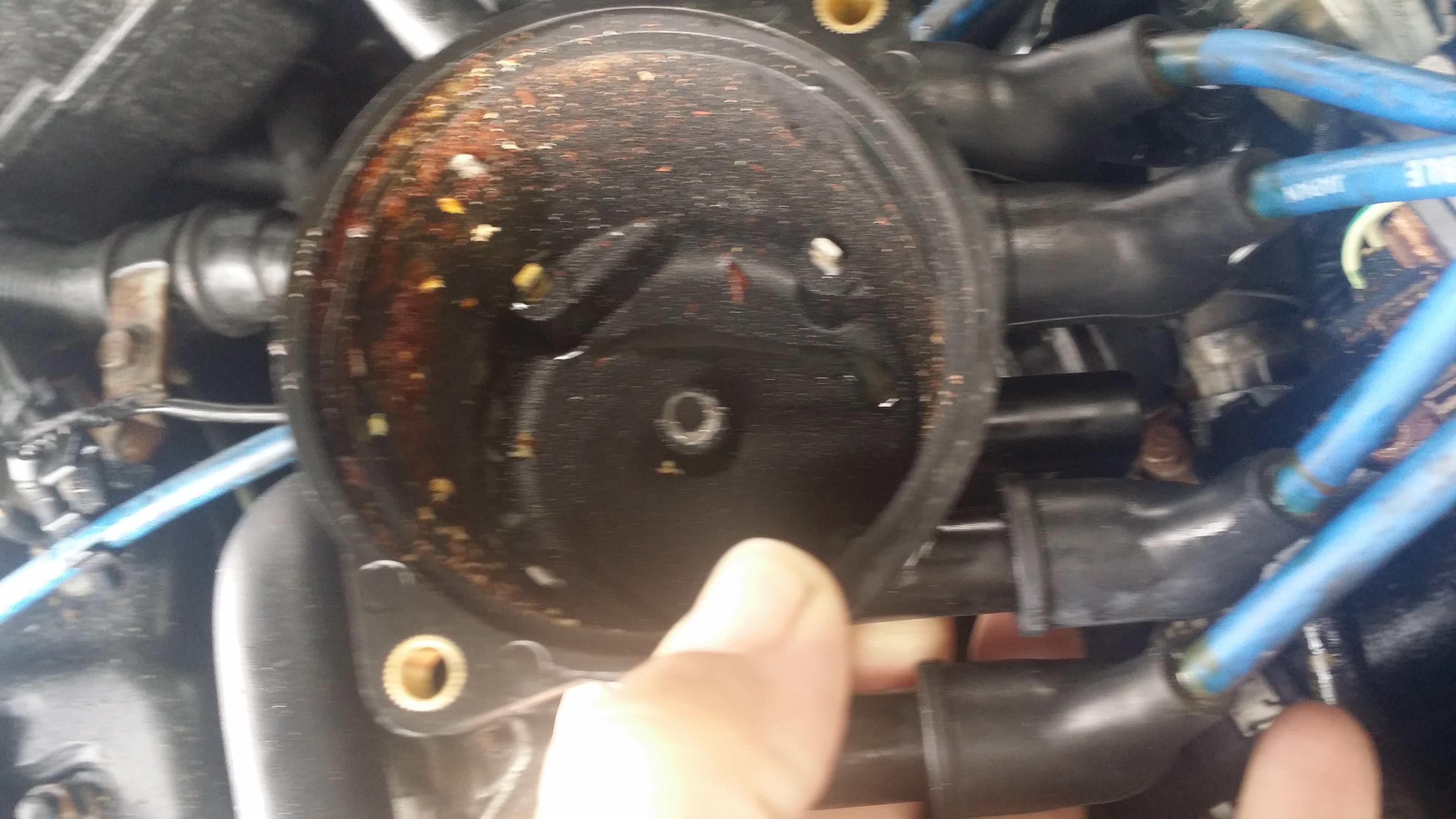

Ok here are some pictures for ya
SR66

Old Dec 5, 2015 | 05:59 PM
I've seen worse.
1. Remove the battery cable(s) and use some electronics cleaner and give it a bath.
2. A light coat of WD40 and let that sit for a while.
3. That dist cap is done (pic 3). Get a new one and the o-ring seal that goes with it......and since you are replacing the cap, replace the rotor.
See what you have from there.

This is the 3rd dist in 2 years according to my Freind I ordered 2 caps and rotors and a distributer I am wondering why this is happening. Car uses oil not alot and runs great until this happens. Hmmmmm

There is something really weird going on if u look at the reluctor wheel and the pick up coil making some white fuzz that its cycling thru its like there is Electrolysis going on. The rubber around the power wire is disintegrated .something is weird maybe it needs to have a exorcism
