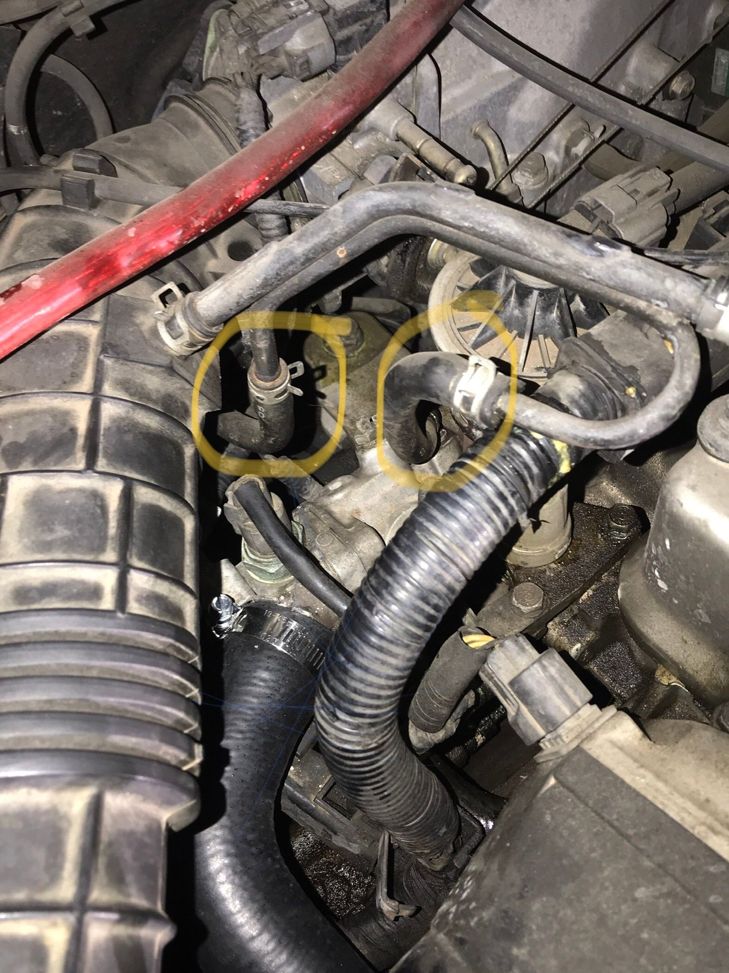

So I’ve replaced both radiator hoses today but I noticed my car was still overheating. I saw what I believe was a coolant spraying from the breather hose? I’ll post a picture, but I’m just not sure what the part/hose is called. I’d appreciate some help. It’s a 2001 lx 4 cylinder if that helps.

I bought the car from a salvage yard and the radiator was busted from and accident from the previous owner. Once I replaced that it worked fine but recently the car overheated on a 30 minute drive home from work. The thermostat needed to be replaced. After I replaced that everything was great again. A month later it was over heating again and when I popped the hood I could hear a hissing but couldn’t see it. So I replaced the radiator hoses, everything was fine. Yesterday I went to the store and came out after 5-10 minutes and saw half a gallon (maybe less) of coolant puddle under my car, checked for leaks and saw the first part pictured (left one) spraying coolant.

I'm not understanding how coolant is spraying from a breather tube.

This is the part you are looking for. The third group is what I believe you're saying is leaking. The second group goes to the VC and air flow tube. The first item is what you will need to purchase and then third group.
Breather tube- 17137-PAA-A00
Breather tube hose- 17138-P0A-000
Clamps- 95002-41300-04 (x3) if you want to replace the clamps
Hose A- 19514-PAA-A00
Hose B- 19515-PAA-A00
Clamps- 95002-41250-04 (x4)

I stand corrected on the breather tube. It is a 2 part piece and coolant flows through the bottom pipe.

I replaced those hoses and everything’s running great! Thank you so much for the help, I appreciate your time and effort.
