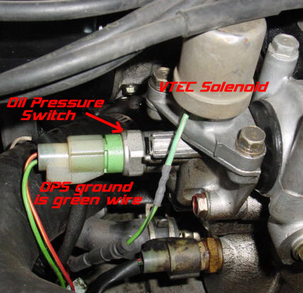

ok bought the car (96 accord vtec 5-spd coupe) 6 months ago and ever since its never revd over 3k. i thought it was the ckp but switched it and it made no difference. a friend told me its a vtec issue and for some reason i dont have a oil pressure plug on the harness for the one on the solonoid. does this mean its had an engine swap, wrong selinoid and how do you ID the engine? please help.

See the wire hanging from the top of the vtec solenoid? That is the wire...but it looks like it has been replaced before. That’s why you might not have a plug anymore. They might have just snipped it off and wired it directly. Or you can try and trace that wire and see if you find a plug
