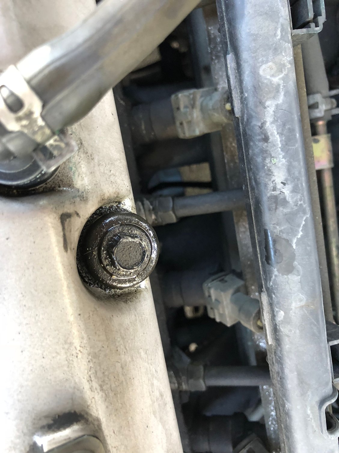

Yes I have done as that has been stated in your message. I have wiped down the area of the distributor and solenoid and started up my car to let run idle for a while. No leaks. It leaks when I drive it around. I notice now that the bolts on my engine block is saturated with oil. Do you think it’s a possibility that the valve cover gasket is slightly off? I’ll put up the picture of the bolts that are saturated.

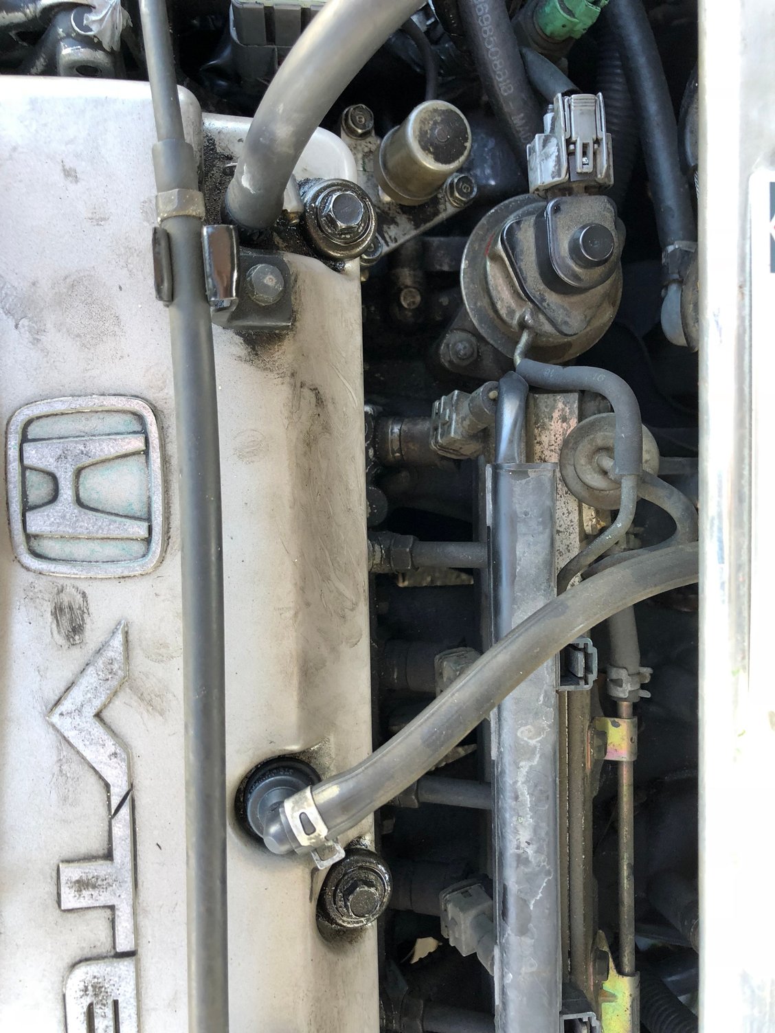

Thank you. I’ve done all that was stated in your message. I noticed now that the bolts on top of my engine block is getting saturated with oil. What could that mean? Possible chance that the valve cover gasket could be misaligned?

Here are a few pictures of the bolts.

Those aren't "engine block" bolts, those hold down the valve cover. You knew that from removing the cover. Don't over-tighten them because I've seen threads where people have broken them. Someone around here might know the tightening torque, but I think it's not very high.
Normally, a valve cover gasket set comes with new rubber grommets for those bolts. The rubber gets hardened from age & heat so they don't seal real good after removing.
Sometimes a plugged PCV valve can lead to a bit higher pressure in the crankcase, which increases oil leakage. Check your PCV valve whether the plunger moves/rattles like it should. But your PCV valve looks kinda new...

My apologies. I’m like a caveman when it comes to cars, but thank you on the correction. It is more to my learning. And yes! I have changed the PCV valve a while back. YouTube guided me on that one. I’m going drive the car for a while and check around those spots again.
