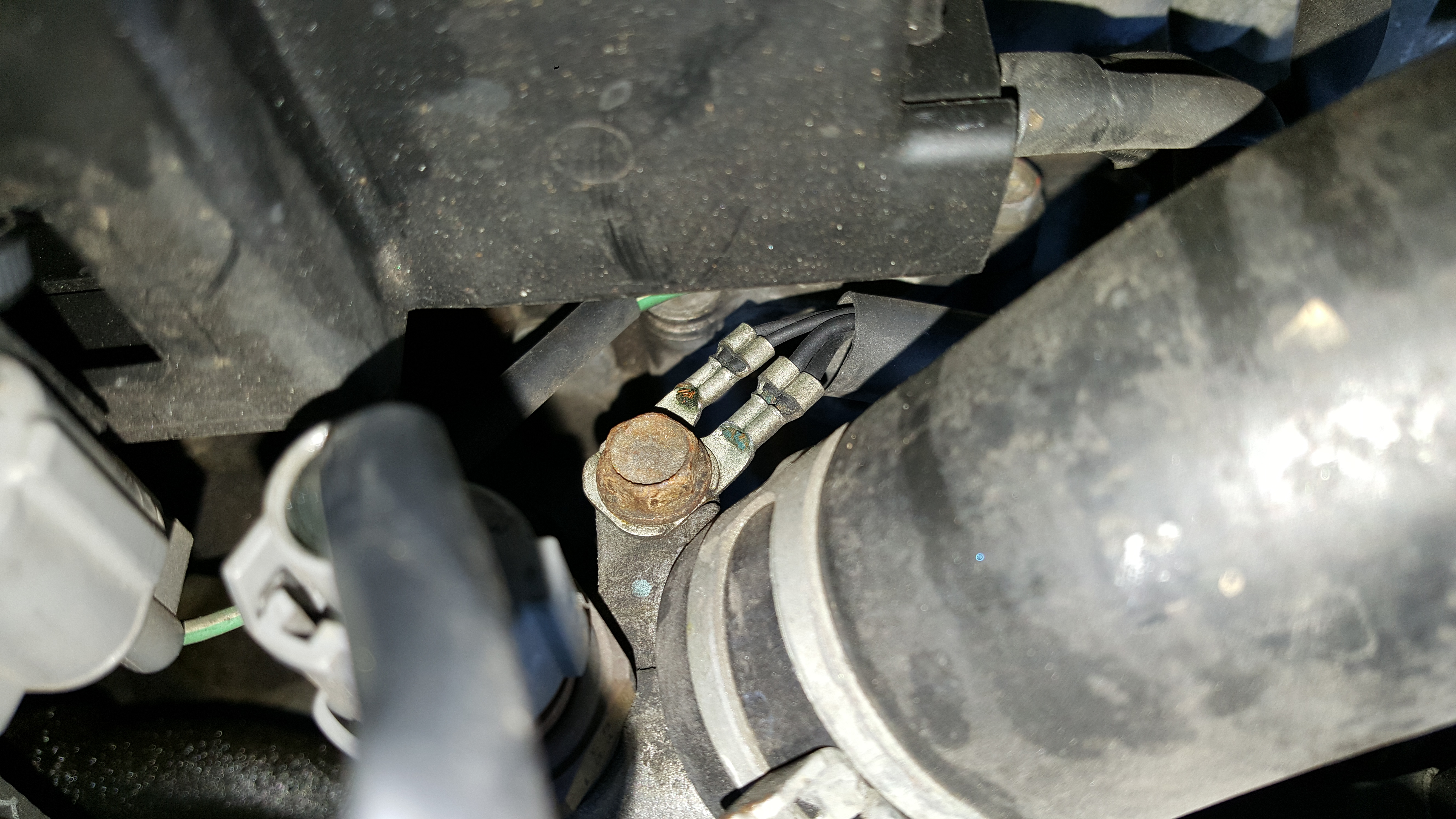

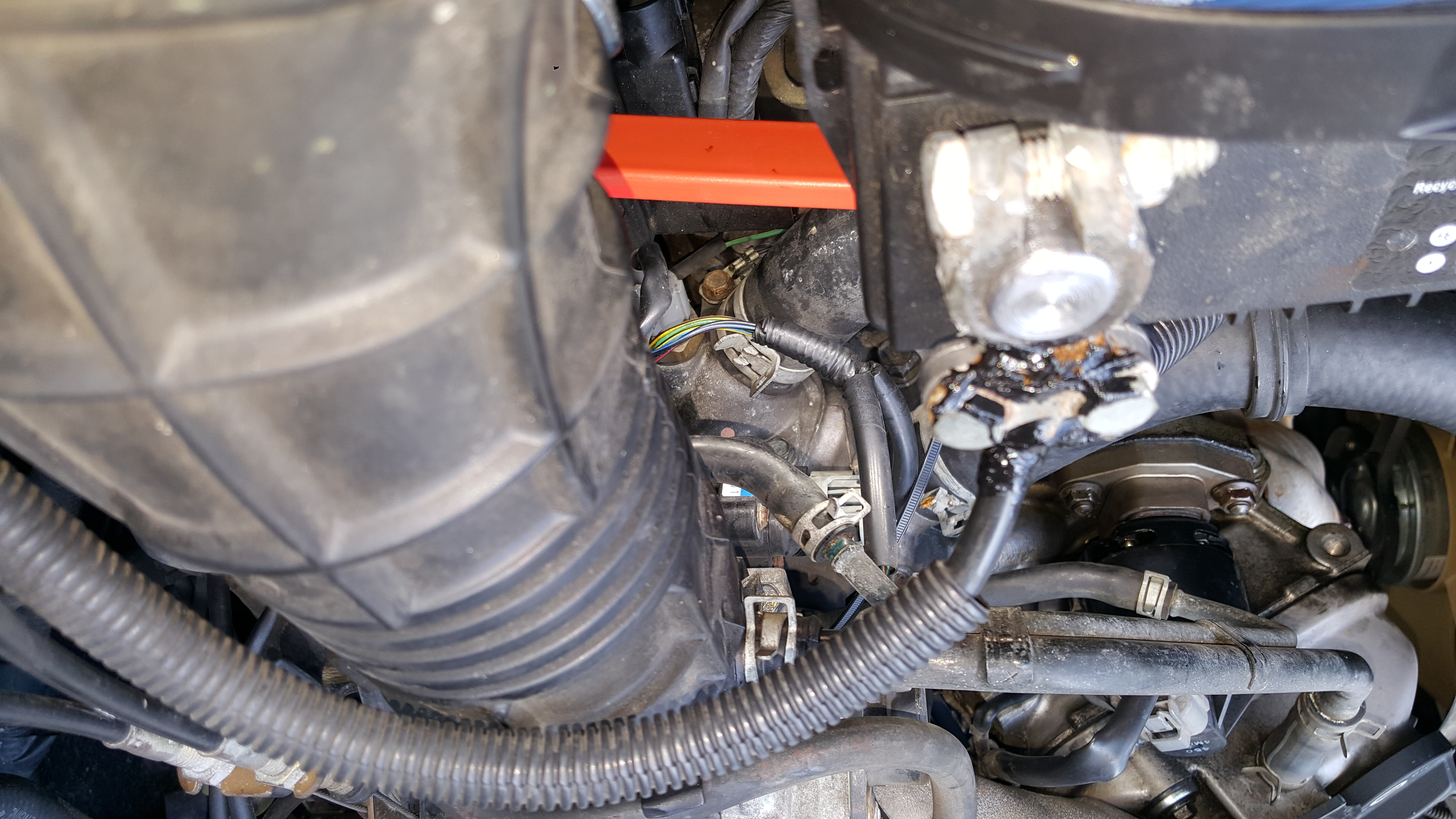

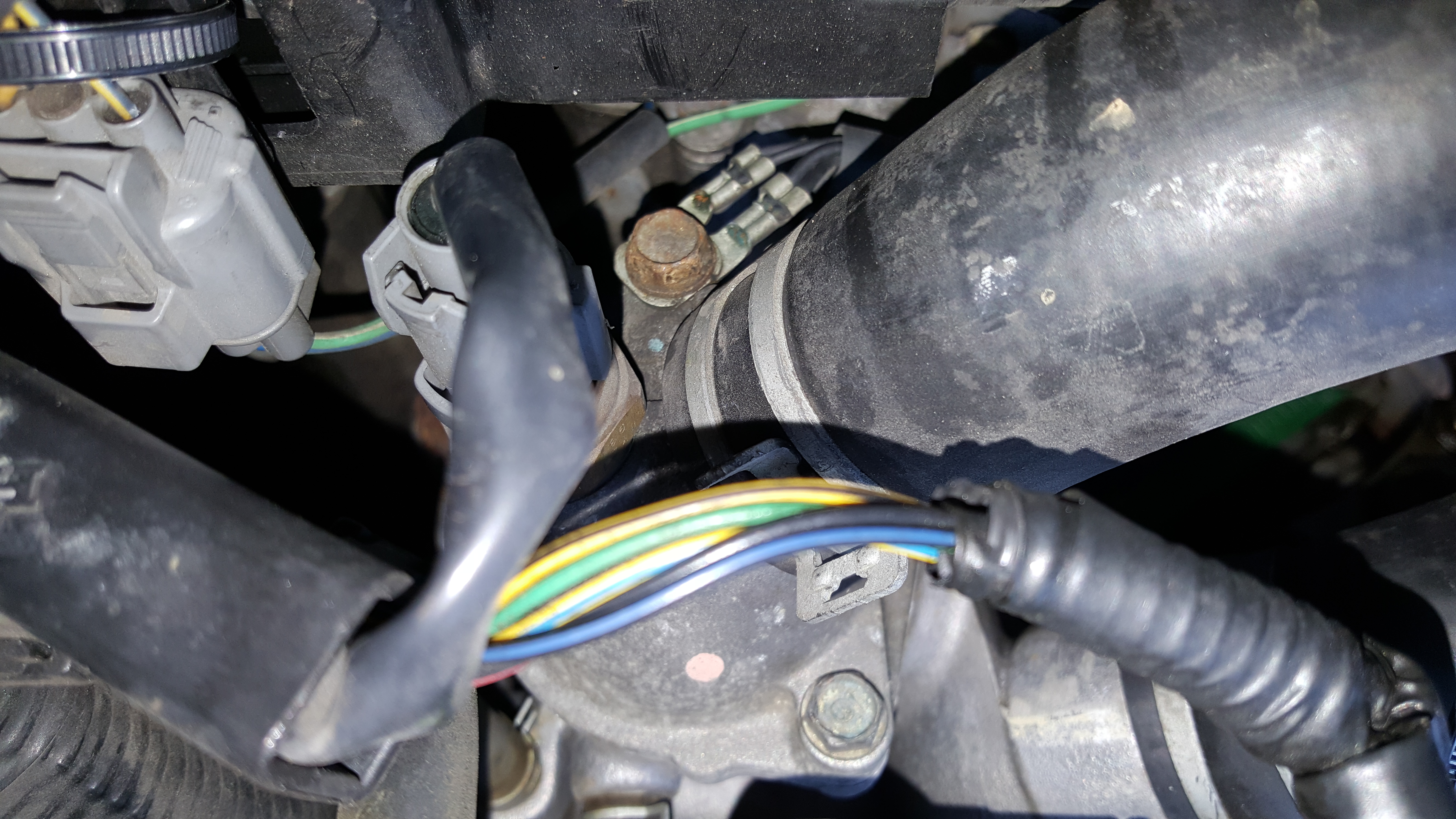

I finally got time to search some pics...yeah, it would be difficult to see if you didn't know where to look. It's under the radiator hoses at the engine block, below the throttle body. I found mine, and it was about 4 turns loose. It appears the egr valve is also grounded in there, which makes sense since I've had a stubborn egr code that comes and goes.
I was able to tighten it with my 10mm socket with an extension. Didn't have to remove anything to do it, but it is moderately obscure so there was a bit of finger-feeling to guide the wrench onto it. I'll know this afternoon if it solved all my problems. Thanks a ton poorman212!

I could barely see it. I did not take the time to pull it all the way off and clean the Rings really well. I wanted to make sure it was not going to give me more issues. This weekend, I plan on pulling it back off and cleaning the terminal rings along with some other maintenance items I will be doing.

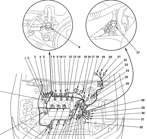

If you could I would love to see a pic of it, the one in the service manual for the v6 is very vague and hard to describe to someone so an actual pic would be nice

I got a few good pics. Now if i can figure out how to post them. Give me few.

Pictures...
Attached Thumbnails 99 Accord v6 Crazy ECM?-20170219_123855.jpg   99 Accord v6 Crazy ECM?-20170219_123728.jpg   99 Accord v6 Crazy ECM?-20170219_123653.jpg
