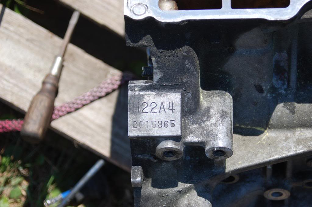

you can also tell the engine code stamp on the block...
h23 head flows better in stock forum than the f22. that and it also has the better intake manifold
here is a pic to show you where the engine code stamp is...its located to the left of your header where the engine and tranny just about meet
