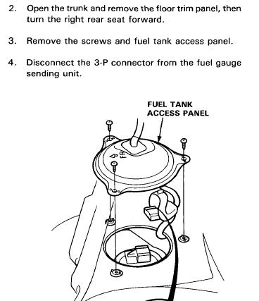

Sorry, slow. The gas tank is under the trunk floor....not the rear seat. Open the trunk, fold down the rear seat, pull the carpet into/on top of the rear seat.
You will be seeing a bare metal and the "fiber board" over the spare tire. On the right pass side of the trunk you should see a "panel" with some black glue/gum holding it down.....about directly below the right/pass side speaker in the rear deck lid.
Use a flat head screw driver and pry that panel up....bam, there is the top of the sending unit.

Yes, once the carpet and the panel is removed - either glued or three screws hold the panel - you will be able to see the top of the sending unit.
For mounts, aftermarket are fine. If you have an auto trans, I'd be sure the rear mount you get is the hydraulic/fluid filled mount.
