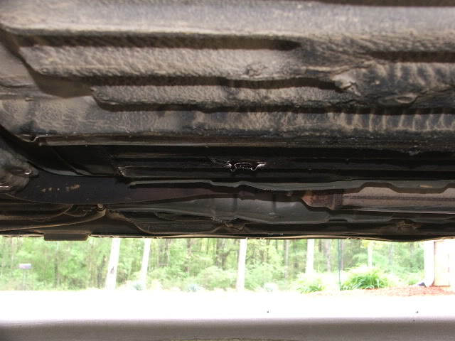

Well, I'm still waiting on the Honda Dealership by my house to get the parts. So, It wont be until Monday I get the parts. But anyways, I have been driving the Accord for the past week. Before I drive it, I checked to make sure it was full with water. Recently, I have been noticing it is leaking under the unibody where their is ahole underfloor board and mid section of the car on driver side of the car. What is that? (Drainage for the Heater Core/ Condenser Maybe?) Plus, the driver side motor mounts just got riped and need replaceing. Ugh..Never buya 15 year old car.

Well, I tooked the pic today. Now, It is coming from a new spot. Under the Passanger seat. Here it is..Any Help would be great full..

Old Mar 27, 2007 | 12:10 AM
Default RE: More Problems after Time Belt Change and etc..
Curious that it would be draining from that place. That's something like a plug in the middle of the floorpan. When they build the car they need to drain stuff out from the passenger compartment, so there's holes in the floor. The put rubber plugs in, then spray rubber undercoating all over.
Got a floor full of rainwater underneath the carpeting? Slowly dripping out from that hole? Maybe you should pull out that plug & let it drain. Better yet, take out the seats & carpeting & dry it out.
Then figure out how the water got in there in the first place.

Its a good amount that leaks out...So I will investigate some more...

does your interior smell like anti-freeze at all or just water? does the carpet feel "squishy" when you push it down like it's soaking wet? has it rained a lot recently?

Yes, but barely noticeable. The passanger side is more squishy, then the driver side. Both side Leaks..It has not rained recently..

Soggy underneath the carpeting, that would take months to dry out. So maybe it leaked in there a long time ago. Look for disconnected sunroof drains, missing plugs in the firewall, bad weatherstripping around the doors, anything like that??

This is due to the Cooling system of the Car. Since I still have to add a good bit a water...:P
