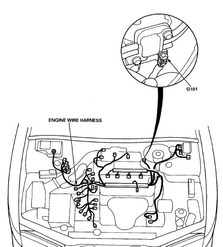

Check the ground on the end of the TB (drivers side)...this is the main ground for the ecu, if it is not on and secure the ECM will not fire the dist or injectors.....

Default what is TB ?
Poorman, what is the abbreviation TB ?
Stark

throttlebody
Old Jun 16, 2011 | 07:08 AM
See if this helps in finding it

Default issue resolved
Thanks to all replies, but especially thanks to Poorman !
The issue was indeed an improperly grounded computer. That and the distributor was 180 degrees out.
