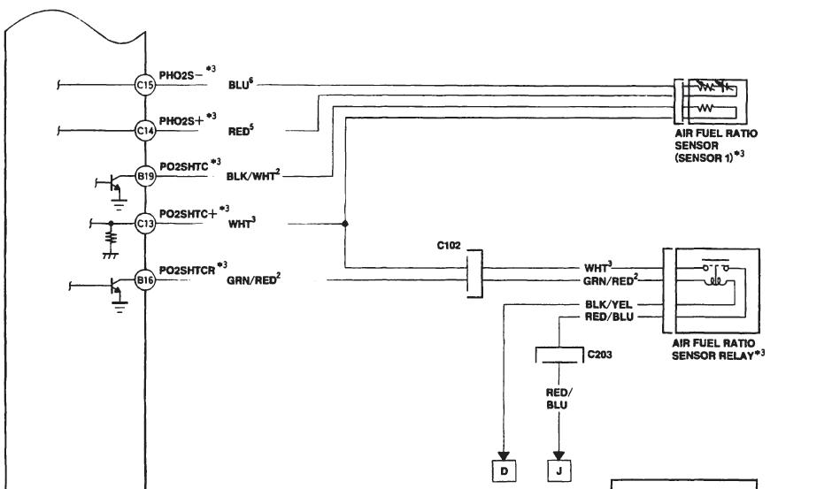

What emmision standard is this car? I looked at this the other day and the CA emmision cars do use a different type of O2....next on those there is a relay for the heater circuit.
Just want to understand everything as we go into testing. I think the A4 engines use the relay. I'm not trying to confuse things, just want to be sure we have all the details.

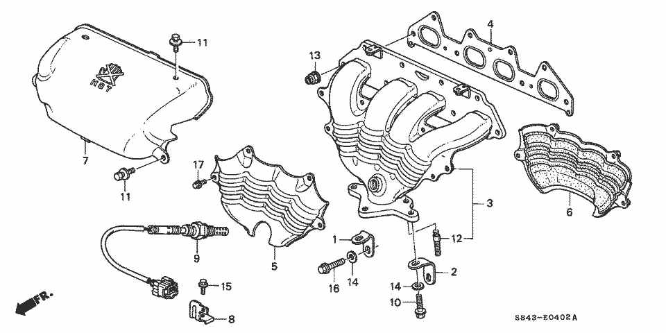

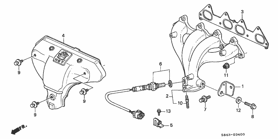

It's not necessarily California, the question is whether it has the ULEV engine.
F23A1 = VTEC
F23A4 = ULEV-VTEC
F23A5 = non-vtec
The exhaust manifold looks very different.
Attached Thumbnails stalling-1998-f23a1-exhaust-manifold.gif   stalling-1998-f23a4-exhaust-manifold.gif
