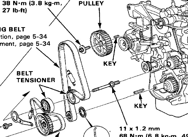

After the adjustment, start the engine. If belt action does not improve, unfortunately, as you well know by now, you have to investigate the arrangemnent of all componentsinsidethat lower cover.Here's the general seqential exploded view of the arrangemnet for the engine of a92:

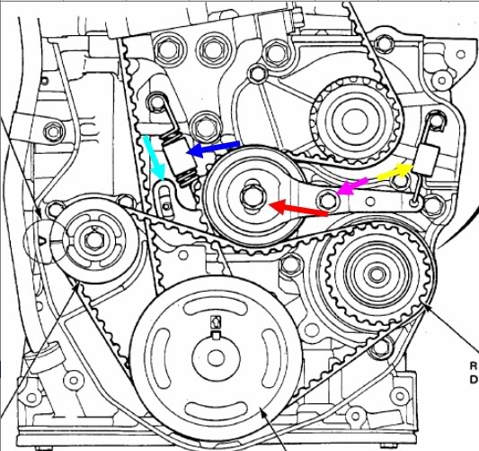

Here's a front view with the important components pointed out with colored arrows:
1. Make sure the timing belt tensioner adjuster arm (aqua arrow) is in its proper position and that the timing belt tensioner spring (navy arrow) is installed correctly, and the timing belt tensioner is free to move at will.
2. Make sure the balancer belt spring (yellow arrow) is installed in the correct location and that the tensioner's arm is free to rotate about its axle bolt (pink arrow).
3. Make sure the adjusting nut washer (red arrow) is installed against the balancer belt tensioner's flat metal central piece of steel, INSIDE the cover, BEFOREinstalling the lower cover and then installing the tension-adjuster nut.
4. Then adjust belt tension according to that procedure above.
