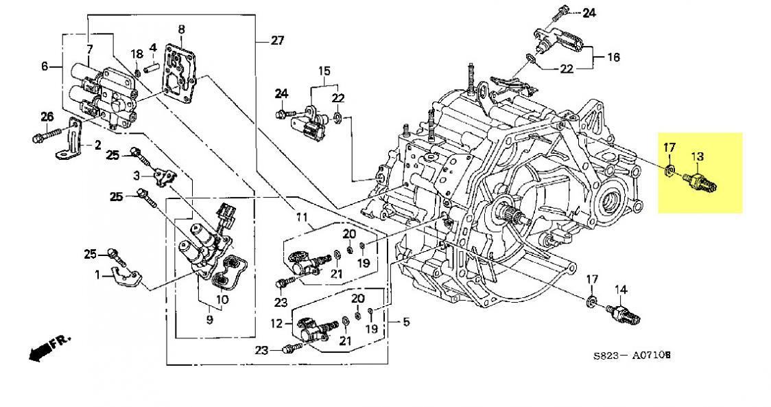

Is this the part which may need to be changed for the P1738 to go away, how can i confirm ?
28600-P6H-003 - Honda SWITCH ASSY., OIL PRESSURE
That should be the part based on the other links. If you want I'll double-check. It should be the same regardless for the different trims. However, let me know the following:

Here are the details
4 Cylinder
Sedan 4 doors
Automatic Transmission
No clue about Californica or non-california - If you can tell me how to get that info then i can tell you.
In the mean time for the P1456, should i do this...
1. Fit the Gas cap properly
2. Wait for 4-5 days and then go to Orilley and get the codes again and hope that P1456 is gone ?
Also if it does not go then first and foremost troubleshoot the P1738 and then the P1456 as the P1738 is probably on priority.
The above mentioned part is like 50-60 $. How much labor am i expecting on this and how to 100% confirm whether this part will resolve the issue ?
In short, what do i tell the next mechanic i meet ?

Honda part number 28600-P6H-003 looks to be the correct part. You cannot 100% confirm this part is the problem without probably paying someone to competently perform the diagnosis. Even at that, mechanics are not always correct. However, as shown in the links I provided previously, that part appears to be usually the culprit.
Attached Thumbnails [Car Amateur] Honda Accord EX 99..Check Engine light Came ON-ecu-back-up-fuse.jpg   [Car Amateur] Honda Accord EX 99..Check Engine light Came ON-oil-pressure-switch.jpg
