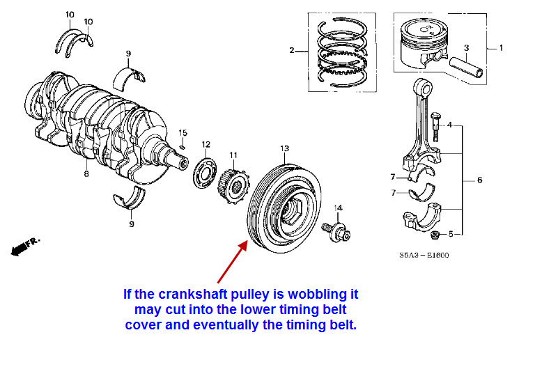

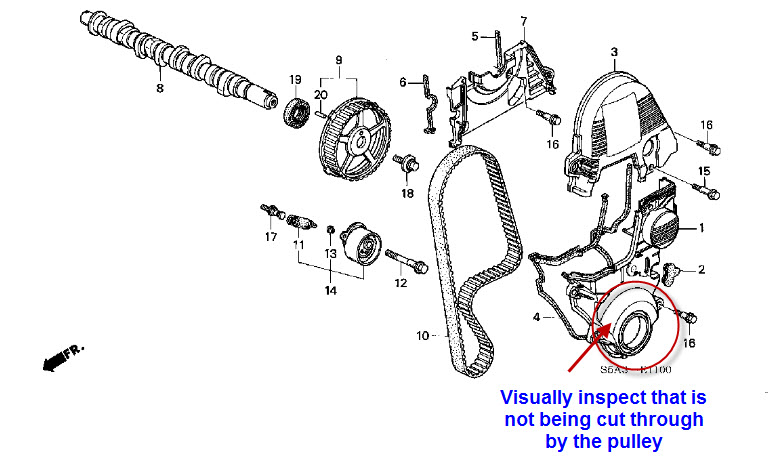

Visually inspect the lower timing belt cover to see if it is being cut through by the crankshaft pulley. If the crankshaft pulley wobbles, it may cut into the lower timing belt cover and eventually into the timing belt.
Attached Thumbnails 01 civic ex suddenly died..good spark-lower-timing-belt-cover.jpg   01 civic ex suddenly died..good spark-crankshaft-pulley.jpg
