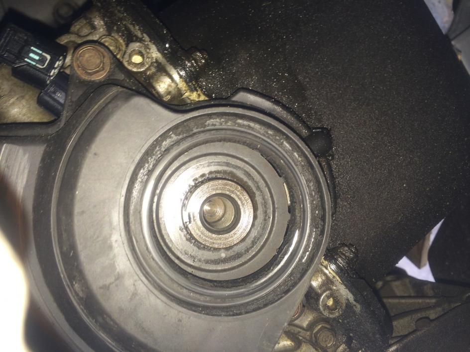

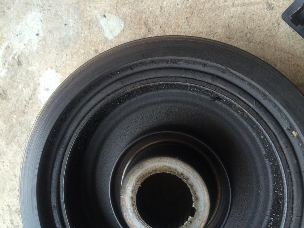

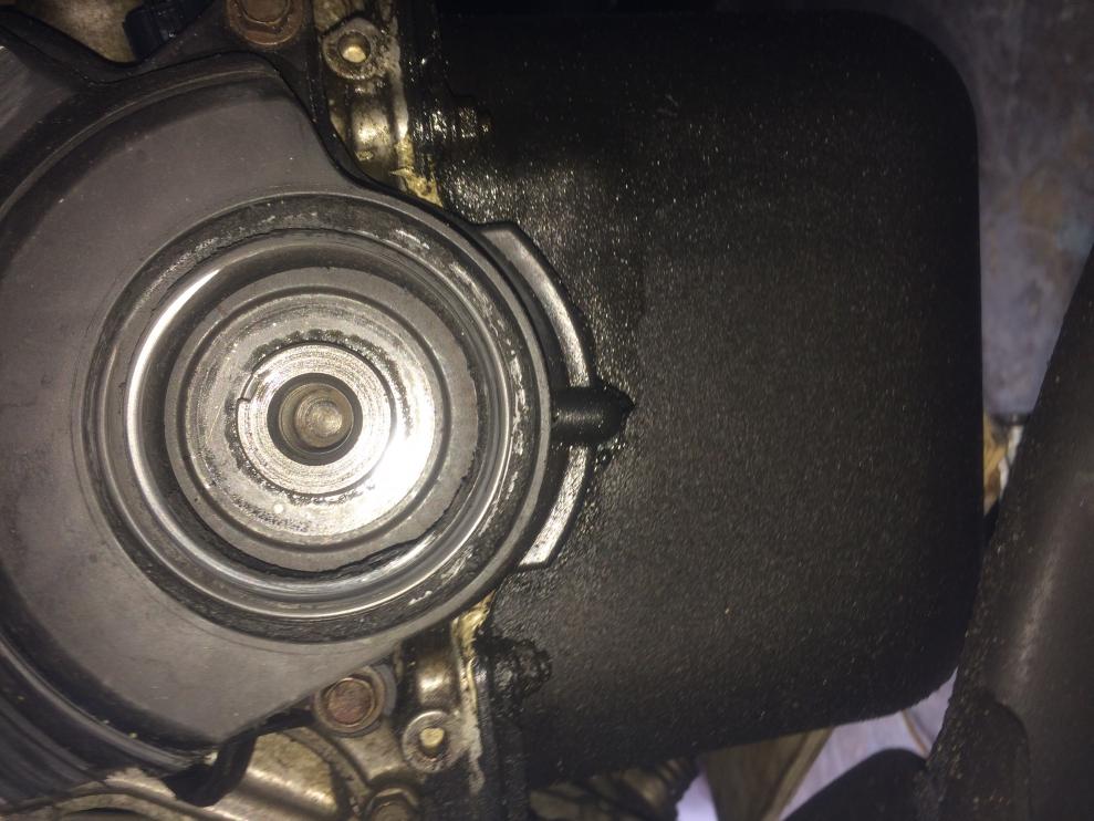

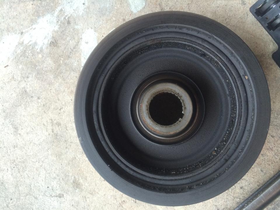

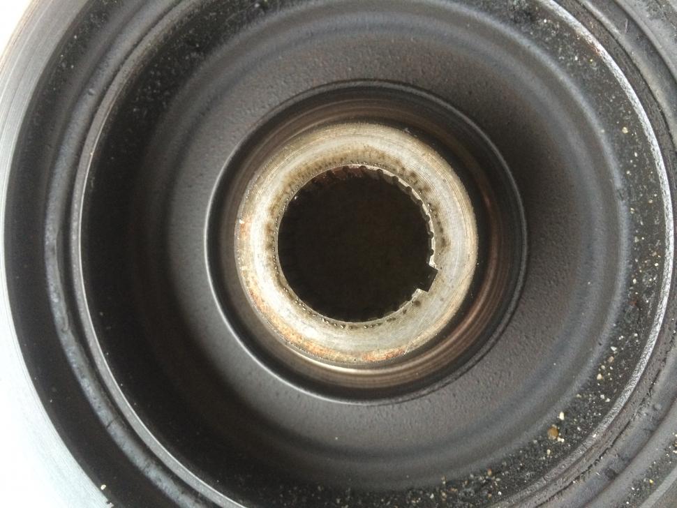

One of the strange thing we noticed while cracking crank pulley bolt is, it did not take much effort with a long steel pipe, it opened pretty easily. While in the past we had to literally dance on the pipe to crack the bolt. Does crank pulley bolt has anything to do with mechanical timing?
Please have a look on the attached crank pulley and let me know if you need any other pictures which can help troubleshoot?
If tensioner pictures would help, can take and upload them over the weekend?
