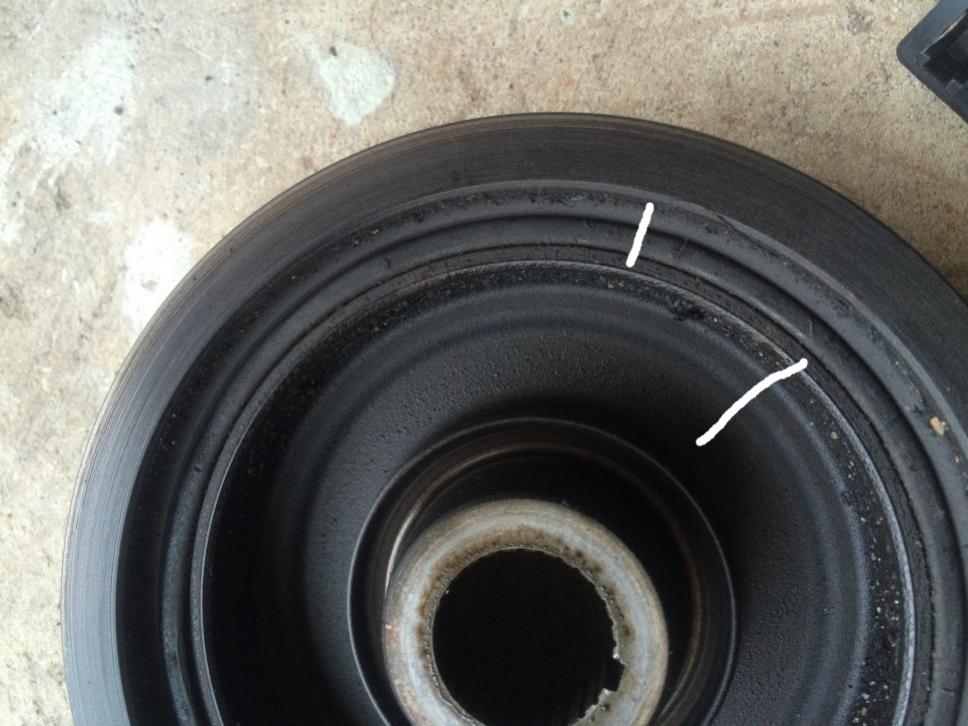

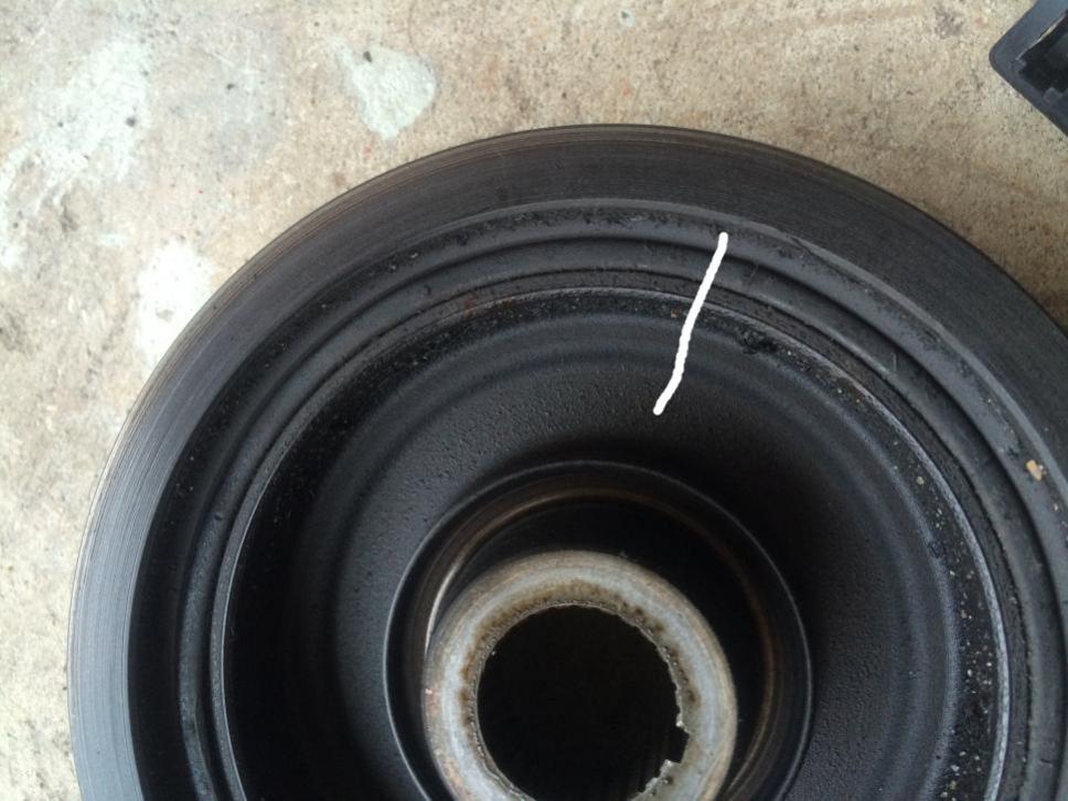

Default Crank pulley CAN mess up mechanical timing
Before you say the pulley cannot affect mechanical timing, you need to verify that your crank pulley is not slipping. You set mechanical timing by lining up notches on the outer rim of the pulley. Like I said, it's not very obvious, but there's a layer of hard rubber in there somewhere.
Clean up the pulley. Your photos show the inner face of the pulley, but you should mark the outer face, with some white paint or something like that. That way you can see the mark without removing the pulley.
The first marked-up photo shows how you should make a mark. After running the engine for a bit, check the mark. If it looks like the 2nd photo, then your pulley is slipping.
If you find that the pulley is slipping, then your mechanical timing is NOT REALLY changing. Only the outer rim of the pulley is shifting it's position.

Thanks so much JB, regarding about marking those notches with white layer, I would still have to close everything and then if crank pulley is going to change it's position then I will be doing the whole T/B process again, correct?

Mark the pulley, put it all back together, then drive around for a day. If you find the marks come apart like I showed, then you need to buy a new crankshaft pulley. When you install the new one, you'll have to look at the timing marks to determine whether you need to adjust the mechanical timing again, to get it back where it belongs.
