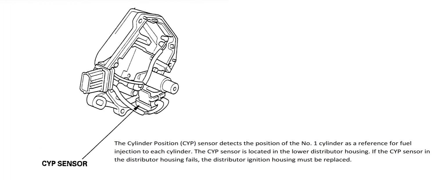

The cylinder position sensor (CYP sensor) is part of the distributor housing, if it turns out to be the CYP sensor, then the distributor housing needs to be replaced. The distributor housing is separately available without purchasing the whole distributor. See picture:
https://www.hondaaccordforum.com/for...cyp-sensor-jpg
Honda part number 30105-PAA-L01 is just the housing without the igniter, coil, and rotor (since you already purchased those). There are aftermarket housing available too.
