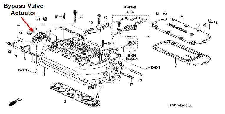

P1078 is the IMT Actuator. It's a bypass valve actuator, aka intake manifold tuning (IMT) actuator, or intake manifold runner control (IMRC).
I believe only the V6, coupe, manual transmission had this in your year. Usual suspects to check first are poor connection, loose terminal, or damaged to wiring. It may also be that the part needs replacement. Who knows, if the dealer does the software update for the ECU, it may take of this code too if it was some bug in the software.
The part is shown in the attached picture.
Attached Thumbnails 03 Accord throwing emissions codes, getting conflicting causes-imt-actuator.jpg
