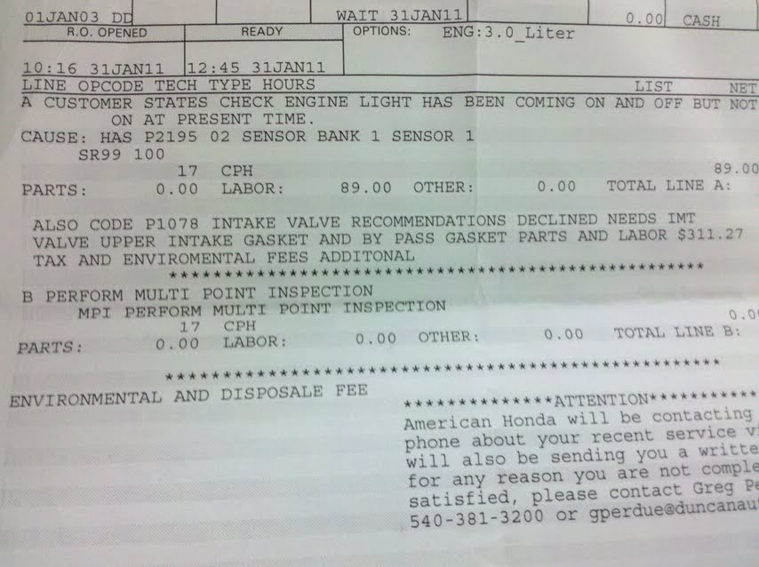

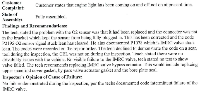

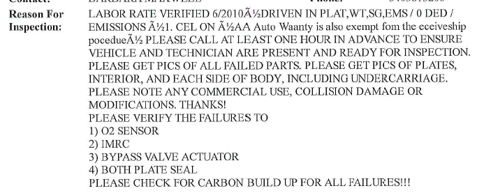

Here is the receipt from the dealership and the adjustor's report. Maybe you could explain what I need to replace?

Here is what I have gathered. The dealership fixed the O2 sensor by properly plugging it in.
The tech could not get the CEL to turn on when the adjuster was there. He also could not prove that the valve was bad. It reads like the tech did read the CEL code P1078 at some point, but not when adjuster was there.
The tech recommended that the IMRC valve bypass actuator be replaced. There are seals that would need to be replaced when you go to replace that part.
Has the CEL turned back on? How is the car driving?
I would call Honda of America. There is a TSB for the P1078 code. The tech noted the P1078 code, but did not follow the TSB. I think that Honda should have the dealership service department to the TSB fix.

I may be wrong; but, this is how I am seeing it. The regular factory service warranty (via Honda America) has expired. You purchased an extended warranty through a third party insurance company.
Since the regular warranty is over, the dealer does not want to perform a service which they may not get paid for (e.g., software update). When you paid for the diagnostic fee of $90, the dealer tech essentially divided the time for both trouble codes. The tech fixed the O2 sensor issue and believes the IMT actuator, gaskets, etc. need to be replaced. The third party insurance adjuster wants the dealership to prove the part was defective. The tech probably declined to conduct further diagnostic (e.g., more scan test, etc.), as they may not get paid for it.
